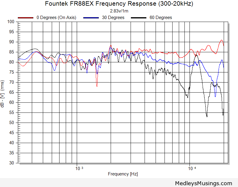

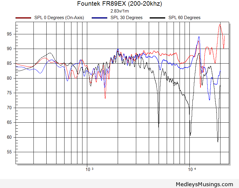

2 - Bigger x-max will again gain you bottom end potential. However, if I look at the FR curve from the FR89EX, personally I wouldn't use it in an array:
Source: http://medleysmusings.com/fountek-fr89ex/
The FR88EX seems better behaved in a direct comparison:
Source: http://medleysmusings.com/fountek-fr88ex/
You can fix lots of things with EQ/FIR, but in an array I'd start with a driver with the smoothest top end. You can't expect to fix a lot of ringing. The top end is already a challenge as the distance from driver to listener varies along the line. The top and bottom drivers will be further away than the middle (listening height) one. Choosing the TC9 wasn't a cost driven decision for me.

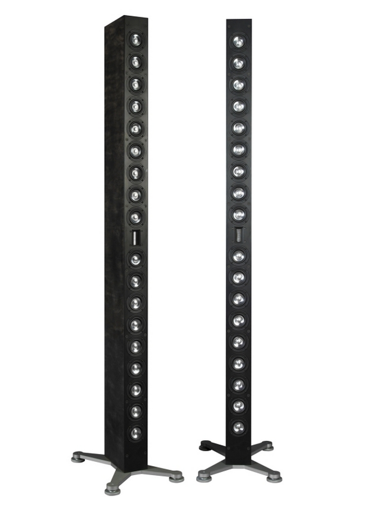

3 - Many have tried a single tweeter in an array. Due to the line behaviour acting differently from a point source tweeter you'd get an uneven response if you listen at a different distance than the design accounts for.
Yet Adyton seems to do well enough:

"The FR88EX seems better behaved in a direct comparison"
if you look at the same SPL scale, it does not...very similar
The graphs I posted should be comparable. I do trust their source. Erin has done many measurements and I followed him on diymobileaudio from around the time when he was in charge of the Klippel test equipment owned by that site, and later on when he got his own Klippel."The FR88EX seems better behaved in a direct comparison"
wesayso, dont have any measurement of the FR58EX or FE85? FE85 is really cheap (1/3 of 88EX) but as i say before xmax is really low :/
I was just mentioning that one is 30-100 dB full scale, other 50 to 100 dB...it would be great if they are both the same scale
Lol, must be me who got used just scanning the 80, 85 and 90 Db lines. That's all I look at to get the comparison I want to see. 🙂
