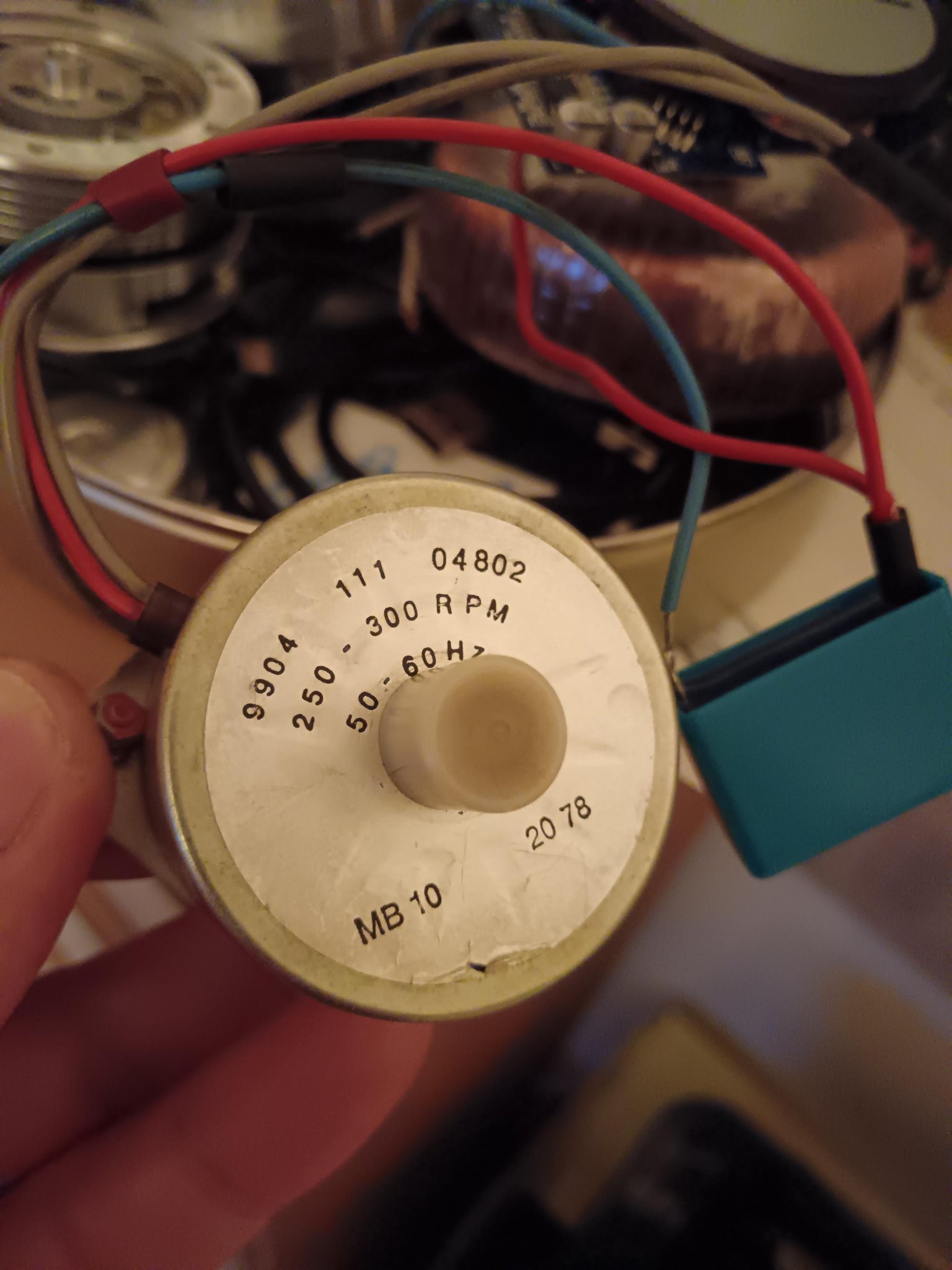

Hi @EC8010 , you are obviously knowledgeable of these motor variants, do you recognize this one ?
Except usual specs all I know is that it is from 1970's LP12

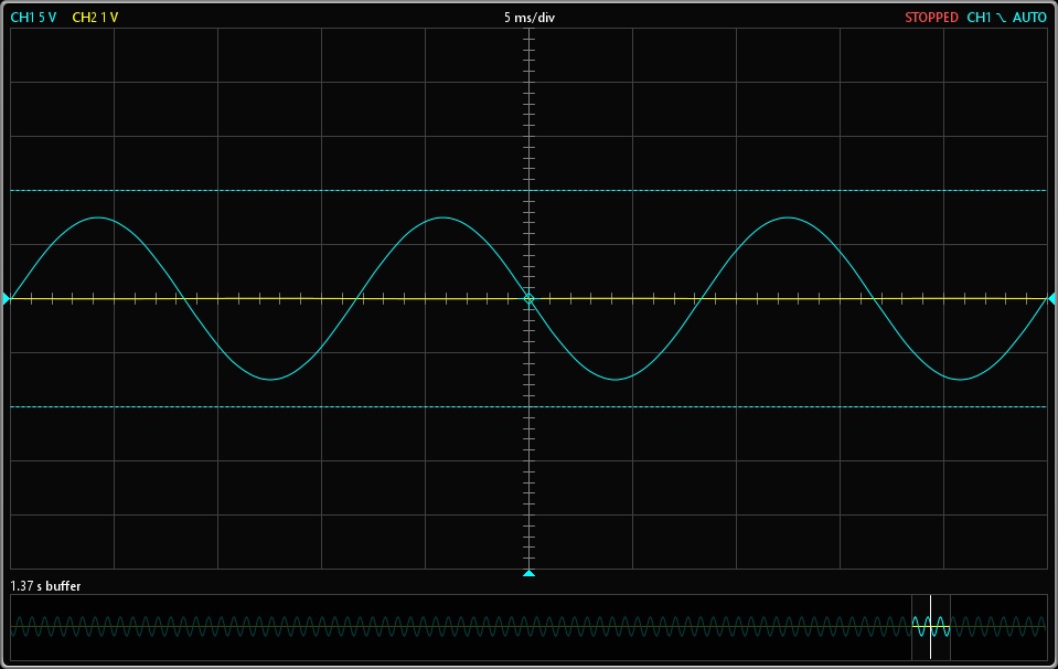

I'm trying to correlate speed, torque and current with equipment I have at hand , with purpose to understand effects better. Keeping in mind this is belt drive, not DD.
So, between power amps and motor I have installed 3 x 3R resistors. I did it for safety purposes while testing.
One input of soundcard (CH2) I took over resistor to measure current, other input is connected to voltage (CH1), both at the same phase.
Picture 1; voltage supply with motor disconnected, just for reference, clean sine V supply, one phase:

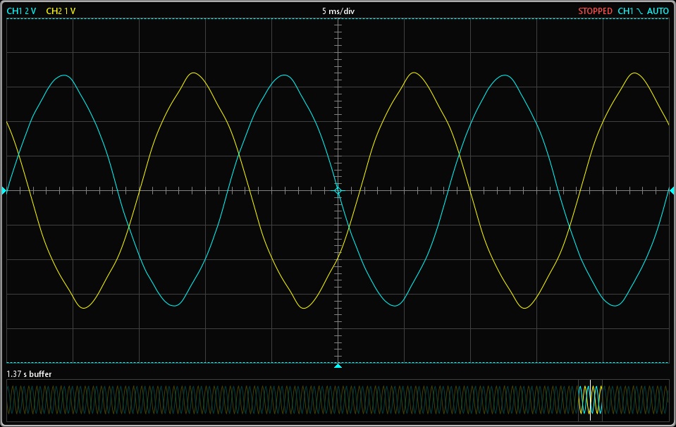

Picture 2: Voltage (blue) and current (yellow) platter spinning :
The sine wave is slightly deformed in V, and little bit more in I. Of course there is expected phase shift due reactive load.... I think V sine would stay pristine if there is no 3R resistor to allow current to modify V.

Now when typing, I got idea that I should have check the same without belt, just light motor... Could be my heavy platter is doing its job too good.... Back to basement...
So here it is: motor spinning alone, no belt on it:
More or less the same.
Interesting is also that current is less with load of platter, than without it.
Then I tried 45rpm spinning platter, here current dances bit more and current is reduced :
Here I can see little bit more current dancing left and right, is this speed - current oscillation you talk about?
Can you take anything out of this? Thanks in any case.
Hi EC8010, you are obviously knowledgeable of these motor variants, do you recognize this one ?
I've not seen one like that, but quite a few manufacturers discovered that a cap under the motor to lift the rotor was worthwhile. Surprisingly, few realised that what they were doing was equalising the drives of the two motor coils to the common shaft. From the motors I've seen, they were all derivatives of the Philips motor, which was intended for driving louvres in air handling systems...

I'm not sure where you are measuring current and voltage at the same time and where your ground references are connected. That may account for the large phase shift as well as distortion. Most of these motors have a power factor in the 90's so they appear as mostly resistive.
The lower current at 45 RPM is a result of the increase in back EMF most likely which increases with speed. It effectively raises the impedance of the motor windings. If you keep increasing speed without raising the voltage, the current will eventually drop so low the motor will stall.

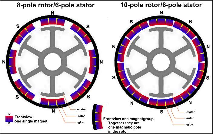

Hi, If I'm not mistaken (and recently I often are 🙁) you are talking old fashion synchronous motor with equal stator and rotor poles?
I took first picture of BLDC from internet, stator and rotor poles are not equal (and not multiplied by 2), all rotor poles and the field are never aligned, and rotor is much slower than rotating field (more rotor magnet fields, slower).
If not removing the issue, I think unequal pole numbers in contemporary BLDC will reduce it a lot. In below picture, top and bottom poles are aligned, rest is somewhere inbetween

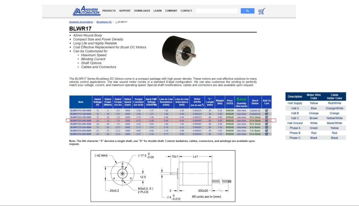

I had occasion to replace the motor in an Oracle turntable and finally settled upon an Anaheim Automation 8-pole BLDC motor and a Maxon DEC 50/5 1-Q-EC controller module. The Maxon controller accepts a DC signal that sets the RPM, so the only other components required are a precision DC source and a DC supply to power the Maxon module. The motor exhibits a slight cogging, but with a bit of isolation (Sorbathane worked for me) motor noise can be reduced to inaudibility.
  • Maxon_DEC.pdf
    Maxon_DEC.pdf

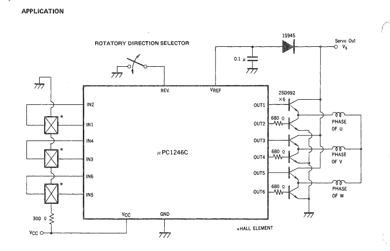

Intrigued by discussions here, today I took bit different approach, I was wondering how was Sony motor (No4 in post #50, inside picture post #118, and back EMF in post #130) that Pyramid also recommended as good candidate is doing with original onboard drive. So supaspin sinewave generator on side for this test.
Pre-driver chip datasheet helped to reveal circuit diagram, it is actually exactly as in datasheet.
3 hall sensors are driving analog predriver which is driving 3 transistor bridges. Speed is controlled analogously by DC supplied to transistors and Vref of the chip. As simple as this:
I connected 12 VDC to VCC as chip specifies and adjusted Vs (Servo out) DC to 3VDC to achieve desirable speed of about 400 RPM.
Like this motor shows some vibrations but very little, similar as I tested it earlier with pure sine directly to coils without original electronics. Nothing special.
However the torque is much less like this, with sine wave drive it was much higher.
Then I checked running voltage directly between one coil and gnd, well 1.4something VRMS...... earlier with sinevave I run it at 2.5 - 3 VRMS, here is explanation for the torque.

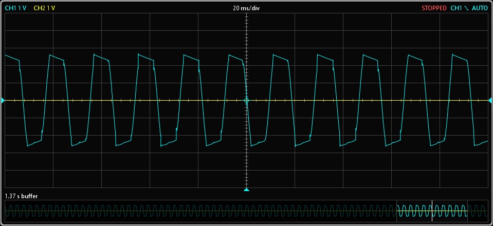

Finally, wanted to see how this original drive wave form looks like; this is probe connected between gnd and one phase of the motor:
Ouch, not very pretty. However it does resemble its EMF that I shoved in post #130 , at least approximately.
Now when I learned that in first tests I run this motor with 70 to 100% too high V, I connected it back to sinewe generator, this time adjusted for 1.4 VRMS, and whoah, now it is vibration less as preferred Phillips and as quiet as ball bearings allow. However now it has much less torque than Phillips, even that torque is enough to start and run the platter, but no DJ-ing around with it. Still, it can be used for TT, and so far its confirmed that pure sinevawe drive helps reducing vibration for motors that have close to sine back EMF

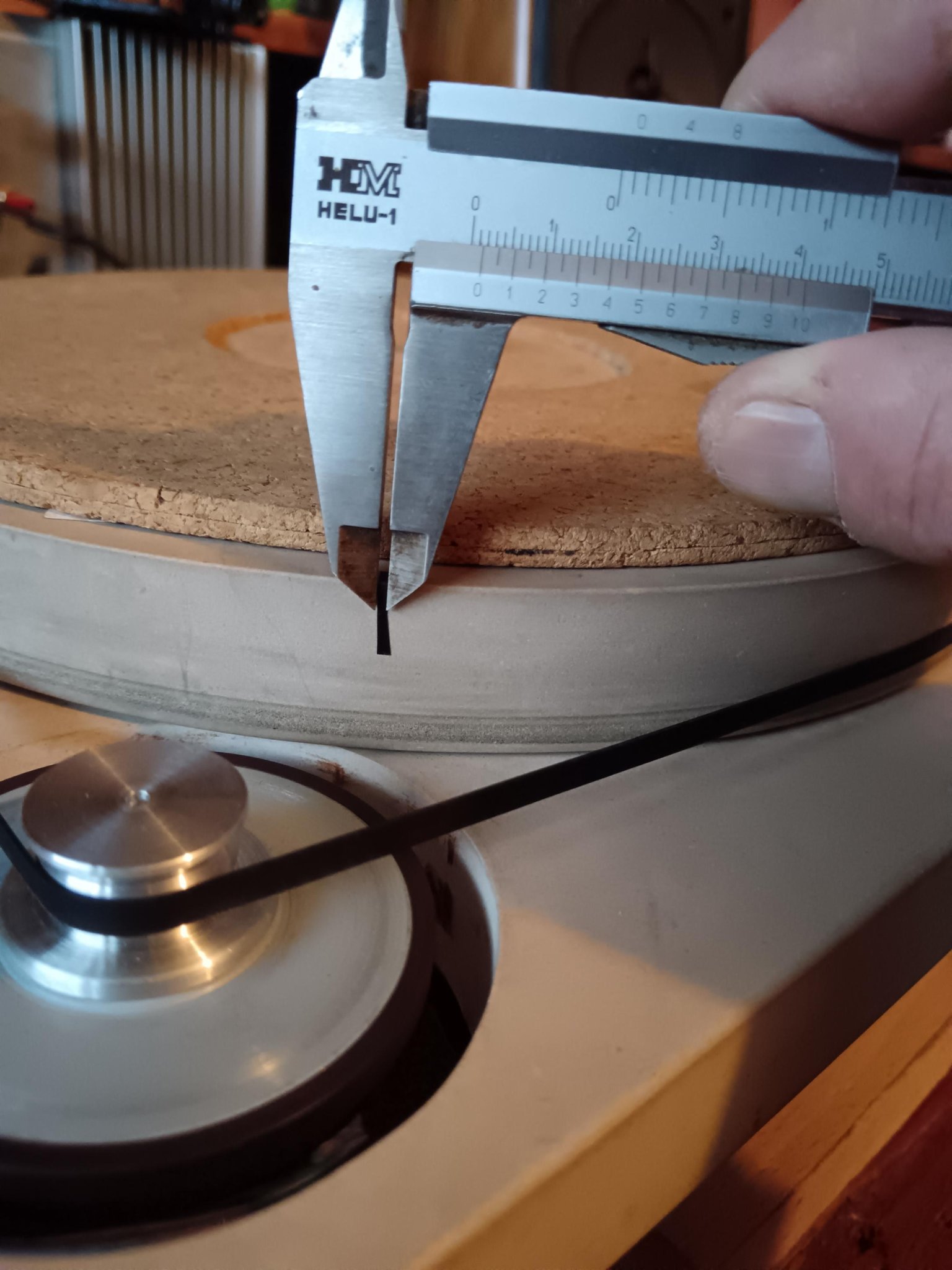

In posts #95 to #101 we (Tuberadio and EC8010) discussed optical reflective sensor to be used as kind of amateur shaft encoder. In particular I use CNY70. I said that I don't know how small can "dark" pach be for sensor to pick it up repeatably, now i tested it.
So, with CNY70 attached as close as possible to platter rim, I managed to get smallest possible "black patch" of about 1,5 mm , and speed reading still works robustly. At this level its sensitive to ambient light, result is with shadow above sensor:
Since we also need a "white spot" , whole patch is 3mm wide.
My idea was to engrave (or print + glue) stroboscope paper looking ring at the bottom of the platter, with CNY70 looking at it, precisely glued inside of the plinth. Distance between sensor and strobe lines would be less than 500um and since its below platter, its in shadow from ambient light,
Given max platter D of about 300mm, if this is installed beneath platter at say 280 mm diameter, we can get max 360 PPR (one degree resolution) which @ 33,33333 RPM gives 200Hz signal. To be safe probably 180 lines would be better, giving typical 50hz strobe pattern and 100Hz output.
I think this can be printed and glued.... Still need to calculate best printer DPI to see how will it integrate. Printer dpi are xy oriented, and this is angle oriented precision needed...
