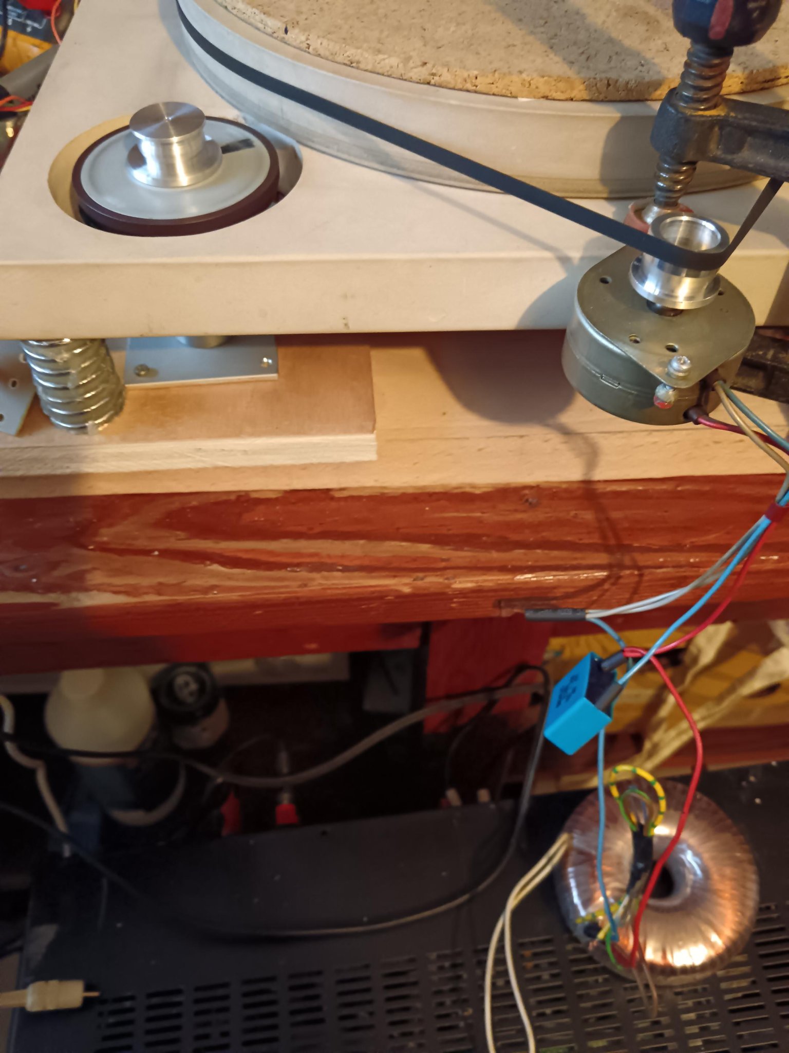

Today I run few more of the last tests before starting to finally assembly the TT.
Motor is equipped with new pulley and assembled on the mounting, I run one more speed variation test by playing 1kHz test signals from ortofon test record and capturing signal "dance" in RTA window of REW.
Same is done in post # 62 earlier, but then with stock plastic V-shaped pulley and o-ring belt.
This is new capture:
I got 8.4 Hz dancing window, or +-0.42% , might be slightly better but almost the same as earlier. Could be if someone is doing this that stock plastic pulley can be kept and TT run with O-ring, saving machining cost and probably very little difference.
Then I connected original Linn Sondek motor with its original pulley. Since this is 110V motor and I don't have such amp (did not want to bother with trafos now) , I run it from mains 50Hz + capacitor as originally intended. Speed is reduced to almost half in my set up now (Sondek is run against much smaller sub platter) , 1kHz becomes 540Hz at test record. For speed oscillation testing quite not relevant.
With same method of measurement, speed oscillation window was 5 Hz, or +- 0.463 % (base F is 540Hz, not 1kHz any more).

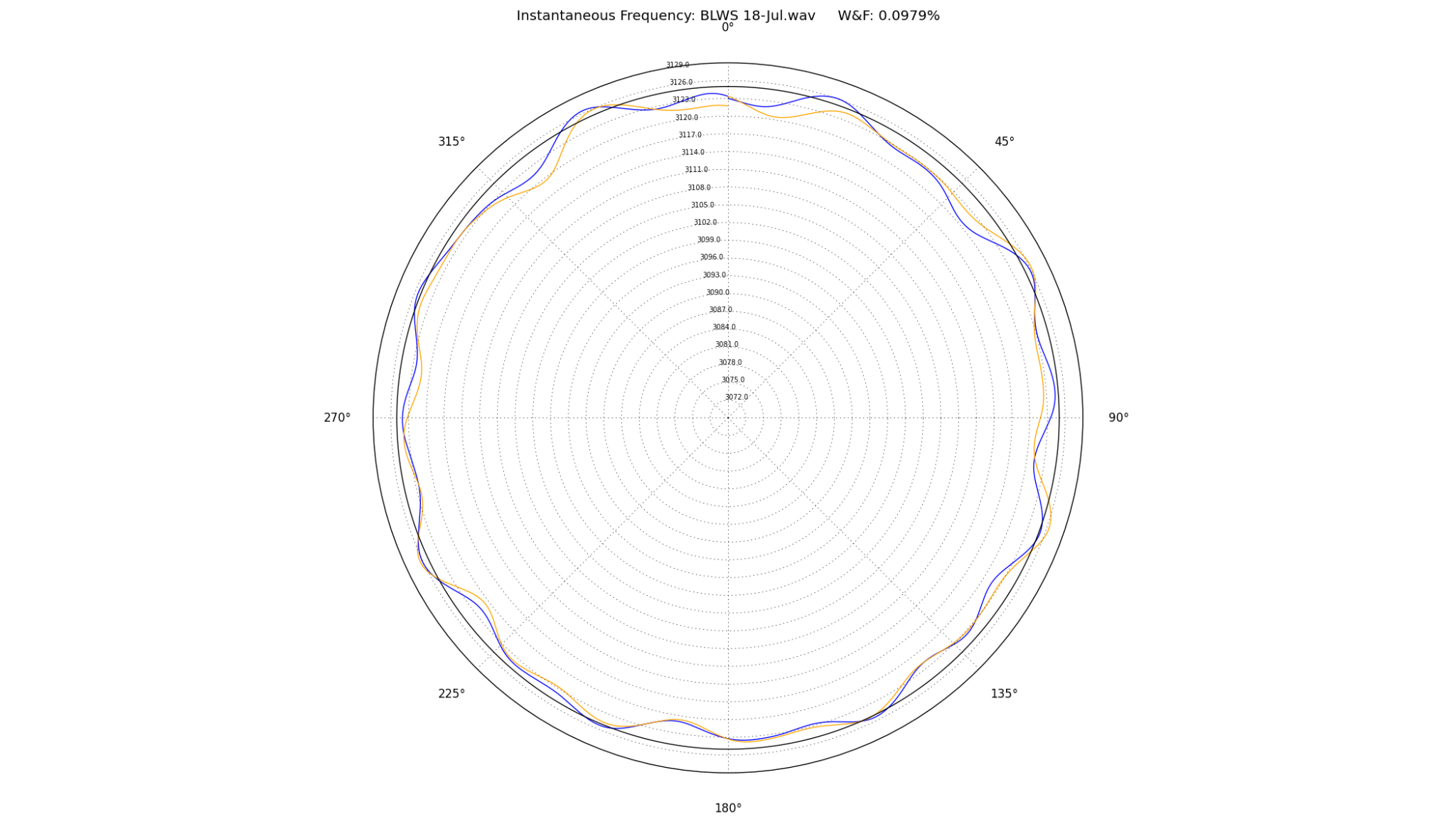

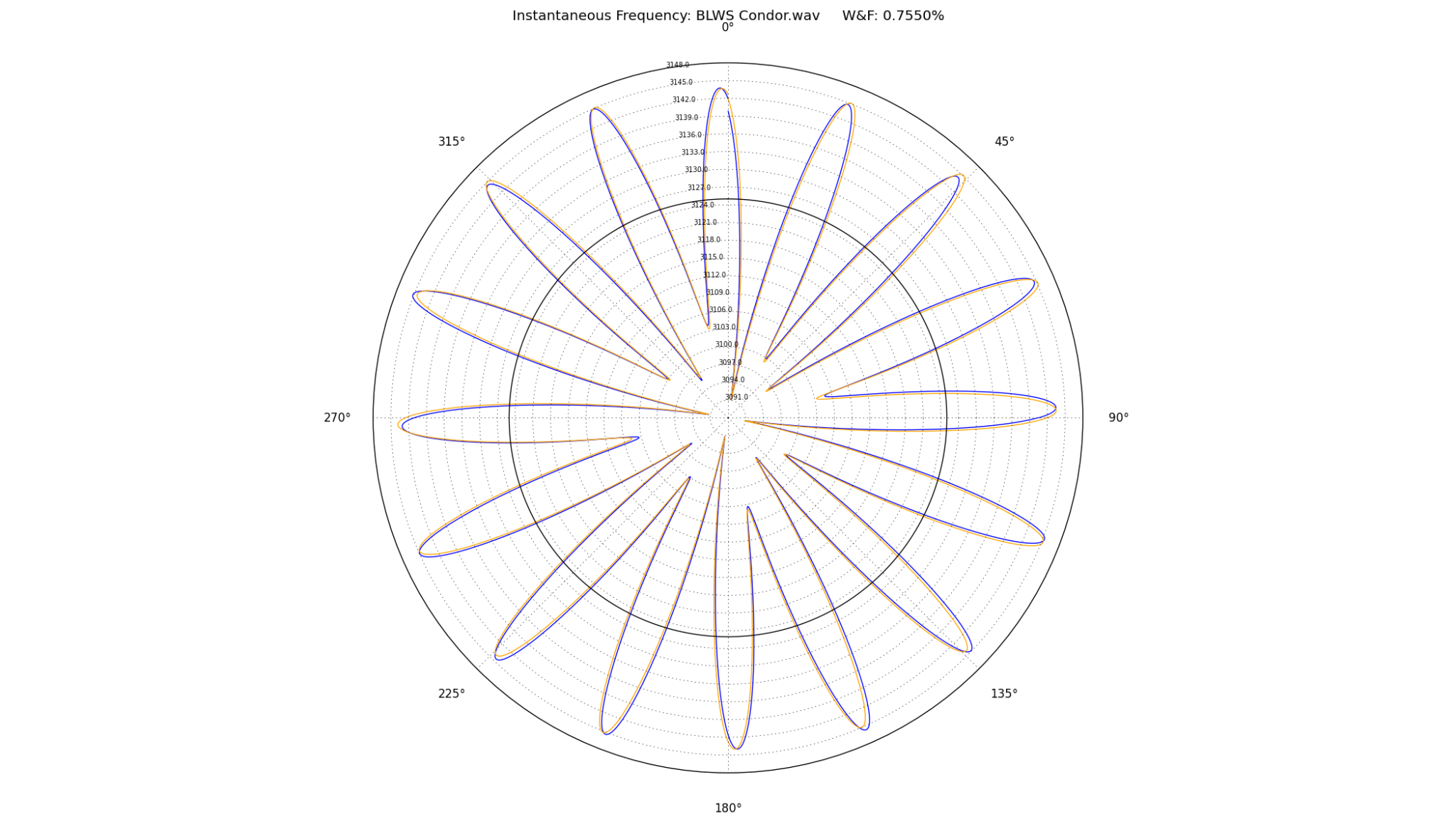

Almost any BLDC motor will oscillate in speed when driven as an AC synch motor; it will average out to the center speed, but always be a little fast, then just a little slower. Driving them as a DC motor with closed loop feedback will reduce or eliminate the oscillation, but those controllers can be very complex and require the use of a DSP chip.
This is a polar plot taken from a 2500 PPR optical encoder connected directly to the shaft of a BLWS series BLDC motor from Anaheim Automation. It is being run open loop as an AC synch motor driven by a 3 phase sine wave drive:
The black circle at 3125Hz is the center frequency but you can see significant speed oscillations; the frequency of the oscillations is 40Hz which a compliant belt to the platter will smooth out almost completely.
This is a plot of the same motor run as a DC motor using closed loop feedback and a DSP with Field Oriented Control:
Almost an 18db improvement. The time scale on both of these is 400mS for 360° of chart (each rev of the motor=90° on the chart or 100mS/rev=600 RPM). At 600 RPM (10 Revs/sec) the 2500 PPR encoder produces 25kHz so the output of the encoder is run through a divide by 8 counter to get 3125Hz.

Hello,Almost any BLDC motor will oscillate in speed when driven as an AC synch motor; it will average out to the center speed, but always be a little fast, then just a little slower. Driving them as a DC motor with closed loop feedback will reduce or eliminate the oscillation, but those controllers can be very complex and require the use of a DSP chip.
Thanks for this. I understand plots clearly but missing what motor (and its configuration) was used. Do you have complete paper to share.

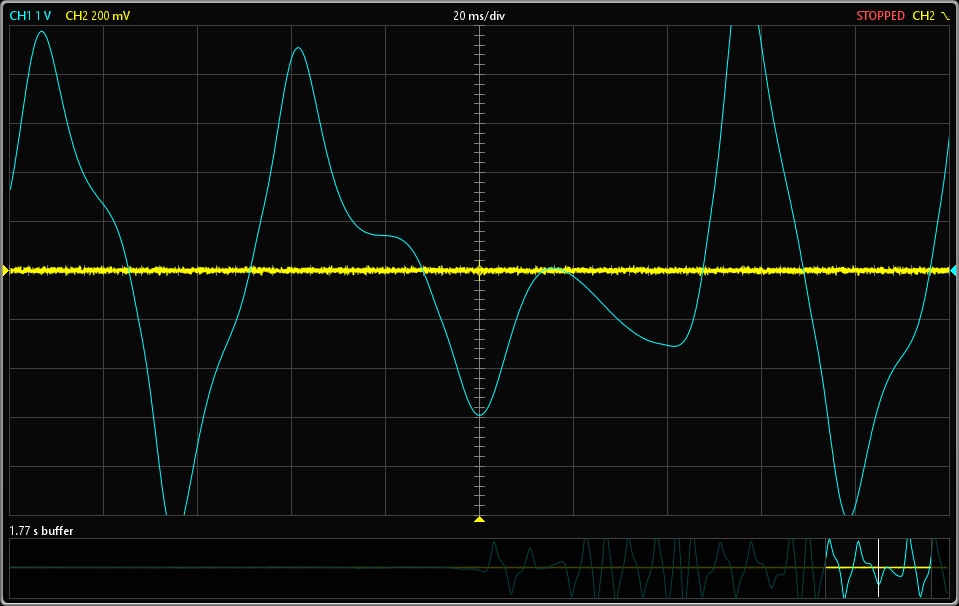

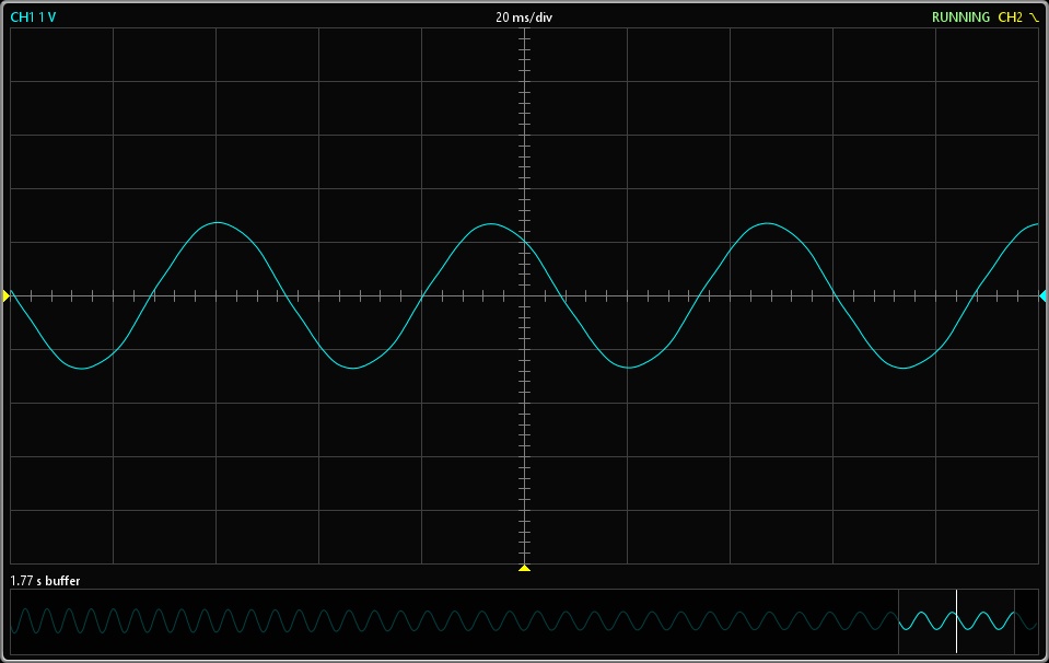

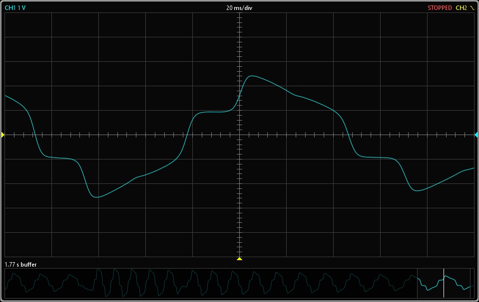

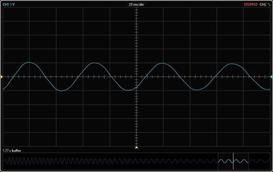

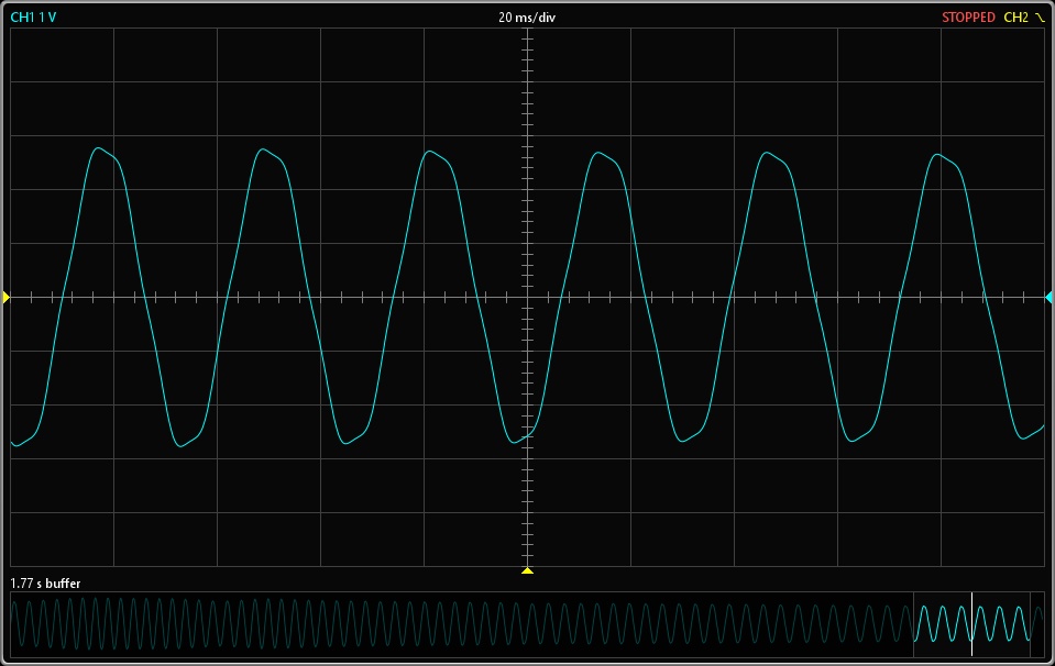

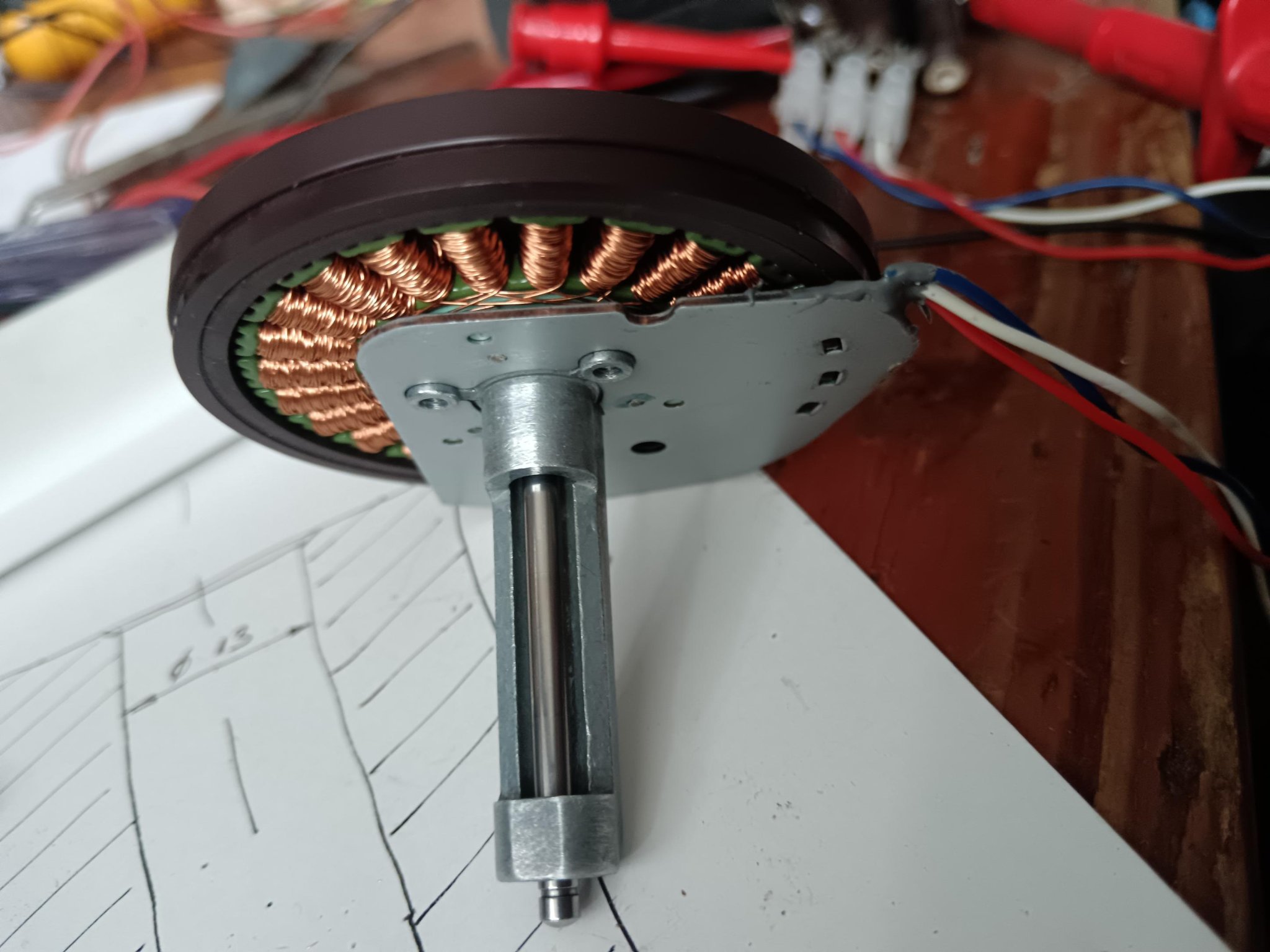

So what I did is connected 2 phases of several motors to soundcard inputs , switch on oscilloscope and watched back EMF shape, or what is this motor doing as a generator.
- In brackets i put ref No of motor from post #50
- Don't bother wave widths as it is turned by hand, look at the shape as this is what matters
(No1) smooth running and as so far favorite:
(No 3) drumhead motor, also smooth running
(No4) Sony HDVRC capstan, almost smooth running:
(No 5) Modern Papst outrunner, vibrating like hell:
For fun, I also recorded one stepper that I had at hand:
Looking at pictures above, there is very strong correlation between vibrations produced and level of matching generated and driving signal (all were driven with pure sinevavews).
Motors that do not generate sinewave vibrate horribly when driven by sinewave, seems to be clue....

The motor in the plots was an Anaheim Automation BLWS231D-24V-2000 24V BLDC motor rated at 2000 RPM. When held in hand, it appears to run very smoothly because the oscillations are small and symmetrical about the center speed, still some vibration can be felt. I also assumed that an AC synch motor would operate at the speed determined by by driving frequency, but if the current is even slightly higher for the torque needed for the load, the motor will accelerate to a higher speed before the magnetic attraction of the rotor to the field pulls it back into synch. This is why AC synch motors oscillate; the average speed is very accurate, but the instantaneous speed is not. My thought was to run a direct drive motor as an AC synch motor which should have perfect speed, but when I did that at 33 RPM, the motor (platter) oscillated terribly for several minutes before settling down. For a belt drive at 600 RPM if the current is matched to the torque requirement, then the oscillations will be small and a belt drive will mitigate the vibration caused by this oscillation. On a direct drive, the only way I found to manage the speed accurately and consistently was to drive it as a DC motor with closed loop feedback. The DSP solution that I used on the SOTA DD uses two nested PI control loops. The inner loop is a constant current (torque) loop that uses FOC to convert the 3 sinewave currents to a single constant (DC) vector that is directly proportional to torque so it is essentially a DC servo for a constant torque PI control loop with very high bandwidth. The reference current term (torque) for the inner control loop is the output from the outer loop which is a PI velocity control loop that monitors the speed of the platter via a 360K counter/rev optical encoder. The filtered error output of this loop becomes the reference for the inner torque control loop so it maintains constant torque at just the level it needs to produce 33.333 RPM. The results are very low W&F (0.004%) as shown on the plot taken directly from the optical encoder:

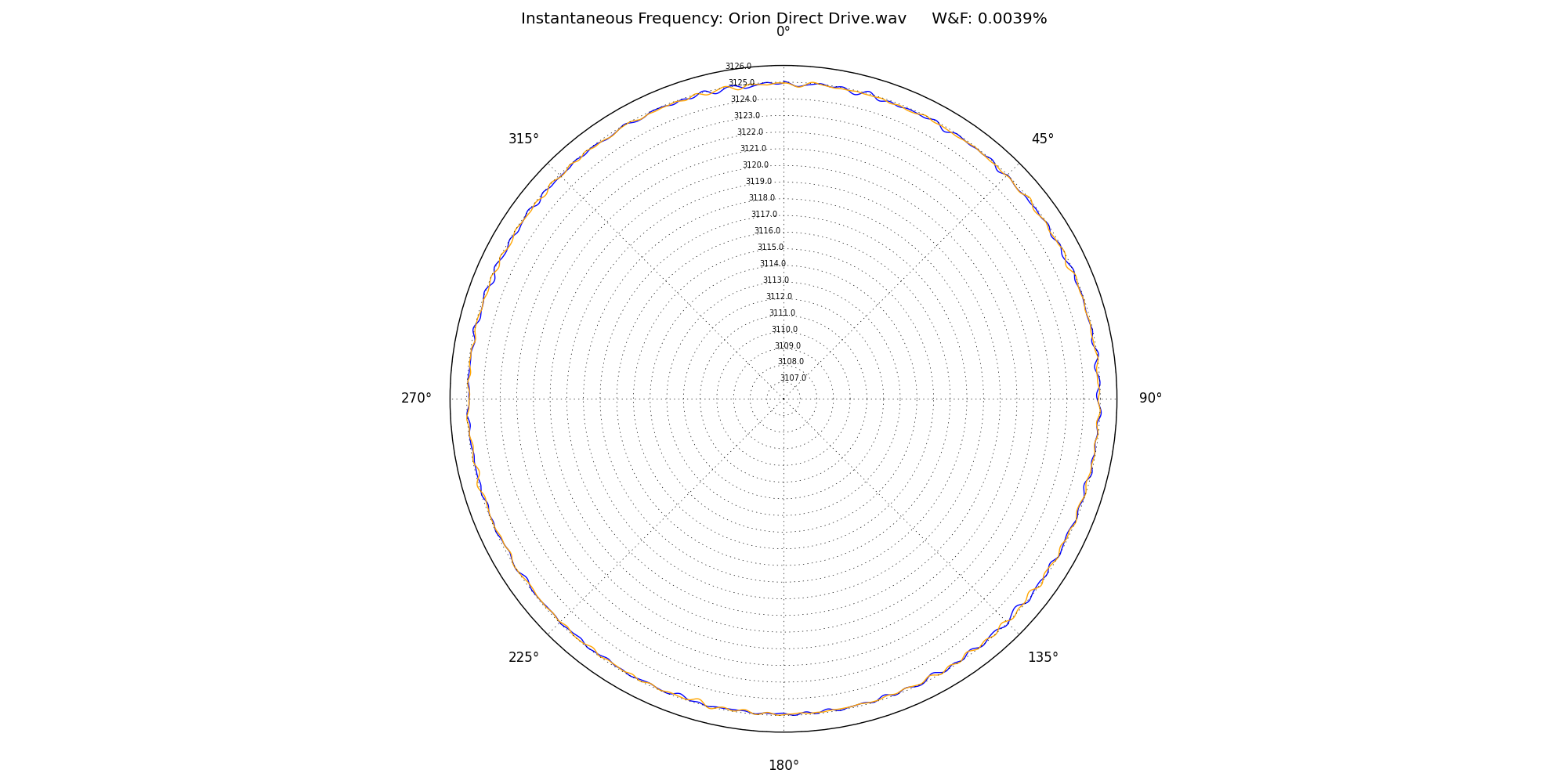

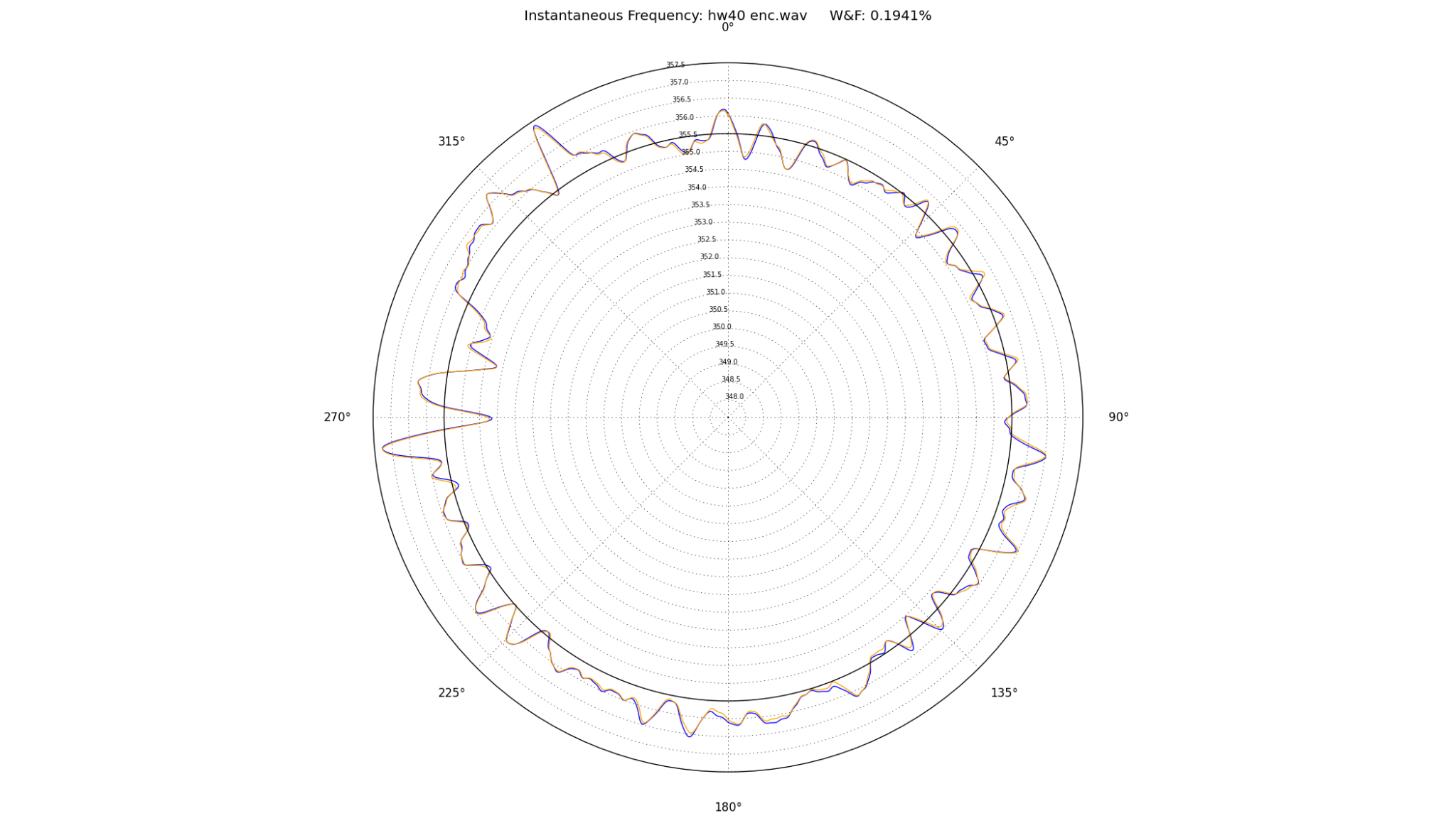

Compare with the VPI HW40 DD (the signal again taken directly from the magnetic encoder at 355.5 Hz):
This is the spectrum of the SOTA Orioin encoder signal:
And the spectrum of the VPI HW40 encoder:

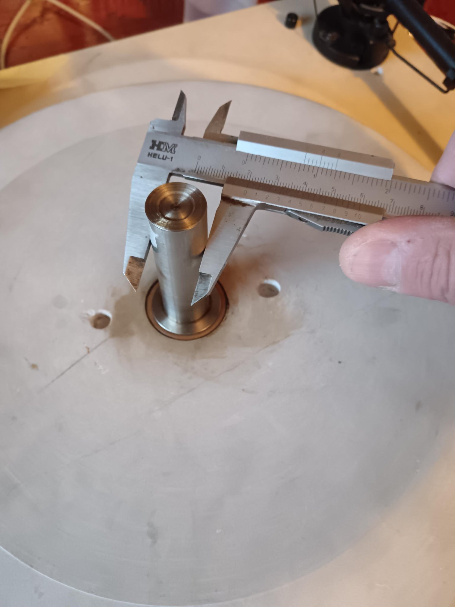

My solution for this issue (without knowing the actual root cause) was to make main bearing with a drag (I mentioned it few times in this thread) and give to motor a constant resistance to work against.
At the time I was designing this TT I was reading about then actual Bauer audio DSP TT https://www.stereophile.com/turntables/bauer_audio_dps_turntable/index.html . Against philosophy of that time (huge platter, hair thin o-ring, friction-less bearings (sometimes air, sometimes magnetic levitating) and flee motor that sometimes needed manual help to start) author Willi Bauer went to opposite direction: light platter, strong belt coupling and dragging bearing. If you check picture of my TT in post #1 and Bauer's it is clear where inspiration came from. Main thing that I changed is that my platter has 6.5kg, not really light.
My bearing is 20mm shaft and 65mm lenght with such tolerance that very little oil assists rotation. Rotation is smooth, but with drag. It takes 30min for removed platter to sit back in bearing, time needed for air to be released. I also used thickest and tightest belt available as Bauer did.
The drag is what increases the torque to give motor something to work against, reducing jumps between poles, heavy platter and strong coupling are increasing inertia.

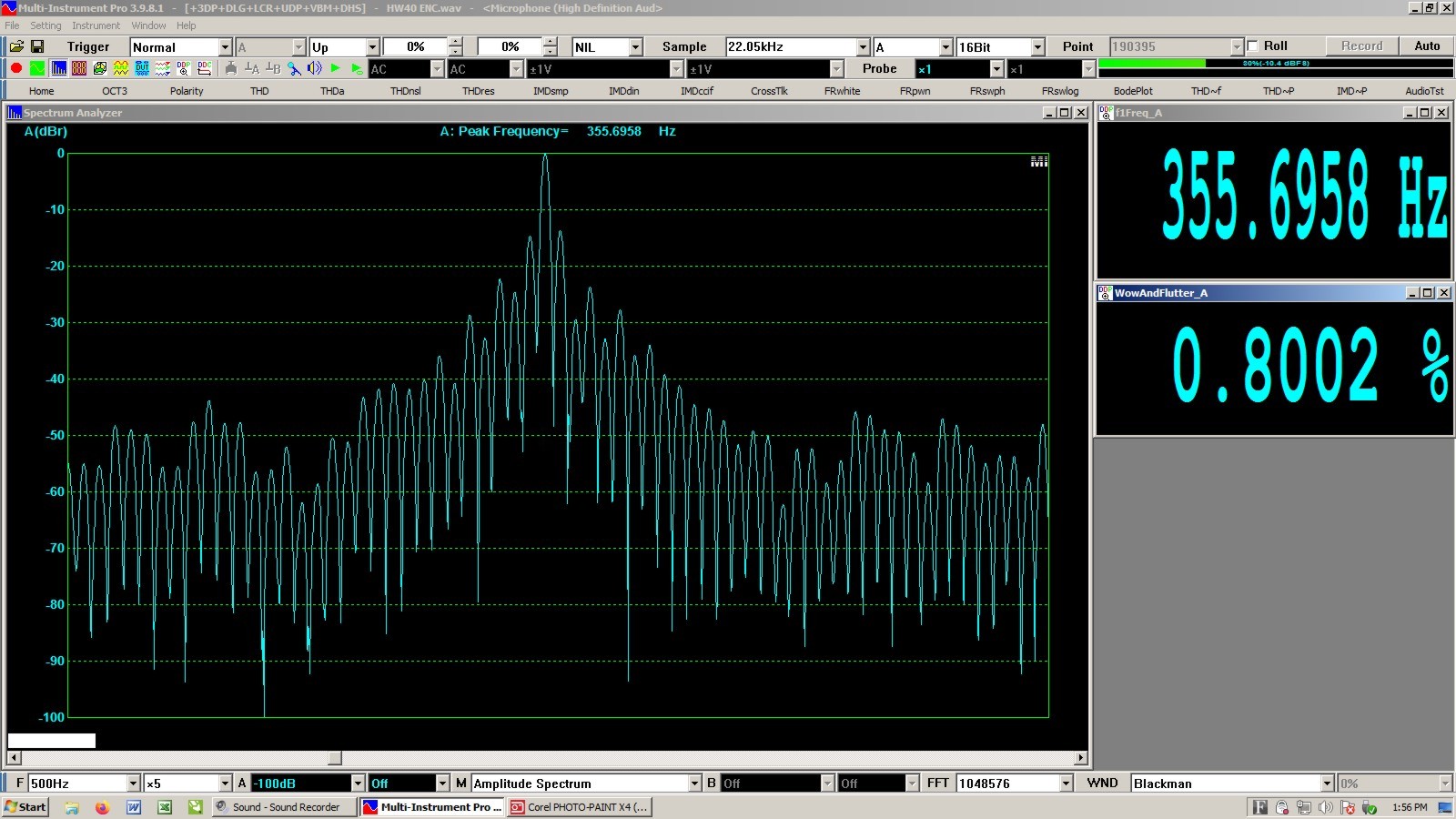

- Anaheim motor you mentioned specified at 2000rpm in post #127: their website is mentioning 4 poles and custom arrangement, doesn't matter. Important is that my motor has many more poles than this one I use. I think this will result in higher frequency and lower amplitude of speed deviation.
- So far I measured platter with test LP at 1kHz (Ortofon test LP doesn't have 3150 Hz track) and consistently got exactly the same as you got on VPI (0.8%). Since encoder as you used is far more accurate than LP, I guess my TT is already better than VPI 🙂
