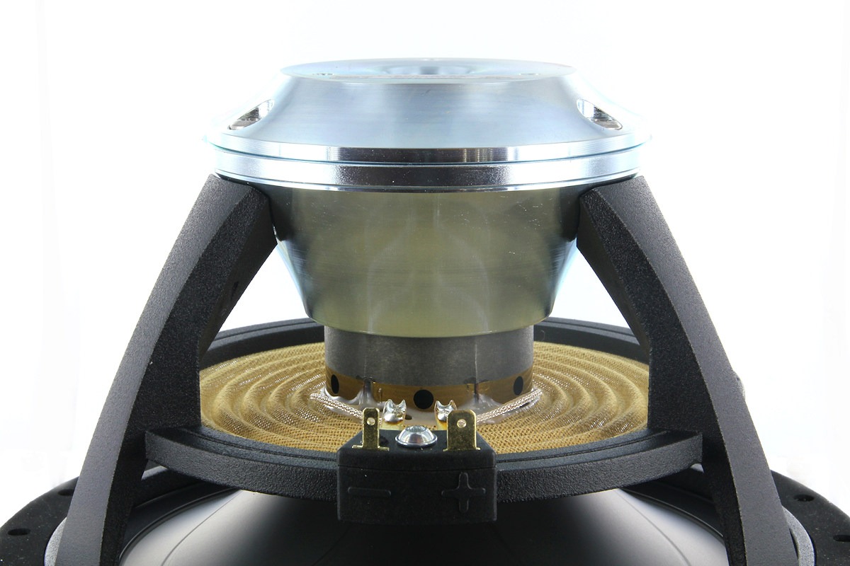

You might want to look at the work put in by Scan, SB, Seas and many others (especially pro-audio manufacturers) in minimising motor structures, open & highly profiled baskets and shaped magnet structures, vented coil formers, vented motor structures etc., plus attempts by others to eliminate traditional rear suspensions. Since form follows function there's a limit to what can be done with regular moving coil designs of course, but plenty have put work into reducing interference as far as practicable -especially important / useful in high power pro-audio.I haven't really seen any other manufacturers take good care of how the backwave behaves starting from the voice coil and the cone. No streamlined shape, just a big lump of magnet for diffraction and uneven loading of the cone.
So a flat back-plate makes sense.
It makes sense from a construction and potentially aesthetic perspective in cases where it will have minimal effect (which probably includes this one). That doesn't mean it's a good idea in general, just an acceptable tradeoff (or at least one where the inherent compromises are unlikely to cause issues) under a given set of conditions.

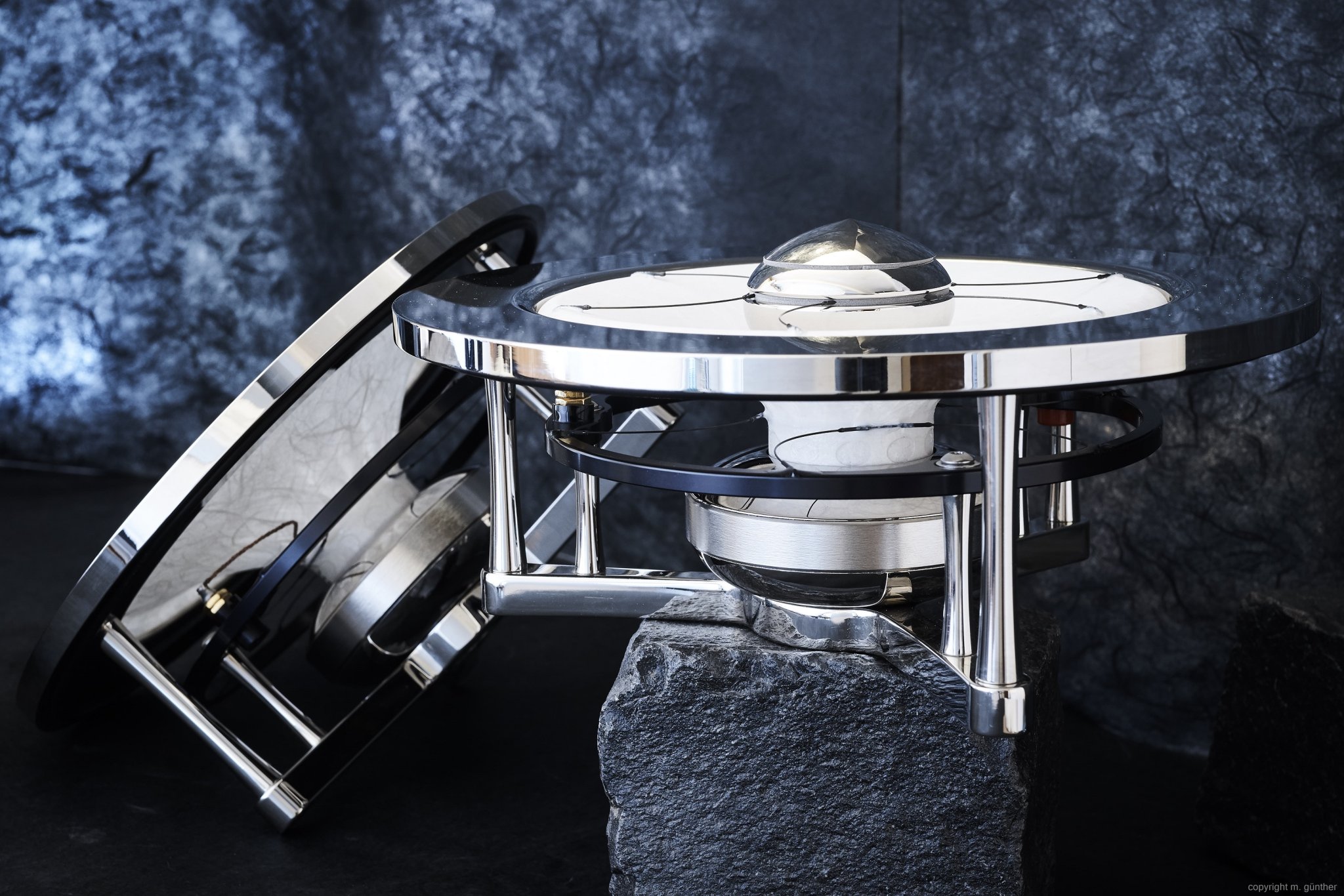

I may be allowed to show a picture of what I regard as an open back speaker, trying to maintain a maximally open area near the rear side of the cone. But oh ****, it´s shiny as well...
A high mass of a driver is not a bad idea, sure. A high Mms is a bad idea for fullrange drivers.
