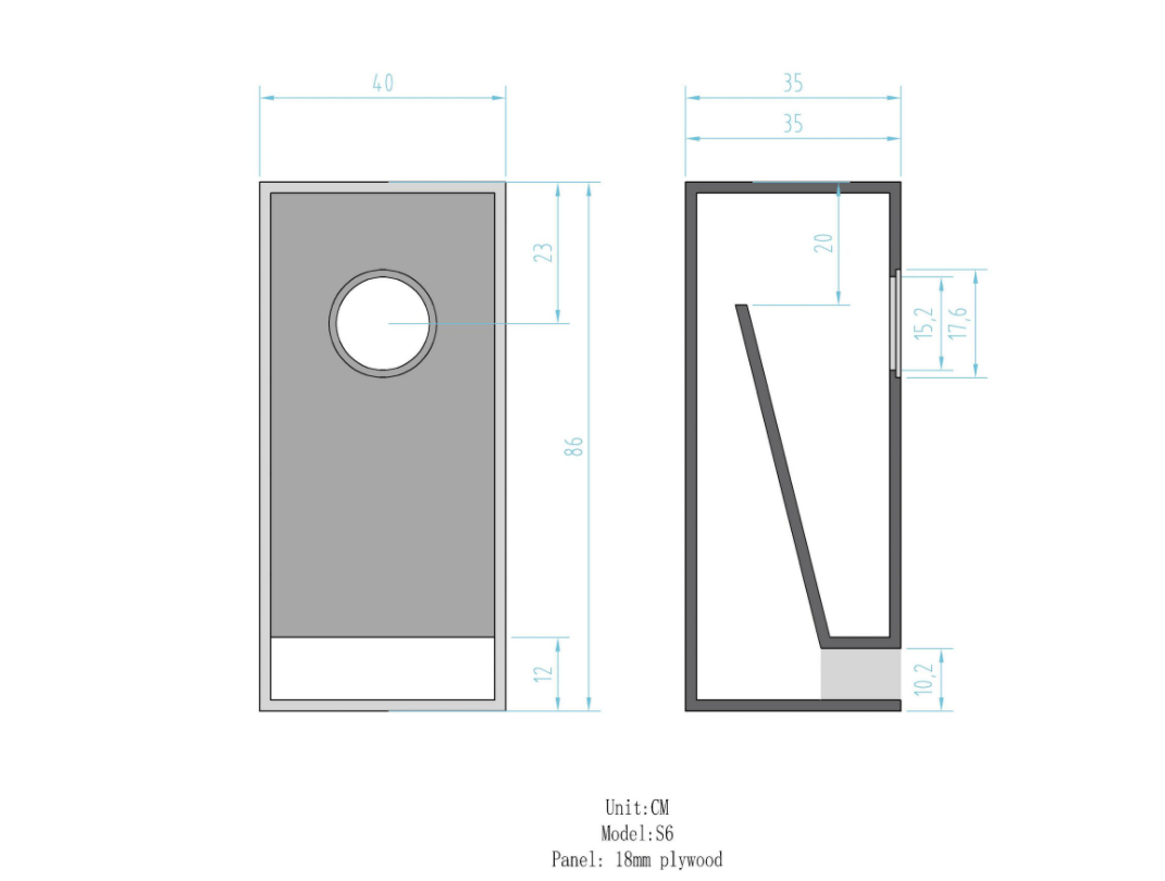

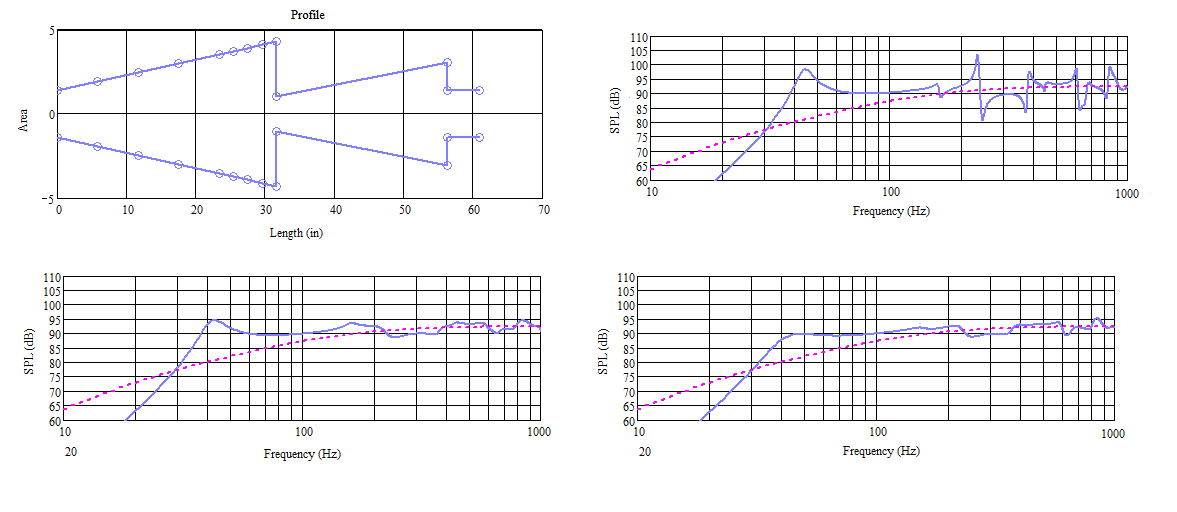

Er -hard to say, since they can't be bothered to say themselves. Since their driver data is often a trifle odd, I'm not entirely surprised, although I take no joy in saying that. Harsh, but the truth not infrequently sounds that way.
Give me ten, I'll see what I can suggest.

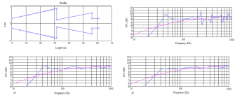

Edit: back. Looking at it, I see they don't bother to provide proper dimensions for the box either (sigh), but approximating like mad, I'd suggest the tried & trusted method of lagging the throat (horizontal part below the driver), the top, one sidewall, and the back of the sloping internal dividing panel with 12mm - 25mm bonded acoustic fibreglass, BAF or an equivalent.

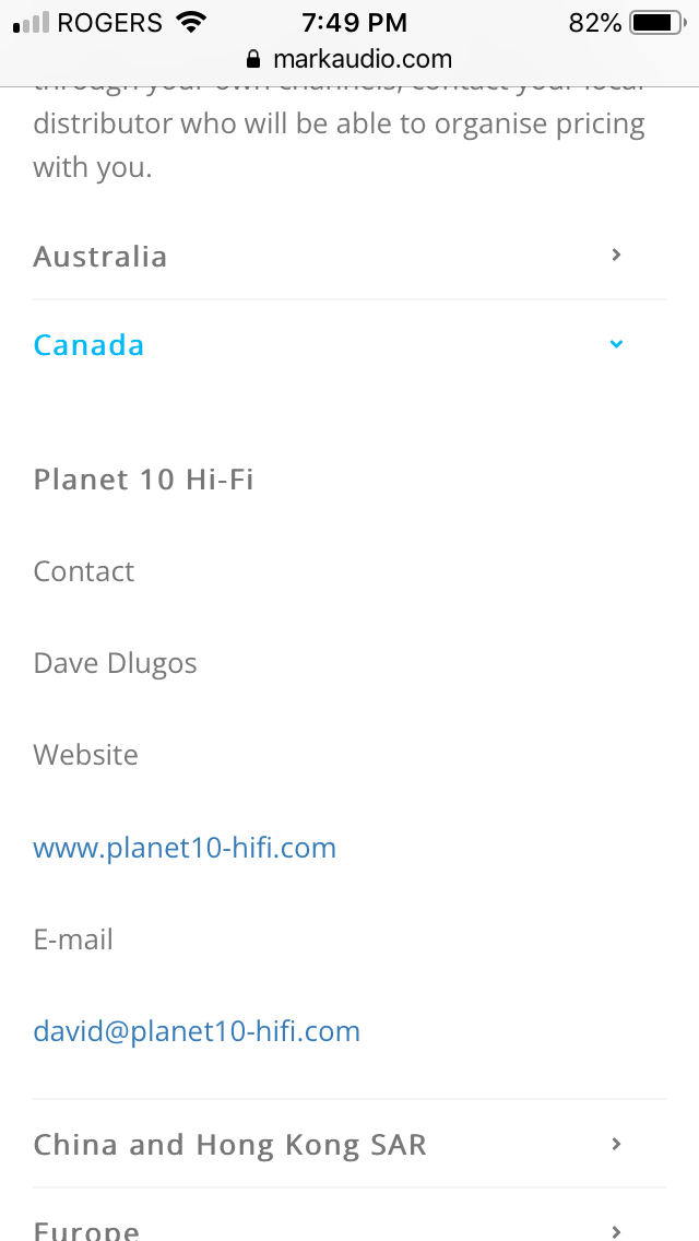

Ok I’ll check somewhere else then. You should talk with Mark Audio, the attached picture is taken from MA and your name is there as a distributor.
Eric
