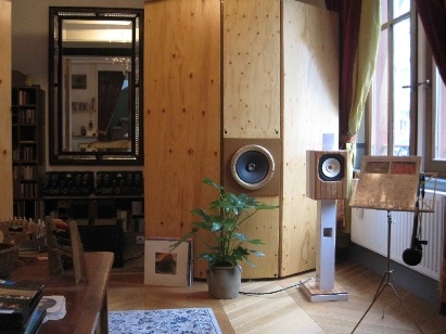

I would worry about those large baffles resonating and also blocking the reflection from the wall behind them.Thanks Craigtone
After open baffles demonstration with 12"Full Range PHY/HP
what was my conclusion : only high and large dimensions size can produce more realistic double bass
like in jazz music etc. and room acoustic conditions are importent
I don't noticed strange resonances or such..
Can write about the long music session in the past with this large open baffles and 12" PHY/HP drivers + PHY/HP tweeter.
Baffles was made with high quality wood and sand filled inside.
The OTL Audiomat amp and passive preamplifier were playing
London Symphony Orchestra with Ravi Shankar and Yehudi Menuhin album
this was an extraordinary sound stage and beautiful emotional music experience subtile and powerful at the same time
Can be interesting with F-15 to try or reducted size Klangfilm Bionor for me..

Klangfilm Bionor = mixture of open baffle with horn Interesting
They are beauties

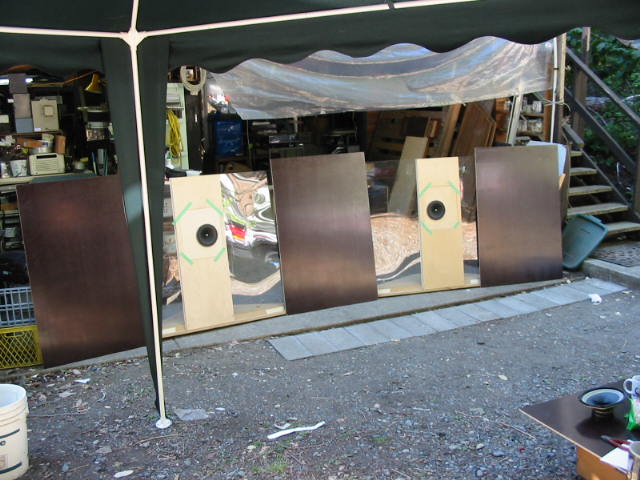

Indeed. A large baffle can make a big difference.
We got amazing bottom out of a pair of OB specific unobtainium Korean 6.5” FR on a 17’ wide baffle produced better bottom then the 15” Eminence on a 30” wide baffle (1,1m high).
dave
How did you end up with a 17' wide baffle Dave? Like this?

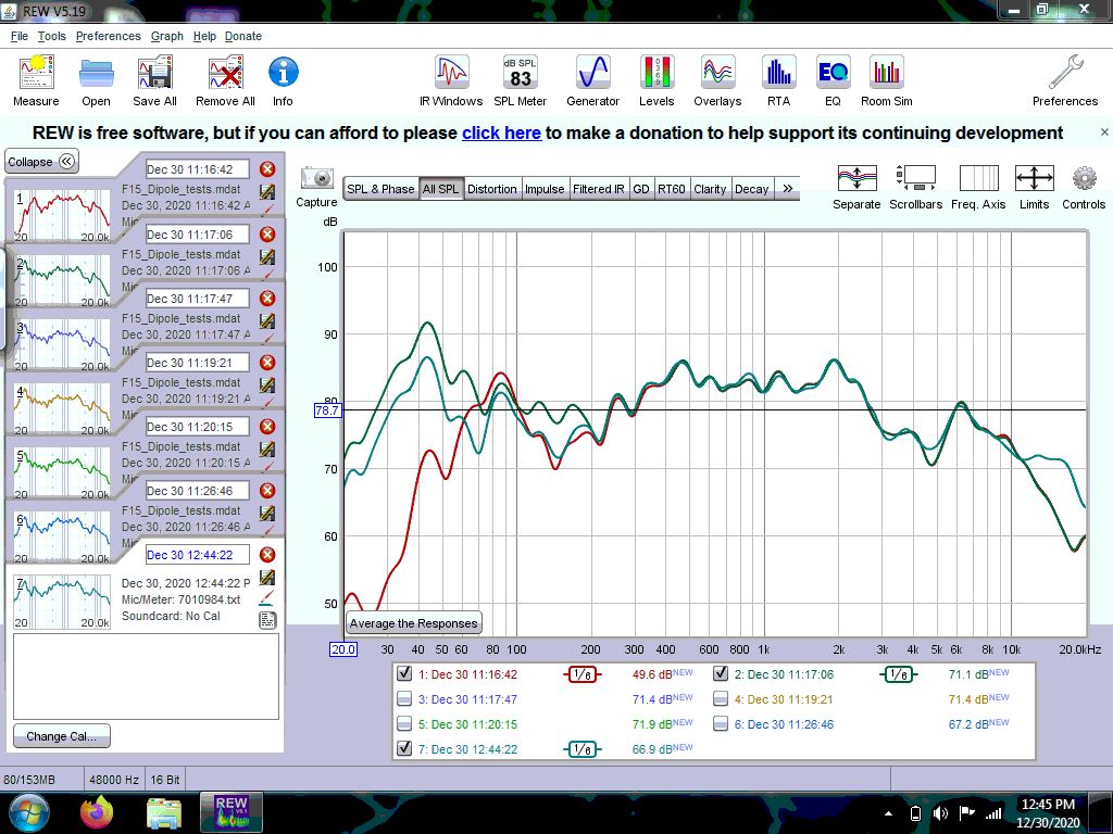

'Funny' you should mention this since I noticed something familiar when I looked at craigtone's measurements last night, just couldn't 'put my finger on it', so thanks for the 'nudge'!
The small VoTT is a 110 Hz 1/4 WL expo flare that loads from ~150 - 342 Hz, so based on craigtone's red trace and knowing how much 'over the top' enthusiasm the Asian audio community has for W.E./Lansing/Altec in general and the small format A5/7 series in particular, one could reasonably deduce that the F15 was designed specifically to work in it: https://www.diyaudio.com/forums/att...nge-229b3dda-0dd7-4eb1-9c91-2a901167bee0-jpeg
With the early 825 cab's ~12.56 ft^3 back chamber/~62 Hz Fb [the 828 is a bit smaller due to blocked off horn flares], then tuned lower or just made somewhat aperiodic even its super high Qt probably would pose no problems, further making me wonder if this is [one of] the prime performance goals.
