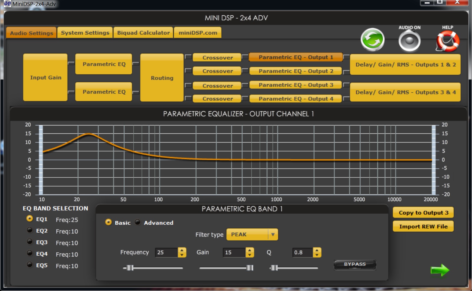

So here's some plots describing the frequency response of what I'm getting using the 18" helper woofers, EQd by a miniDSP.
First are the miniDSP settings, basically I've implemented a 24db LR low pass @ 70Hz, followed by a reverse-rise to 25 Hz (see 1st screenshot). Check out the system measurement at the low end in the 2nd capture. (Realizing I'm a little bass heavy, but always been that way)

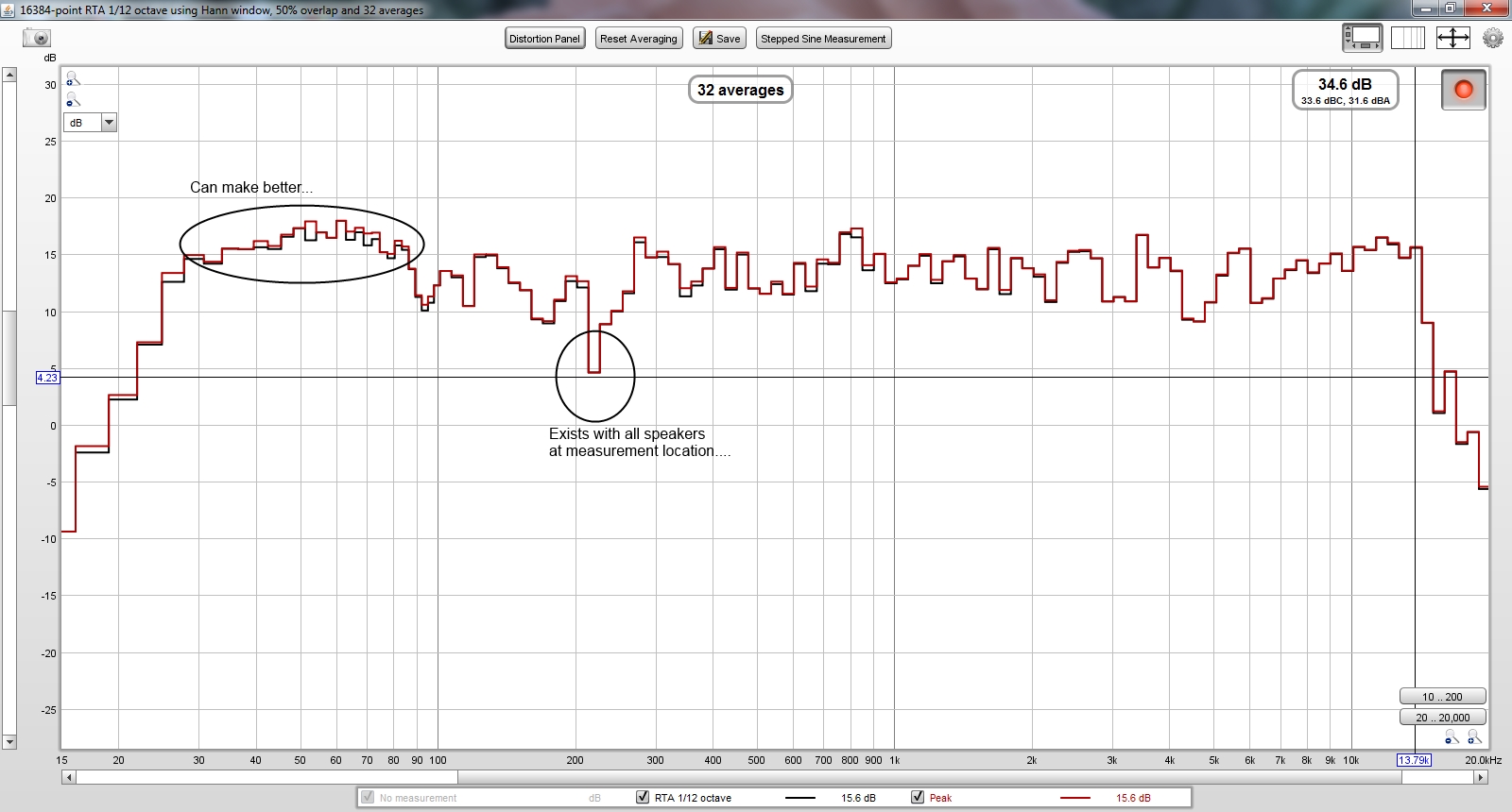

Today, I took a spin with REW and made my 1st swept sine measurement.
I'm happy because I was able to take it through the process to ultimately create an impulse file - of a corrective filter set it created for me. See snap #3 of the swept sine and the correction it made. (This was just for the F15 alone)
Having saved these files and uploaded them into Daphile, my USB stick music player, it sure sounds different when you engage the convolution filter. Unsure if I like the more correct sound, however I do realize my ears could get used to it. I havent listened to it this way very much yet.
I owe another measurement as a trust but verify step - see how the REW analyzer shows the effect of all the filters it cooked up. I'll use my 15 minute Pink noise recording played back via Daphile...

I see some squiggles on there that could be related to the LR filter.

I like to nudge some of the more general dips & peaks a bit before doing another sweep, some times a little nudge in one part of the spectrum seem to influence response far away. It often pays off to hunt for resonant behaviour using the distortion plot and starting with the more troublesome peaks&dips, quite often the rest will look more tidy after doing a few tweak/sweep rounds on the biggest problems. Go for nice behaviour perhaps 5º to 20º or 10º-30º or something, don't pay much attention to 0º.
I don't pay attention to the REW auto thingy, it just looks at response and does nothing for resonance issues. Sometimes it sounds worse than no eq.
Always do another sweep after applying or tweaking any setting.
Edit:
The last few years I've been using this as a sort of standard routine and just forget about degrees and everything:
Run 4-6 sweeps in and around listening position (I usually stay within ca 1 to 1.5 meters), apply 12th/octave smoothing on all, look for peaks and dips that coincide on all measurements, adjust eq, repeat.

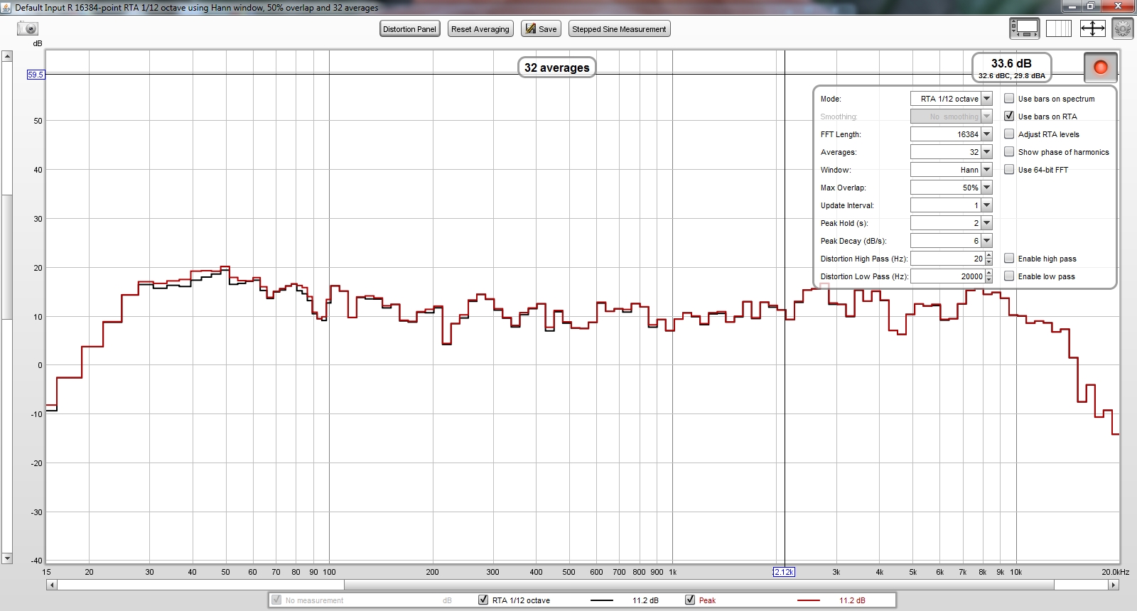

So here's the latest FR plots - 18" assist included - with a reduced set of EQ bands obtained from REW. Gotta remember to SAVE those EQ settings! It's not that hard to recreate from the initial measurement...
The one dip just above 200 is there with any speaker I use in the same position - so I discount that as being Lii F15 specific. There's still some tweaks I can do on the miniDSP low pass function, but it's performing fairly well now. I've included 1/12 and 1/48 octave plots. Listening to them now I'm finding no objections with the gorgeous soundstage and sometimes scary player presence in the room.

... Yeah, it's a bit double edged, like most compromises. Just try and go for minimum amount of eq needed for flat-enough response, you can get almost better results doing "less is more". But it takes more fine-tuning to get it just so. Modes under 300hz or so need a bit of brute force though. Do adjust a bit to taste, after a bit of tweaking most end up in the vicinity of the "JBL tilt". There's no right here, as long as you're happy that's all that counts.
