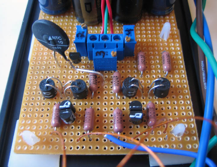

Hi Rick,
The parts for the NP lightspeed arrived.
Can you post a picture of your NP buffer to assist in my layout?

KP93300,
Here it is. The outside 1K resistors are input. I ran a single heavier signal ground wire to the rca's. The blue one at the center. I also connected the signal ground to the power ground through the thermistor. When I forgot to turn the Lightspeed on before the amp I got a terrible hum and this solved that.
I had a listen to the B1 last night and the Lightspeed has better detail and really brings the performers into focus. The B1 is nice but I'm stickiing with the LS for the time being. Hope that helps.

Hi Rick,
Much appreciated for your picture and the helpful comments.
I hope to start the project today !

Hi Rick ,
Can you provide the part number for the thermistor ?
Where did you source it from ?

I think it is same as CL60. 10Ohm. One of NP's building blocks for everything. Mouser #527-CL60

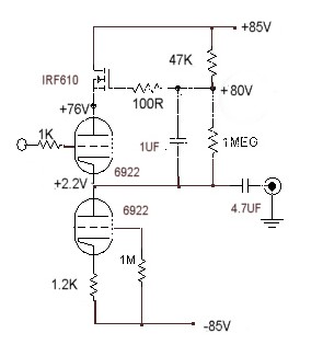

I did build one series resistor/shunt ldr (mkI) with a tube buffer ( a variation on a Tektronix Oscilloscope buffer) once that sounded good, this was with which we all agreed on was the best sounding buffer we ever heard (attached), but it was still behind the series/shunt mkII Lightspeed Attenuator without buffer, it was just better at driving low impedance <50k power amps.
Cheers George
Cheers George
