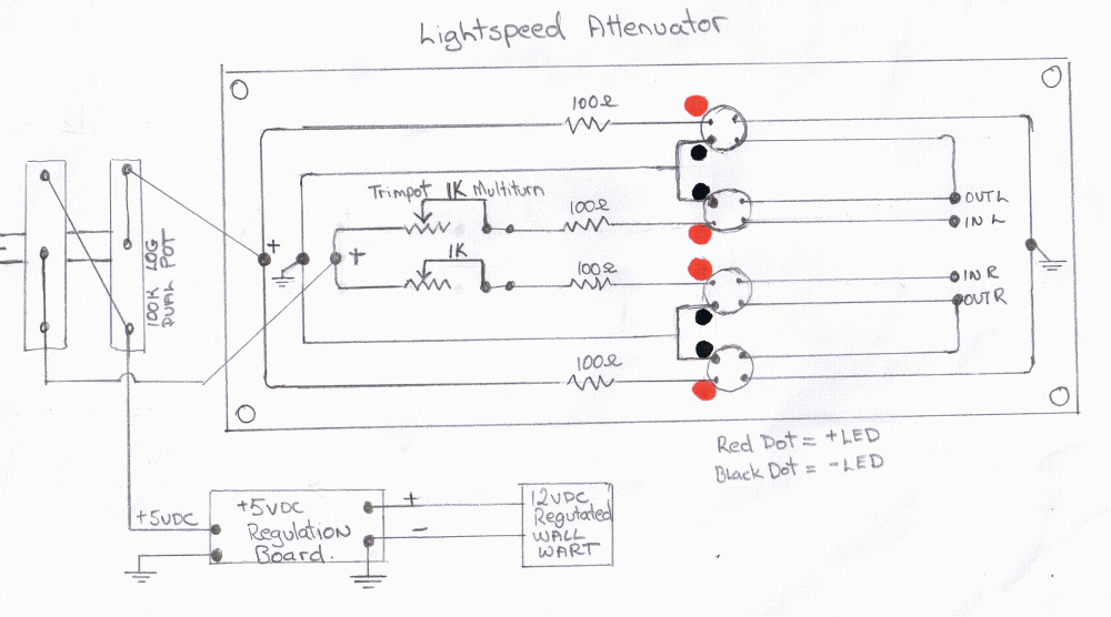

Sanity Check on Design
Hello all,
First I would like to give a shout out to Georgehifi opening his designbook on the LDR attenuator. It is people like Georgehi and Sir Nelson Pass that allow lesser knowing hobbiest like myself to learn all things audio that I would have never have thought I would ever understand. Being and Engineer (not Electrical), it is human nature for me to get somewhat fanatical on new concepts (drives the wife batty) and this Lightspeed Attenuator is one of those new concepts I can't get off my mind...
Anyway, along with the praise, I do have a request. A sanity check on my LDR attenuator before I connect to my amp/speakers. The amp is a self-built UCD400 (100k Ohm input Impedance) and my self-refurbed Magnepan MGIIIa's. The source is a simple DVD player with a fancy DAC. Output is standard 2V.
I have purchased the NSL-32SR2S (10 of them - after waiting three weeks to arrive) and made a halfassed attempt to sort them...
First, the 5VDC supply is basically a 19VDC Laptop powersupply through an LM317 with a pot so I can dial in any voltage within 2VDC to 17VDC - so I have a nice clean 5.02VDC output to the Attenuator board.
Connecting the power to the Dual 100K pot as noted, I get a range of 5VDC to 4.95VDC (unloaded - unconnected to the attenuator board) with pot fully turned ClockWise, and the other side the exact opposite. Looks to be per design.
Next, I connected all the Grounds (power, signal in/out, LED side of LDR) together and connected the 5VDC power source to the 100K pot. The resistance range between each channel LDR signal input and output goes from 9.5K Ohms to 0.05K Ohms (turning dual pot fully counter clockwise is .05K Ohms). The other side works identically. I had to dial in the two 9.5K Ohm sides to match via the trimpot as they were slightly off by around 500 Ohm. Trimpot ground is left floating.
Everything seem in order?
BTW, why two trimpots? Trimming one channel down inversely affects the other channel...
Again, thanks for the help and the inspiration.
And I appologize if this was discussed earlier...

100 ohm current limiting resistors?
I hope you have installed 100 ohm current limiting resistors at each end of the pots. The LDR operate at around 2.5 volts. If you hit them with 5 volts and no series resistance the LED's will go very quickly.
I use mono controls instead of trimmers. So the resistors are 200 ohm, if stereo 100 ohm works well.
If you still measure a resistance as the pots are rotated, all is well.
George

Each end of the Pot - are you talking of the 1K Trimpots? The initial schematic had a single 100 ohm resistor between the trimpot and + LED side of LDR. Is there supposed to be another 100 Ohm resistor between the 100K main pot and the Trimpot? I have only four 100 Ohm resistors and two 1K trimpots on board.
Do my resistances at the Signal Input/Output of the LDR look correct? They seem low and seem opposite to me (9.5K Ohm at full Clockwise position on Main 100K Dual Pot)
I know this is a shunt type design, just not very familiar with them...
john65b said:Like this from previous post -
Just like that John, except use only one 1K trimpot on the loudest of the two channels, this is becomes a final calibration for channel equalizing (matching).
Glad to see you've built one for yourself, give use an appraisal on how it sounds to you, and don't forget to vote for the Passive Preamp forum.

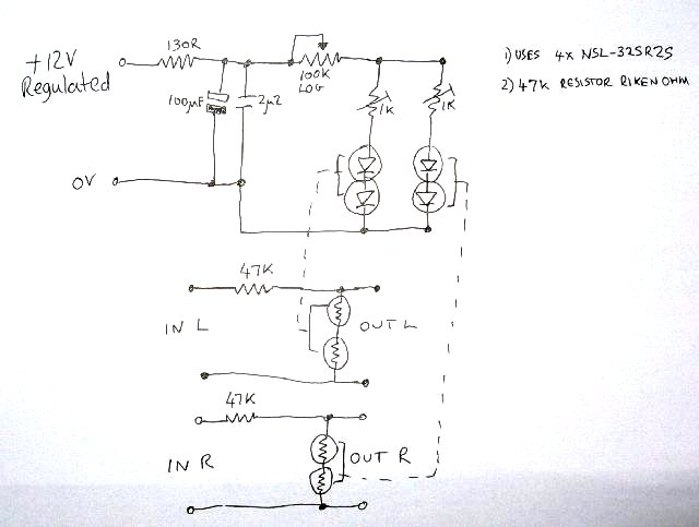

My version as volume control for Aikido
I built a variation on the theme, to suit my own needs. Basically I wanted a volume control for my 6SN7 Aikido preamp.
I had some different design goals:
-- I did not want the low input impedance of the Lightspeed design
-- On the other hand it does not have to drive cables, only the grid of a triode.
-- I wanted to use a high quality resistor as the series pass element, and use the LDR as the shunt element.
-- I had some gain to burn.
-- I had a 12V nicely regulated supply available.
With the setup I have, the LDRs range in resistance from about 70ohms to 12k (each). So note that at maximum volume the series pass is 47K with shunt of 24k, giving only about 1/3 of the available voltage. This is fine in my application.
Also the minimum volume setting still gives a nice quiet late night listening level. There is a mute switch on the preamp for zero volume.
The design I came up with is shown below, and it works very well, comfortably beating the Alps pot I was using before.
I have on order a relay switched attenuator, so I will be interested to compare that and the LDR. I may end up using the switched attenuator to control the LDRs. Why? The attenuator has remote control..
Note that this design will not work as a passive preamp as the output impedance is too high to drive cables, and you will be better off building the Lightspeed design (or the series/shunt Silonex application note design)
Well I finally got around to checking the LS attenuator out - I had to try it on my "beater" amp (P to P Gainclone with Sony CD Player and Polk Audio speakers)
Anyway, the gain is too high - 1/4 turn was almost full LOUDNESS (this may have been covered elsewhere for Gainclone and Lightspeed Attenuator ) and the pot was reversed (fully CW was lowest volume)
Anyway, I was able to listen at moderate levels and I like it. Seems to best my Parasound PHP-850 Preamp. I need to do a few mods before I put it in a nice chassis and try it on my UCD...
I have a 250K single pot with power switch I may try to lower the gain.
Remember it has to be 100k logarithmic if using my identical circuit, if it is a linear the volume comes on way too quick just as you described 1/4 turn too loud, with the logarithmic it is normal listening level at 1/2 then get really gets going from 2 o'clock onwards, just how it should be.
Cheers George
