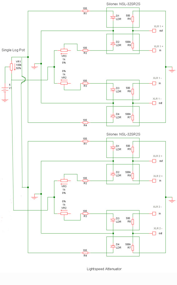

Here's the one with a Single Pot...
The only thing is you have your 5vdc coming in on the wiper and one end of the resistance track on each section, where I only had it coming in on one end of the resistance track of each section and not the wiper as well. and you'll only need the 1k trimmer on the channel with the highest gain.
Cheers George (Nice drawing BTW).
would this schematic work for balanced input?
Dear George,
Can I ask what is the advantage with this arrangement "I only had it coming in on one end of the resistance track of each section and not the wiper as well"?
georgehifi said:
This single pot balanced version should work nicely, again with a 200klog pot, wish you all the luck on the matching of the LDR's double the work.
Cheers George
