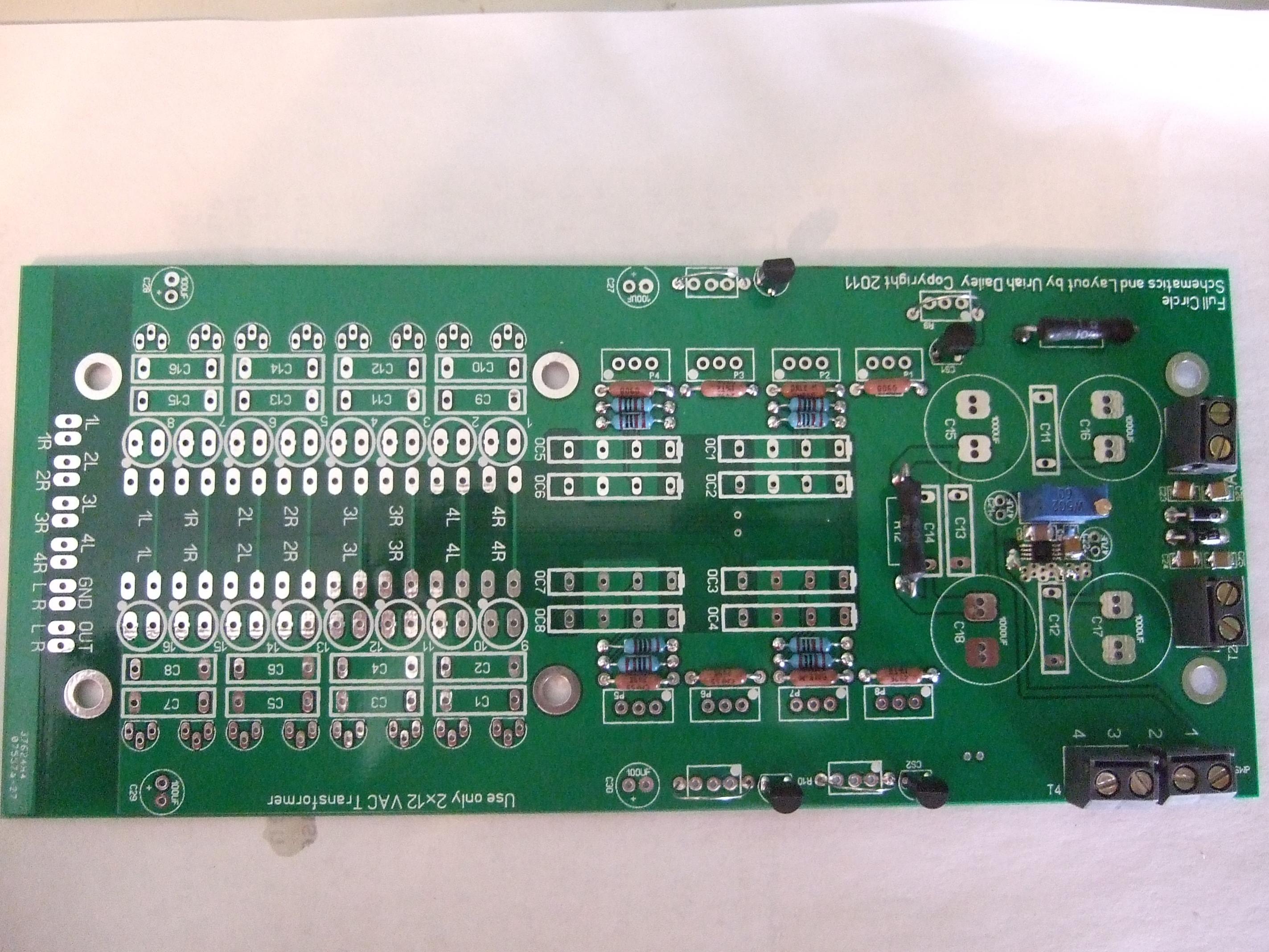

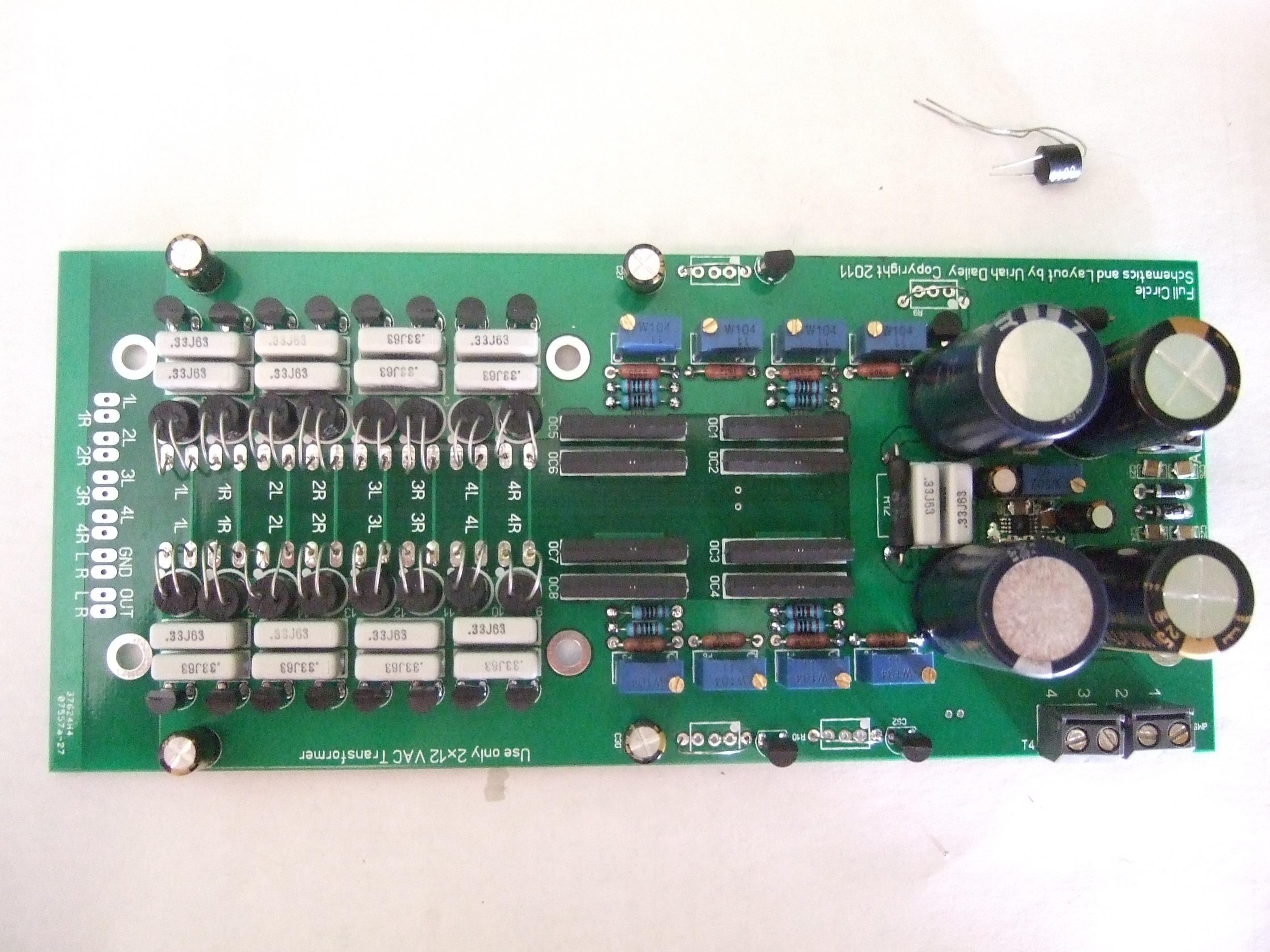

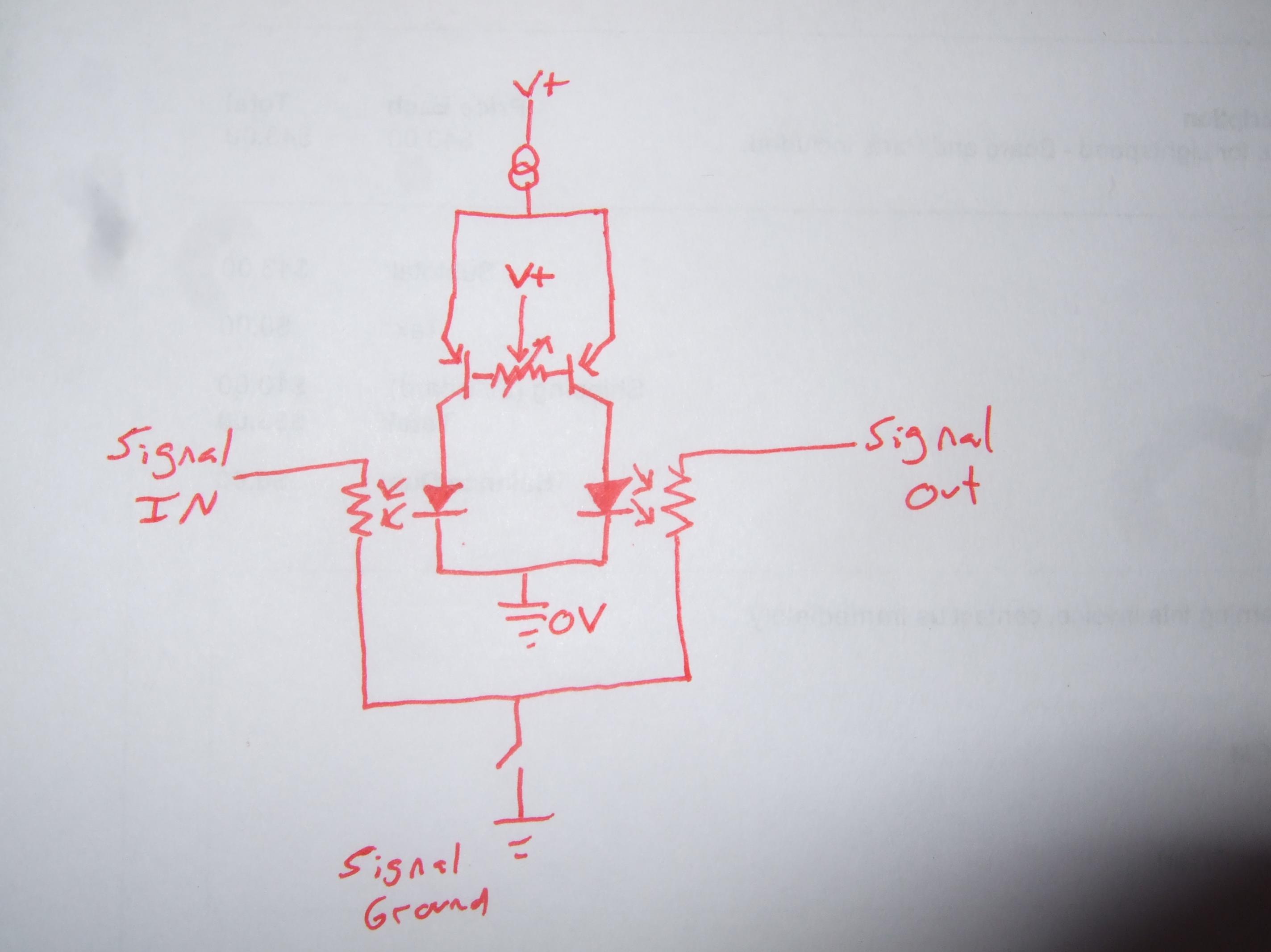

I promised a while back to show you guys how to do input selection with LDRs. I got the board done and working well. I will post a pic and then a link to discussion. I dont think its a transgression to speak about it here but this thread gets sidetracked so often, nice to keep it on track.
This is the general idea. Regulated voltage is put through a current source which supplies power to the LDRs. Regulated voltage is applied to a trimmer that turns on the transistors. By twiddling the trimmer you can balance the resistance of the LDRs so they are the same. By increasing the voltage you can lower the resistance of both at the same time.
ON means both LDRs turn on full force at 40R each for a series total of 80R and the relay is open.
OFF means that both LDRs have 25Megohm or more resistance and the relay has less than 5R. Its an optocoupler relay to keep with the theme.
