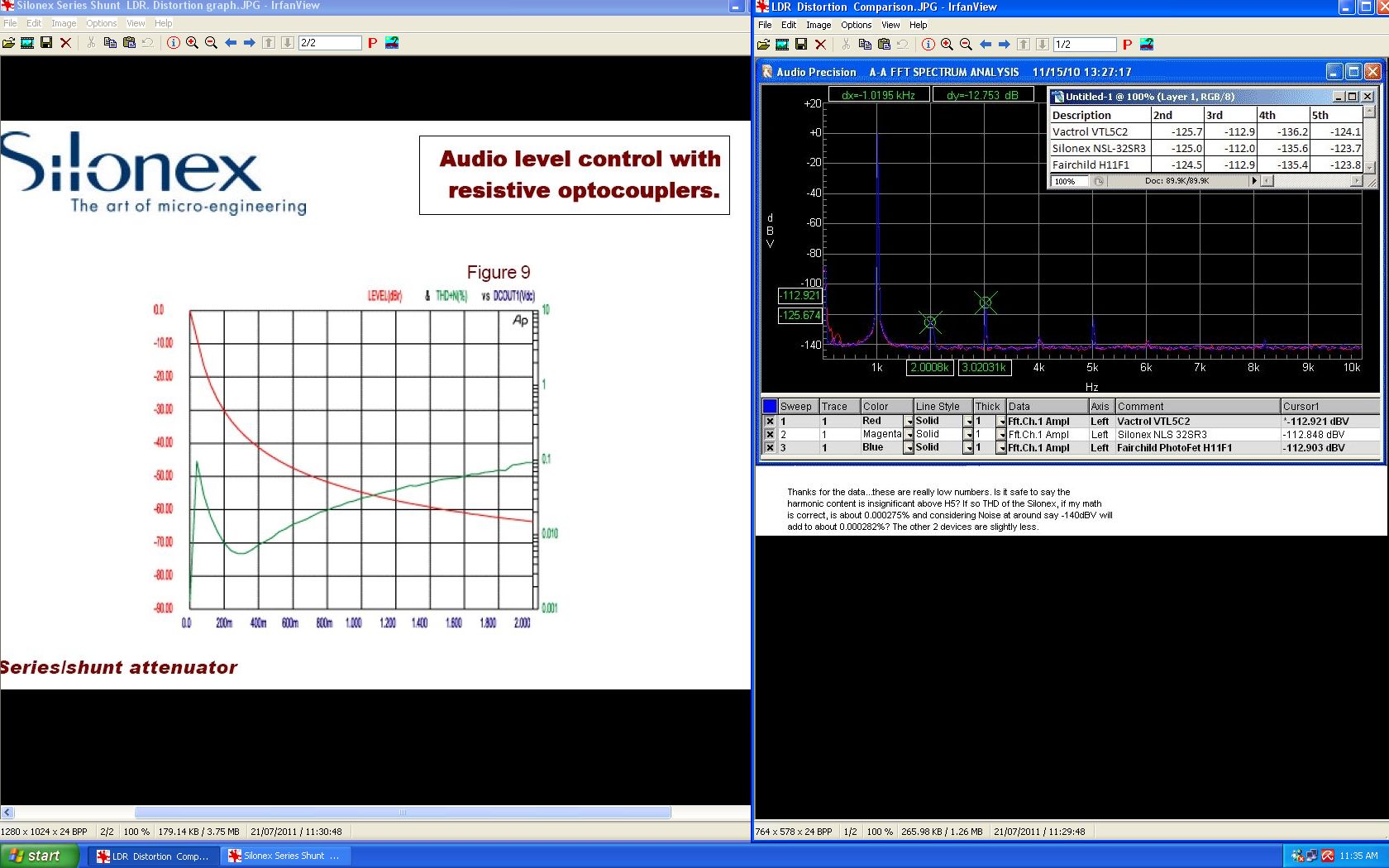

Here are some updated distortion measurments for those interested from Silonex and then AP ones done by a member here.
Cheers George

The text on the AP slide is a bit small. Is the LS THD figure 0.000282%?
Many thanks!
Jon
The .000275% was his calculated distortion, plus the noise floor he says he measured of.000282%
