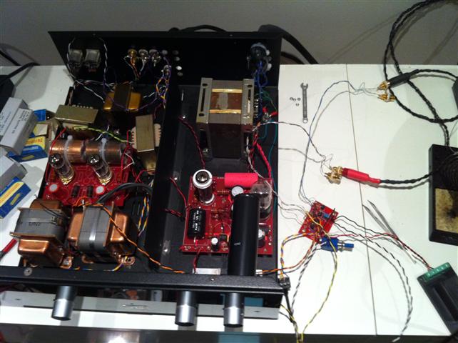

I finally managed to make one lightspeed attenuator. After testing it seems ok.
I have now - in testing configuration bypassed the TKD pot in my somewhat modified Audio Note preamp.
It sounds very good...
Vel it looks like a mess but sounds good... 🙂
I am using a 50k pot for volume but it is exstremely sensitive. I think I have to use a 100k pot or maybe 250k? Is that smart?
attachment.php
Sometimes, when they are so sensitive you may consider finding a way to keep the shunt LDRs at a lower max resistance or a way to keep series at a higher min resistance. This way you do not get incredibly loud volume on accident with touchy LDRs. It may be your pot and it may be the taper of your pot as well. Since all LDRs have a different resistance taper to them you may have a pair that increase in resistance faster than most in shunt or the opposite in series.
Anyway.
Here is the things to try
100k pot dual gang log. This will help for sure.
10k-30k resistors in place of the 100R resistors that are feeding your Series LDRs. You will NOT get max volume this way and your resistance curve will change a lot, but it will help with your immediate problem.
5k-20k resistors in parallel with the resistor side of your Shunt LDRs. This will keep shunt from increasing in value to fast and will also have negative side effects as mentioned above with series fix.
Probably your only problem is that you are not using 100k dual log pot. However if you have high gain amp and you have super efficient speakers sometimes the normal LS setup can be tuned to work better with that sort of system in these ways. There are other options like different voltage to drive them or series 10R pot before 100k pot.
Try 100k first and let us know.
