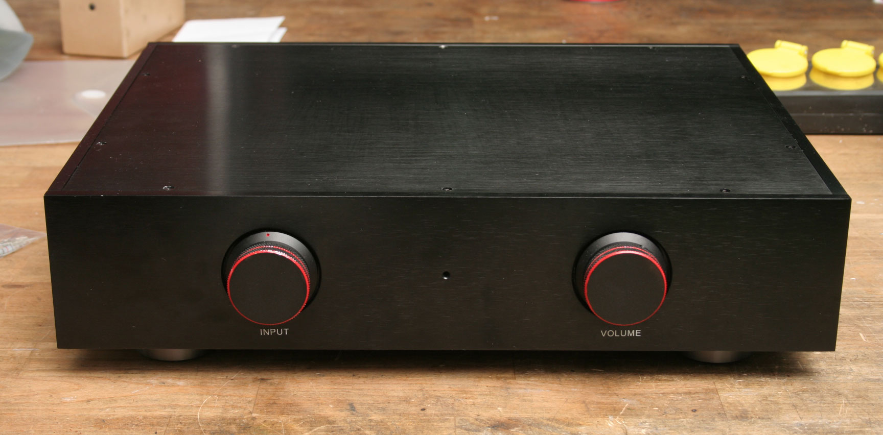

I am no electronics expert, but there is a lot to be learned on several diy forums. So this is how I built my own DAC with volume control, since most of the music comes from CD or USB from the computer, and the DAC I built puts out sufficient voltage to drive my speakers very, very loud.
The DAC ( all DDDAC)has a USB to I2S coverter circuit, a SPDIF to I2S converter and a direct I2S input through a RJ45 receptacle (I2S iconnection cable is a cat5 FTP cable) Through a 3 position rotary switch I can select the I2S signal that comes directly from the Cd Transport, or the one from the USB converter board or the one from the SPDIF converter board.
The signal goes from the switch to several DAC boards, all using 12x TDA 1543 Dac chips in parallel.
The analog output goes through coupling capacitors to a LDR attenuator board (Uriahs kit) and from there to the RCA plugs connecting to the power amps ( two 7Watts Klimo Beltaine monos with 300B).
The volume is controlled with a motorized dual 100K Alps poti (regulating the Leds of the LDRs circuit and thus the volume ) through a remote control circuit from Dantimax. I am only using the motorized control feature, but it has two relays to be used as mute and power on.
So the DAC box does it all, acting as a switching passive preamp with remote volume control.
Since I wanted remote control for the volume, I could not use a stepped attenuator, so the LDR solution was perfect.
Sounds fantastic
