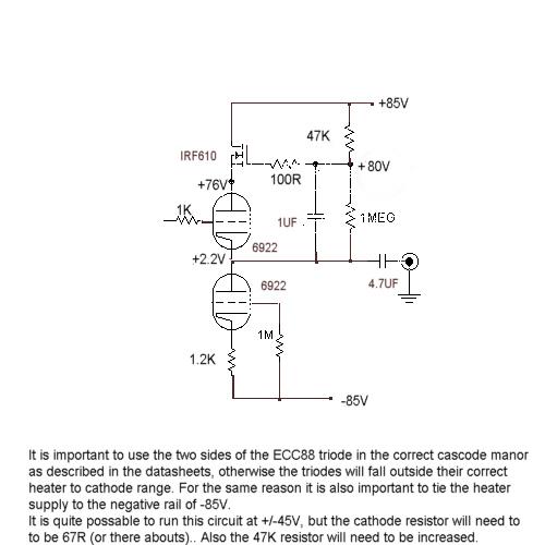

post3632
George,
is that the schematic that was converted to mosFETs by one of our Members in Europe?
George,
Hi Andrew,
I posted a mosfet circuit, that is very similar in operation to the tube buffer, in post 1742 on page 175 if this helps.
Regards
paul
Regards
paul
I've started work on my clone again. 🙂
Hopefully I'll have it up and running within a month or so. It's been collecting dust for too long.
post3632
George,
It is a buffer that Tektronics used in their top tier tube Occilloscope of yester year and called the "SLCF" Super Linear Cathode Follower, and yes it was reborn. For a tube buffer it has a nice low 100ohms output impedance, shame about the coupling cap thou.
Cheers George
