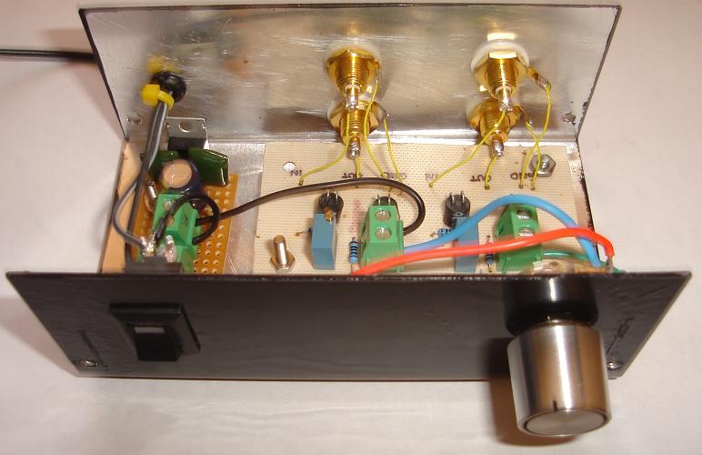

I have no intention of ever spending hundreds of pounds (GBP) on an attenuator.
A simple 12w switch for a pound or two is good enough for coarse volume control.
Remember the Audio Signal does not pass through this switch. It is a control for the LEDs.

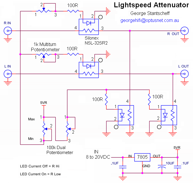

If you look at the schematic you linked, you will see that 5V feed goes to Pin 1 on one channel (A) and then is joined to pin 3 on the other channel (B). Join pins 2A and 3A together and you have a variable 5V supply on the end of that wire. Join pins 1B and 2B together and you have a second 5V supply. As you move the pot, one supply increases, while the other decreases. What we are doing with this circuit is lighting up the LDRs, but one set (A) is attenuating the signal, and the other set (B) is shunting to GROUND.
Once you have built the circuit, then measure the channels (or set them up with a scope like I did) and install the trimmer on the louder channel and tweak it down the both channels are perfectly balanced at your preferred listening volume.
I haven't seen Uriah's board, so can't be more specific, but hopefully this explanation wil make things a little clearer.

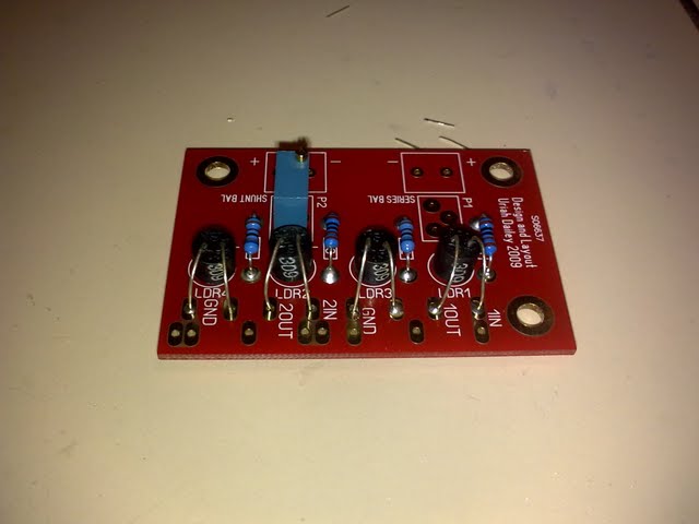

Here is a picture of Uriah's LDR Board.
Does running 5volts through the pot affect it's life?
I will try to figure out the wiring, but a diagram sure would help.
I am still not sure what to do.
Why am I not to istall the trimmer? Where is a manual?

Nope, 5V will not kill your pot. At the milliamps this circuit requires, it's no problem.
You posted the wiring diagram, Gary. It's the same old thing - maybe a different layout, but the circuit is still the same. Power to the LDRs, signal in, signal out etc. I've had a quick look at your images, but it's late here - I'll have another go tomorrow. It should be a case of plumbing in the power, signal in and out and away you go... PS Please can you show the bottom of the board?
The trimmer is only used at the end of the process. Once you have your LDR attenuator working, one channel will be (perhaps only marginally) louder than the other at your favoured listening position due to the fact that the LDRs are never PERFECTLY matched (impossible).
So, install the trimmer on the louder channel and tweak down to get a perfectly balanced sound.

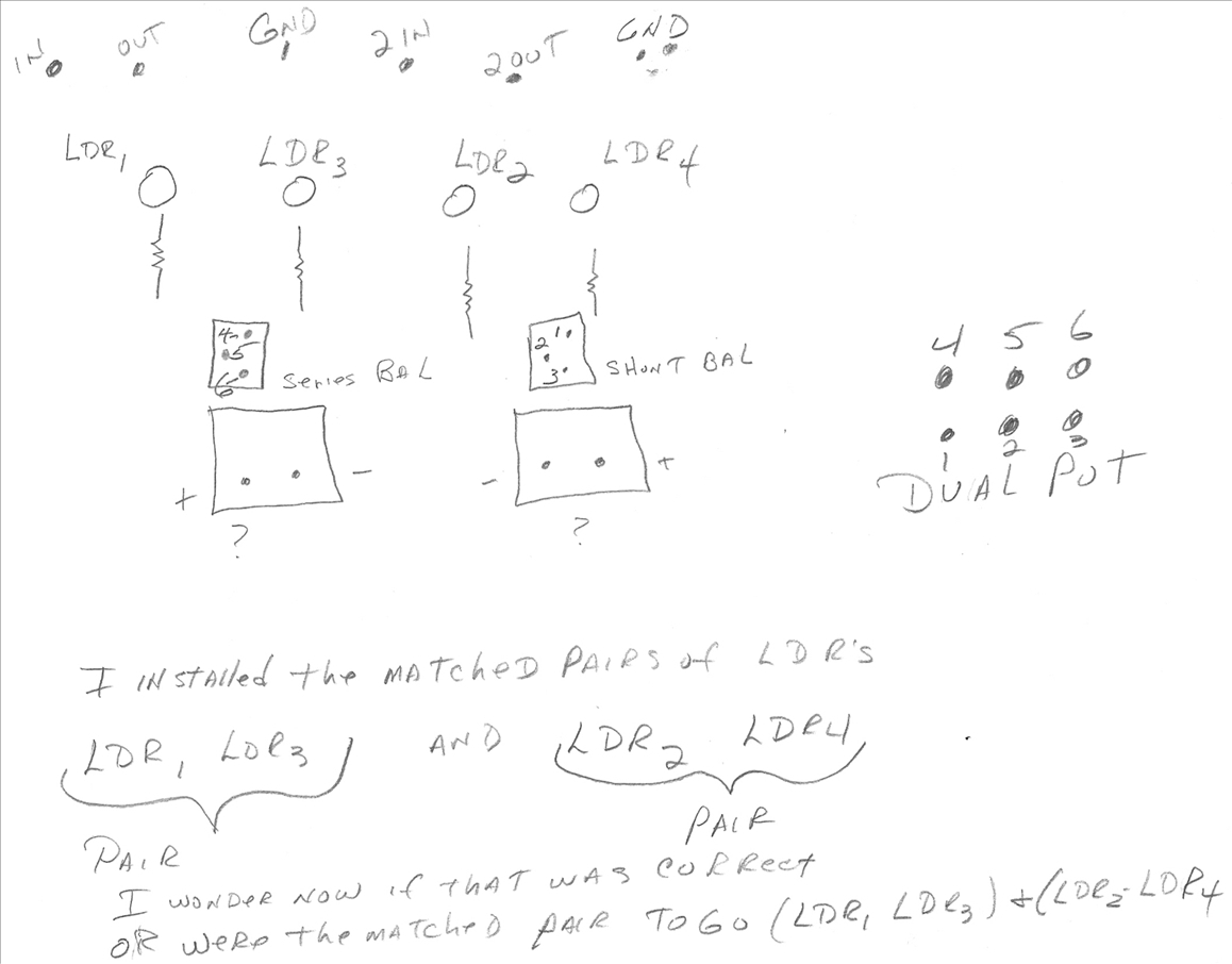

How are the matched set (2) LDR's installed?
Gary, I think you have installed them correctly - or not depending on that pic I reference below.

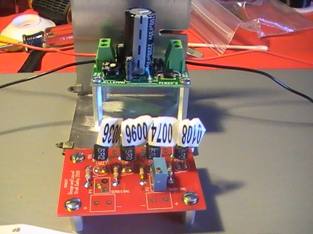

Looking at your earlier board picture, post 3266, LDRs 1 and 2 are the Left/Right Series devices. LDRs 3 and 4 are the Shunt devices.
Is the pic in post 3262 of your LDR vol control? If so, then the LDRs tagged 0036 and 0074 are indeed Left and Right Series, and the LDRs tagged 0096 and 0108 are your Shunt LDRs. These are near enough values, and will just require a bit of trimming when you get up and running. You don't need the trimmer fitted yet. In fact, on closer inspection, I see Uriah has provided a facility to trim both the series and shunt LDRs for balance, but that isn't important right now.
However, if the pic in post 3262 is not of your rig, and having had another look at your note in post 3270, I think I'm with you now! You need to install one matched pair in LDR1 and LDR2 (series) and then the other matched pair in LDR3 and LDR4 (shunt). Your bracketing in your diagram looks the same to me, but to underline: you need one matched pair as the series LDRs and the other matched pair as the shunt LDRs.
Are not the +- boxes behind the trimmers for connecting your two 5V feeds from your dual log pot?

Yes, post 3262 is my picture.
Where do the wires go? I am totally confused about how the dual pot is wired to the board, the manual confuses me.
Are the 4 resistors all 100R? two were missing and one schematic shows all 4 being 100R but the manual stated that two are some other value.
OK, in which case, I think your LDRs are installed correctly.
Pot wiring I explained here:
http://www.diyaudio.com/forums/anal...nuator-new-passive-preamp-66.html#post2201140
The two 5V feeds are connected on the board as the + points. The schematic will tell you which of the two goes where - i.e Pot channel A goes to the + on the box behind the "series bal" trimmer. Pot channel B goes to the + on the box behind the "shunt bal" trimmer.
Connect your RCA IN hot lines to 1IN and 2IN, and connect your RCA OUT hot lines to 1OUT and 2OUT. Connect all ground/cold leads together at the same point (i.e. a star ground).
If you do all of this, your LDR vol control should work. Then we'll go through the channel balancing. I don't know what circuit Uriah used, but it might be that if you desolder the trimmer for now, you will need to solder in a jumper to keep continuity.

referring to post3270.
LDR1 & 2 are the series. These are one matched pair.
LDR3 & 4 are the shunt. These are the other matched pair.
1IN & 1OUT are one channel
2IN & 2OUT are channel 2.
If you have fitted a matched pair to positions 1 & 3 then you have a pair in channel 1 and the other pair in channel 2.
Don't overheat them during de-soldering.
