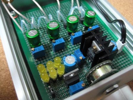

My Lightspeed was born today!!!
Thanks!!:spin: 😛 :cloud9: 😀 Lovely~~

Hi George,
it sounds wonderful after burn-in, yes, they needs 😎 very dynamic sounds, clear & fresh😀
I am using a soundcard(EMU1212M) & Tripath Ta2020, I haven't parallel any resistor to the LDR.
I just get the box in the local component store:spin: I like it so much too, even I am a exquisite taste guy 😉
udailey,
Yes, they are Sala mini shunt idea, easy to bulid, as I am using the trimpot to adjust the current.
I am going to bulid a remote control version:cloud9:, let see~~
