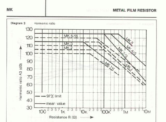

Leaving impedance issue to one side, it does come down to the quality of the resistor in the series position. It would then seem that Cadmium Sulphide/Selenium is an audibly great material for resistors. Silonex gave distortion graphs for the LDR , I wonder how many resistor manufacturers have done the same (Resista distortion graph attached)?
It seems that anything that modulates the electrical parameters of a resistor will introduce distortion, so low tempco & mechanical configuration (nude Vishay). I wonder how LDRs fare in these considerations, tempco & mechanical?
Not only does the MkII sound better because of the chemical make up of the LDR's resistance element compared to carbon or metal film/oxide resistors. I have not compared to smd resistors, but I have done Beshlage Vishay and a couple of others, in metal oxide/film.
It still remains that the MkII configuration has a better (lower) off volume, and more importantly it has much more stable/consistent output impedances, were going back over old discussed things here, that were said a year or so ago.
There is no comparison, MkII (ldr series / ldr shunt) kills the MkI (series resistor / ldr shunt) do you guys think I would recall all the MkI's to upgrade them to MkII for nothing? And also have the big hassle matching all 4 ldr's building the MkII when it was so easy to build the MkI's, my profit margins dropped by 20% because to MkII is so expensive to make.
