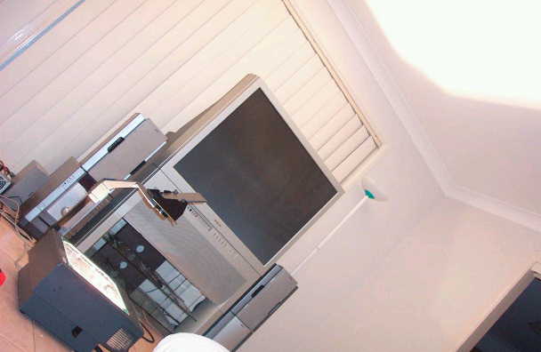

Hi Guys,
I've been searching this forum for days and still unable to find any mention of the problem im having.
I recently picked up a free 3m 9550 OHP,
The problem im having is it seems there is something wrong with the lens on the head of the projector... all I get projected onto the wall is a small spot of light??? (dosent seem to make much different if i turn the varifocal lens from left to right either)
Is anyone familiar with this problem? I'm confident the problem isnt with the projector itself (bulb, reflector, mirror in base of the unit all seem to be working properly) as it projects a very large square onto my roof (see pic)
Images attached :
Hi guys,
It appeas you are all right. The OHP is missing its fresnel lens. :bawling: In my haste as a newbie to this hobby, ive overlooked a vital component that is obviously missing. Im going to try and source another fresnel from a projector at work, posssibly even scoring another entire projector setup.
Thankyou all for your help. Keep it up 😀
