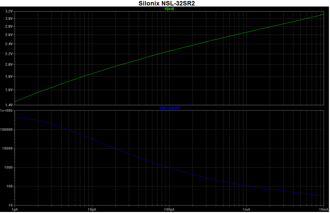

I hate to have to be the one to break this to you, Chris, but voltage and current are not independent of each other. There's an enormous body of work (work, not just hand-waving and talking) called Physics, where (along with many other things) the laws of electricity have been discovered and studied. You should check it out, sometime. Lots of new buzzwords for you. And Physics is only one part of this even larger body of fields of work, called Science. There's even a whole method named after it. Pretty impressive, I'd say.
So, if electric current is like water moving in a waterpipe, then voltage is like the water pressure. There can be no current without voltage, just like water won't flow in a pipe without pressure. But there can be voltage with no current, just like when a valve is turned off, so no water flows, but the pressure is still there, so that if the valve is opened the water will immediately flow again. But if you think about it, pressure is relative, because if you had two tanks connected by a pipe, even if one tank had 1000 psi of pressure, no water would flow if the other tank also had 1000 psi of pressure.
Your ideas so far are all wet. As a bagpipe maker once said to me, "Electricity is nice but don't get any on you.".
It turns out that, according to Silonex's data, the 1.4 Volts that you keep quoting is just about the lowest-possible voltage that the NSL-32SR2's LED can have, if even one one-millionth of an amp is flowing through it. And at that point the CdS cell (LDR portion) would have a resistance of almost half a million Ohms. I'm not sure where you got the .054 mA that you also keep quoting but with that current through the LED the LDR would be at about 2.2k Ohms (2200 Ohms), in a typical Silonex device. However, at that point, the voltage across the LED would have to be about 2.15 Volts.
I'm attaching two plots, which were generated with my LT-Spice simulation model of the NSL-32SR2. But the model consists of data from the Silonex datasheet. Anyway, the bottom plot shows the resistance of the LDR on the vertical scale, which results from the LED current on the bottom horizontal scale. The top plot shows the voltage across the LED, which results from the current through the LED.
NOTE that this is also how the Lightspeed attenuator works. It uses current control! (Remembering from the water pressure lesson above: ) The potentiometer divides the supply voltage, and is merely a convenient (and clever) way to get the series and shunt LED-current control voltages to vary inversely (one getting smaller as the other gets larger.). So we now have a control voltage for each LED's current. There is one other very important component in each LED's circuit loop and that's the current-limiting resistor. The current we make is going to go through the LED, no matter what, because our control voltage is larger than the voltage the LED can get across it. If the LED wasn't there, then the current around the loop would be determined only by the resistor and the voltage provided as the pot changed position. So we could ramp the current up and down by changing the pot voltage. And the lowest and highest values of the current's amplitude are determined by the reistor's value and the lowest and highest voltages that are provided. Mentally adding the LED back into the circuit still leaves us with a controllable range of current. It's just a little different, and no longer quite linear, because the LED gets a voltage induced across it by the current (but with a changing proportionality factor, i.e. non-linearly), and that LED voltage changes the relative voltage across the resistor, changing the current ramp's shape from what it would have been without the LED in there. But it's not enough to stop the show and we still get some range of current that we can ramp through, up and down, under the control of the pot.
So, we study the plots and decide what range of current we can use, based on what LDR resistances we need in order to get a reasonable range of attenuation, with reasonable input and output restistances for the attenuator so it can operate well-enough with a large-enough range of sources and loads. And we decide on a power supply voltage and a current-limiting resistance (and power rating) and a pot value (and power rating) based on how much current we need, what voltage might be convenient, what VA rating we can get away with for the power supply, and whether or not the power dissipation in the pot or the current-limiting resistor or the power supply might be excessive, or if something might be in an inconvenient range.
I'm wondering if you read all of that and tried to understand it or just skipped to the end.
