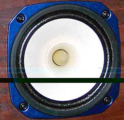

I have a pair of 166, I would like to build the stock BHL enclosure on the Fostex Web site. What do you think about the harshness ?. This is all new to me , will the amp mellow out ?
A horn should help wit the speaker's balance... these are really designed for horns (you'd use the 167 for any other enclosure)... time should also help....i've also gotten good feedback on the addition of a phase plug.
I'll have to get a set of these myself someday and see how some of my mods work.... one thing that you should do is to ductseal the basket -- particularily the basket-magnet junction. Shape the ductseal here to smooth the exit shape of the back of the driver. A wool felt cap on the back of the magnet is also helpful (wrap it around the sides of the magnet and just use an elestic to hold it in place. Another trick is the 98 cent trick/tweak to damp the resonances at the edge of the whizzer & the cavity between the whizzer & the cone (do a search, there have been posts in just the last few days on this. These 3 mods are reversible.
