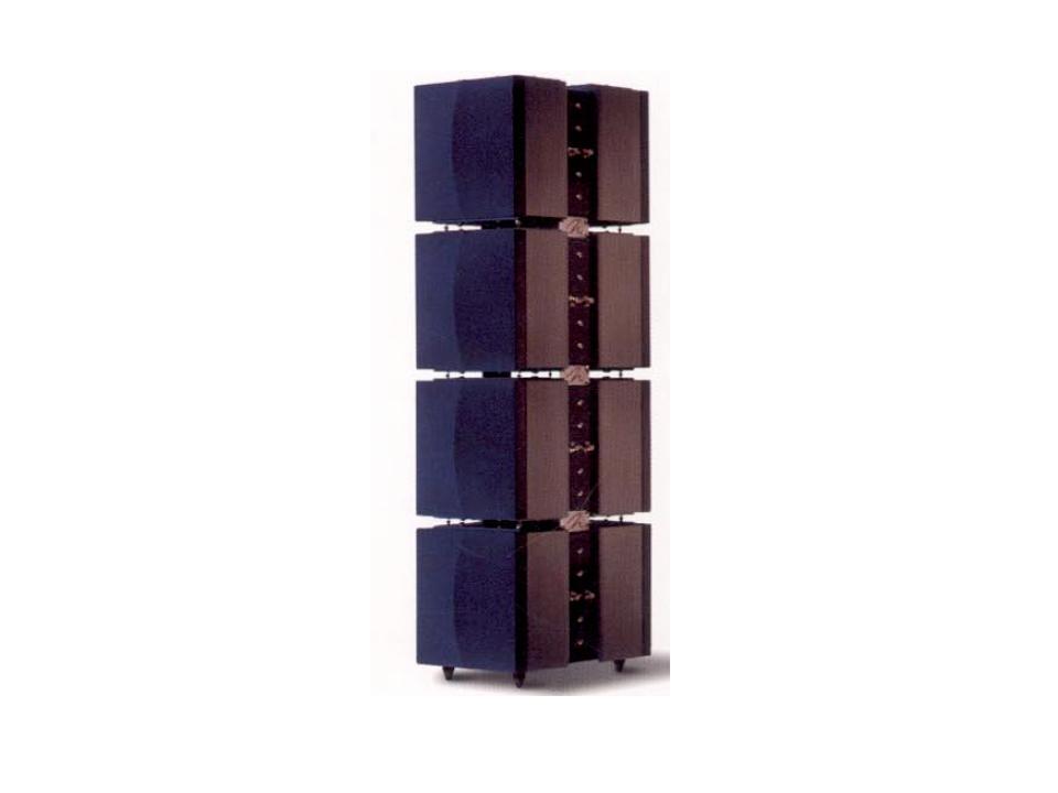

The Martin Logan Statement-2 used several modular woofer boxes which could be stacked and bolted together as a bipole or a dipole or with delay a cardiod bass array. This seems very versatile for line arrays, and the boxes could also be put on the floor around the room as is recommended in the literature to reduce room modes.

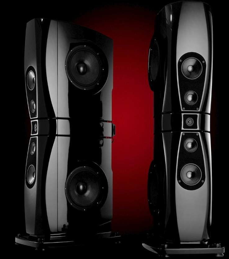

slim baffles are what I had in mind, too, and to have the drivers n the side a la e.g. the Arrakis.
I thought you would like to use'm for movies, and that was why I was wondering about the max SPL at low frequencies.
What I think one would gain by using 15" drivers instead of say 10" ones, is the "weight" of the bass will be more powerful with 15" drivers.
Without a doubt, if they are close to a wall you will get lots of bass nasties from rear firing anything. I am assuming from looking at the design that these subs are to be sealed. If that is the case, lots of EQ will be necessary. (I'm sure that you know that) If you go with the PR idea you will get natural extension via higher moving mass and larger radiating surface. You won't go wrong either way. I think that to blend with what you have already you would be better off with the EQ'd sealed system.
About radiation in the boxes, I think you are spot on there as well. You could but active drivers in the top and bottom positions, front and rear, with the passives in the center positions front and rear. I bet that you work quite nicely.
