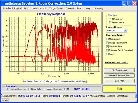

why is the peak of the inverse at about 55 Hz not about +5 dB high? And why is the inverse curve between 100 Hz and 200 Hz not a clear mirror but different ?
And finally why did you cut at 15 kHz? How does the TRUE inverse look to the original pulse?

Ths slight mismatch you point out is because the pulse wasn't totally at rest by the end.
The limitations at the extremes are deliberate. Silence cannot be inverted. But there's no difference between a smoothed and unsmoothed response there.
Edit: New inversion added.

But please note that the numerical integration is not a smoothing method.

An unsmoothed measurement can be inversed.
All I think was being said here is that it's mathematically possible to do this. Which of course it is. But due to the shocking lack of spatial robustness, I don't think you'll find anybody recommending it as a viable form of correction.
With a given amplitude response it is easy to create a linear phase filter.

Inversion of an unsmoothed response:
Ok, I know that! lol.
I can do that easily too with even better curves compared to the shown example. But have you really tried to create an inversion of an unsmoothed curve without any tricky treatment (like minphase and cutting at the upper and lower frequency range)? And please: the amplitude response is not so important, how does the pulse response look like then and is it useable?
Honestly speaking I wonder why many scientific papers speak about poles and zeroes and division by zero.
