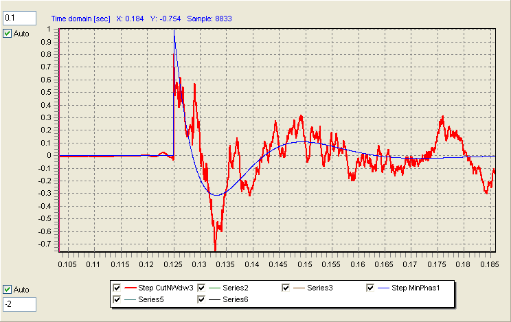

Shown is the behaviour of a B&W 801 D speaker before and after optimization by FIR filter with minphase and excessphase correction (filter size 65536 taps).
So first: Amplitude response shown

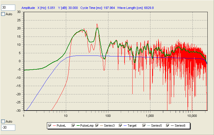

Do you have a 6th octave smoothed one to post? Good you follow a slope.
No, I do not have a 6th octave smoothed curve as I do not use this kind of smoothing. Appended a picture of the unsmoothed amplitude response (red), treated by a psychoacoustic calculation and then by a frequency depandant windowing (in this case the width is 15 cycles, this means e.g. 150 ms at 100 Hz, 15 ms at 1 kHz and 1.5 ms at 10 kHz) [green curve]
Anyway you see that the curve does is not influenced by the dips.
Also shown is the target (blue).
Hope this helps
Uli

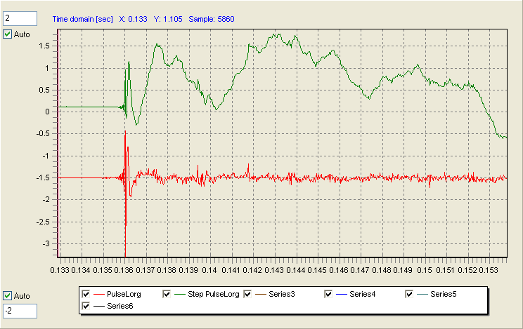

That would be a good impulse response to get if you'd taken it in a very large anechoic chamber, let alone an average untreated room.
Please note that the shown picture is a step response which shows the integral of the pulse response.
Appended a comparison of pulse response (red) and step response (green) in one picture.
You can see that reflections in the pulse response are in a way smoothed by the integration.
So it is always necessary to clearly tell what a curve shows.
Uli
Hope this helps
Uli
Yes that shows it quite nicely. I like your target slope, it correlates very well with many subjective findings for far-field response.

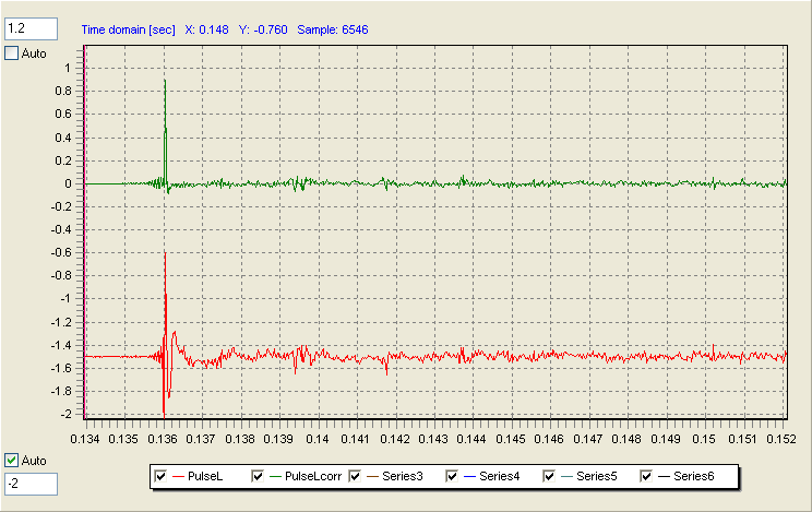

Also, do you happen to have a plot of a corrected impulse response? That would be interesting to see.

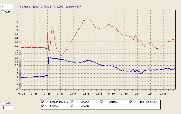

Since you used a log-swept-sine as the source I take it you generated the impulse response by deconvolving the measured response with the swept-sine input? And then, as you say, integrated that to get the step response?
Yes, I compute the pulse response by deconvolution. For advantages of this method see http://saturn5.com/~jwb/mueller.pdf and http://pcfarina.eng.unipr.it/Public/Papers/134-AES00.PDF
The step response is the integration of the pulse response.
But please note that the numerical integration is not a smoothing method. It generates a smoother curve but the curve is different than the original one. You can e.g. similarly look at the graph of speed and position with position = integral of speed.
Appended a comparison of the original pulse (red) with the corrected pulse (green)

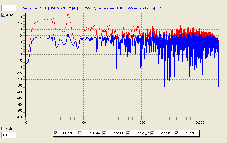

You have to know that of course the inversion of an unsmoothed curve is simply not possible
An unsmoothed measurement can be inversed. Not that it is recommendable for room correction, but it is a sign of a robust inversion which is always a good thing.
