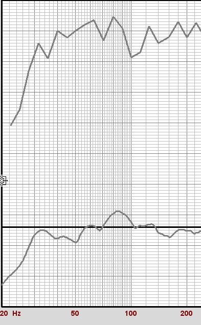

The sub driven alone, here. The PHL receives a 6db roll off under 200Hz and its in sealed box too.
Underside, with mean level line, the total response with PHL in. One division = 1dB.
I knew that from the start, because that room gain is my room gain. And I don't predict tarantism I just say things are brighter than initially looking and a dipole monster sub with dsp is only one evening woodwork for our thread host.
Small room with a monsterous modal gain between 30-40 Hz? 😉 In fact it COULD be similar to Shin's - don't know.
What likely won't be the same is the driver compliance - remember he said flat to 130 Hz (which implies a reduction in spl below that). I'm guessing he spec.ed to Per more extension, as a result he has a lot less spl-level in the midbass then you have.
I had a similar result for the 9" ATC in a 50ltr enclosure.
In 4pi space I was getting a hump of nearly 15dB between 30 and 40hz. After EQ'ing flat I had a response with a virtually flat(no rolloff) response between 30 and 45hz. The 30hz figure was -6dB. Still fairly low output though despite initially looking impressive for what it was (sealed 50ltr, Q=0.5).
