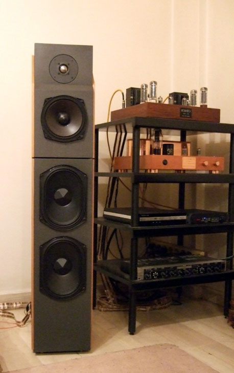

I would not worry in your case. If its gonna reach 37 -3dB in room, its gonna be fast, strong and accurate sealed box premium bass. Its better to have a controlled LF non extra bulky speaker and and you can always augment it with an active monster sub with DSP so to even out room modes for the 10% of music that has pressure down below 35 only if you have the big room to really reproduce it. If you dont have over 50 SQM the 25-35 territory is looking for trouble IMHO.
I use double 6X9 woofs in my latest speaker (sealed) and I am very happy with the quality over quantity gain that affects the midrange positively too. No boom. Imagine that the Watt & Puppy system 7 does only 50! Its the SPL and quality over quantity.

salas said:I would not worry in your case. If its gonna reach 37 -3dB in room, its gonna be fast, strong and accurate sealed box premium bass. Its better to have a controlled LF non extra bulky speaker and and you can always augment it with an active monster sub with DSP so to even out room modes for the 10% of music that has pressure down below 35 only if you have the big room to really reproduce it. If you dont have over 50 SQM the 25-35 territory is looking for trouble IMHO.
Nice work on those Salas, very tidy looking.

Puppy isn't normal reflex, Tarantism is sealed and its going to lift nicely along room gain curve. Better stuff and 10Hz at least lower probably.
''EDIT: What drivers are those that you used Salas? I can see a PHL mid and what looks to be Tangband 6x9's but the tweeter I'm not familiar with. I'm temped to say its a Vifa or maybe Peerless but thats just a guess.''
Tangbands till 200Hz just with a coil (they trail off mechanically a lot), PHL 1220 (1 pole & 2pole filter), Audax A20 (3 pole filter) Telar pole piece ND magnet, but with a 4 Ohm diaphragm from another model because the speaker is 94dB / 6 Ohm.

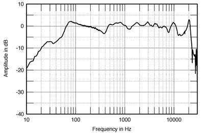

See what happened in my case. One speaker graphs, stereo pair couples further under 50Hz.
First graph is anechoic prediction, and small room gain without nodes prediction. 2 x 8inch equivalent 6x9 in 26litres sealed common volume.
Second graph is what I measured (single speaker 1.3m tweeter axis).

salas said:See what happened in my case. One speaker graphs, stereo pair couples further under 50Hz.
To the model:
First - the room gain is off (+8db) at 50 Hz? Without a gain mode it will only do that in very small reflective spaces, and the lower freq.s will suffer.
Second - of course the model depends on system compliance (..more so nearing in-box resonance).
To the measurement:
First - note that the drivers are not separated, and that they are coupled fairly close to the floor.
Second - What kind of amplification are you using? How low in freq. do the PHL mids go (whats the crossover freq. and slope)? Where are the modes for your room located? The response at 20 Hz looks fairly correct, but everything else looks a little "hinky" without factoring in some of these issues. And note that some of these issues may be very different for Shin.
Third - nice!

There's a history of modelled discrepancies. It just the complicated nature of bass within a room.
The most spectacular that I've seen is the XLS10 in an 18ltr sealed enclosure. Modelled it looks aweful, in room I've seen it flat down to 16hz in some cases and most often in the low 20's.
There's NO EQ applied to this response:
I trust modelled bass predictions less than I do with the stuff over 200hz which are much more accurate.
