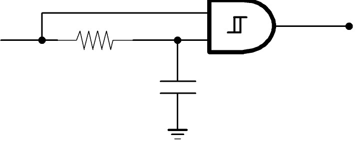

Pafi, you are right, but there is no reliable way to control dead time.
Tekko: Any overlapping must be avoided, you are going to need 100ns or 200ns of dead time to compensate for any overlap and for gate discharge times and to allow for resonant operation at low speaker currents (highly desirable). You may obtain that by inserting RCD networks between the TL494 and the IR2010.
Yes Tekko, that seems like PWM. Concerning the RCD network, imagine a capacitor charged through a resistor and discharged through a diode. That produces a long time constant for half the edges and a short time constant for the other half.
Another good approach is the one show by Ouroboros.

I start to think about skipping tl494 (actually its KA7500B i have) alltogether and just make one of these: http://www.4qdtec.com/pwmmod.html
