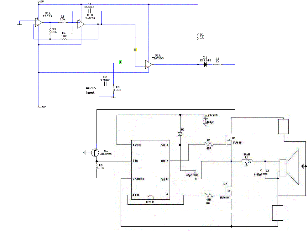

I have done some scope checks on the amp and its almost completely free from ringing, despite not having a single bypass cap, only the lytics.
Either way this amp is way cleaner than the other one with the TL494.
I designed it for subwoofer use so with fullrange speakers theres a faint beep that sound like 5khz or so, not visible on scope due to the sinewave @ 2v around 300khz.
As a sub amp it has enough power to bottom out my 2ohm sub, and it clips mutch better than the TL494 thing.

What is your supply voltage?
Could you post the "final" schematic?

As i recall yours was on protoboard too, hows the ringing and over/under-shoot, ever checked ?
My amp despite no bypass caps near the ic´s is very close to clean, almost no riging at all.
Tekko, what is your switching frequency?
If your output filter is optimised for 2 Ohm the cap should be 4.7 uF rather than 0.47 .. that would correspond to corner freq of 25 kHz. Try this LC designer
Altering to full range should be easy, by just changing the sawtooth freq.

Its running at the highest freq TL074 allows, dunno what the freq is tho. I don´t have a freq meter.
The op filter cap is 1µF, not 0.47. The amp is not designed for any special output load.

You should make sure that the switching frequency is well above the filter corner freq. which is of course dependant of the load.
