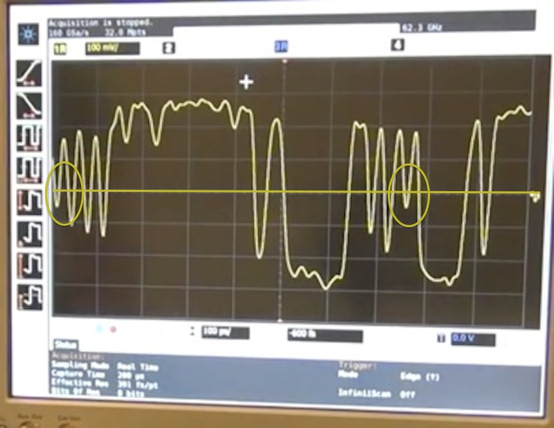

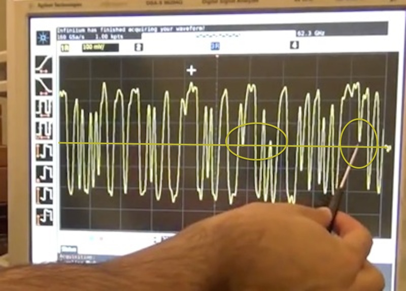

The idea that there is some kind of digital signal being transferred by any cable is just as erronius as the idea that the manipulation of digital data in a CPU (made of transistors, resistors, capacitors, pathways) or a memory chip is a digital signal. It's digital *data* but the electronic signals are AC analog, they only *represent* digital data.
So, regardless of your position, or your experience, with regard to digital transmission via cable, you must acknowledge that a simple 16/44 file via USB is a square wave at almost 45 KHz. Square waves can also be mathematically described as a series of sine waves whose harmonics are at ever higher frequencies to the fundamental overlaid on top of each other with integrity in the time domain. So this is not your 20Khz analog cable, or even your 45KHz analog cable.
Higher resolutions mean higher frequency AC signals, and in every case they must be properly transmitted and "understood" by the receiving system which will process each and every bit via an analog circuit.
With sufficient resolution (using a GHz scope) errors in USB cables are easily discerned. Two examples reproduced below: highlighted areas indicate where a change from a digital one or zero to the opposite polarity fails to make it sufficiently across the zero-crossing point to be identified as such by any downstream device. The images are a measure of a USB cable from a Digital Frequency Generator to the Scope at 16/44 resolution.
Fine. So you'll have errors in the data and your USB link will likely fail - depending on where the errors occur in the USB data stream - or at least your audio will sound clearly wrong.
This only really happens due to interference or USB cables that are too long.
Also, isn't the data rate going to be a lot higher than the 45kHz figure stated - assuming a 'Stereo' signal transmitted - each of L/R running at 44.1kHz with 16 bits encoded plus all the other stuff that goes on the USB protocol. Gets you into MHz figures.

Since it is trivially easy to send billions of bits across USB cables without the loss or error of even one bit, not one part in a billion - the only arguments left are jitter and noise. Bit perfect is easy.
Jitter and noise are not difficult to measure in the analog output signal from the DAC. You can see them in an FFT analysis. If they aren't getting thru the DAC, it doesn't matter. Well, it doesn't matter for those of us who listen to the resulting analog signal. For those of you who listen directly to the USB bitstream, then it could make a difference. 😉
If you can see noise and jitter in the FFT, fix it. We do have the tools to figure this out, right?

Well, I'd have to do some searching for the original video where the screen grabs came from (a test of the 'scope) but the cable looked to be about a half meter.
Bear in mind that at USB signal speeds (MHz not kHz) you need to take into account appropriate Signal impedances and termination. Otherwise you are likely to get signal reflections which will interfere with signal propogation and compromise the signal integrity.
I'd suggest probing on the output of a USB receiver, or at least a properly terminated buffer if using sig gen rather than USB signal. Thus looking at a properly terminated signal.
I'm pretty sure that someone to whom Tek decides to lend a 50 GHz scope to for review knows how to properly terminate his test setup.
I've got a lot of high falutin test equipment at work that we're encouraged to use (academic). Give me half a chance and I'll give you a screwed up measurement any time of day on stuff I don't know how to use properly. 😉
Just saying that it's not a guarantee. But we do hope you're right. In any case, we don't know how those traces were generated from your post.
