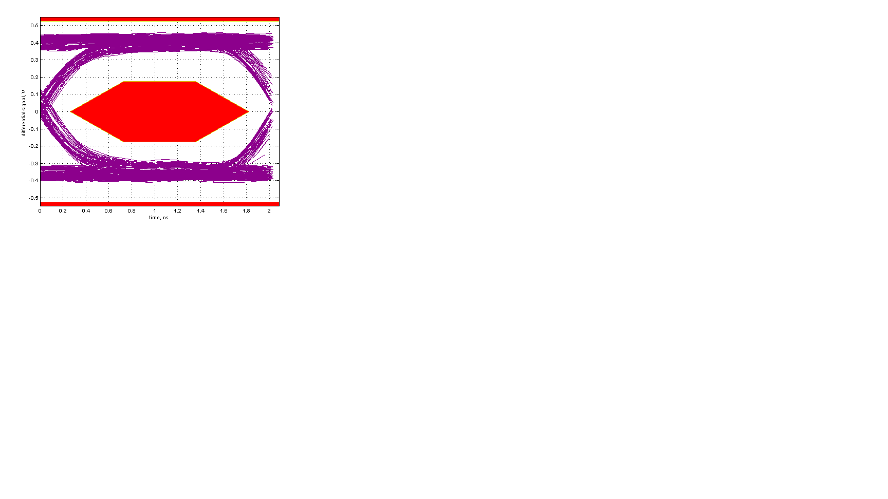

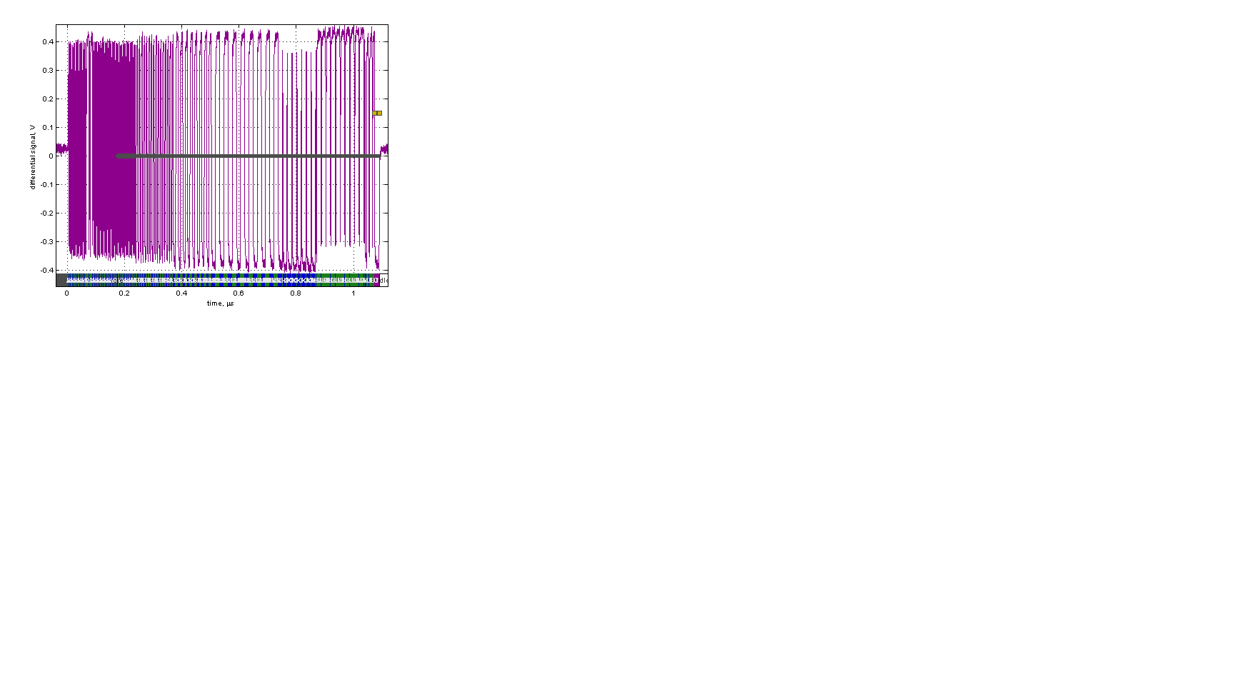

As promised.
The reference of the DRAKA (Prysmian Group) is F 4709-17.
Test equipment:
- 2GHz Oscilloscope 10GS/s WAVERUNNER 204Xi LECROY
- Active Differential Probe WL300 LECROY
- USB Test Fixture TF-USB LECROY
According USB-IF compliance program (http://www.usb.org/developers/compliance/):
--> Overall result: pass!
- Signal eye: eye passes
- EOP width: 7.89 bits: EOP width passes
- Measured signaling rate: 480.0834 MHz: signal rate passes
- Rising Edge Rate: 1005.11 V/us (636.74 ps equivalent risetime): passes
- Falling Edge Rate: 974.79 V/us (656.55 ps equivalent risetime): passes
- Consecutive jitter range: -81.928 ps to 131.408 ps, RMS jitter 49.613 ps
- Paired JK jitter range: -55.155 ps to 59.024 ps, RMS jitter 16.807 ps
- Paired KJ jitter range: -65.229 ps to 61.868 ps, RMS jitter 16.529 ps
Images attached.
ESD protection is RCLAMP0502N.
EMI CMC is DLW21S.
JP

Nice, I have used that same common-mode choke on a USB interface (different ESD protection though). They are missing from many audio designs.
