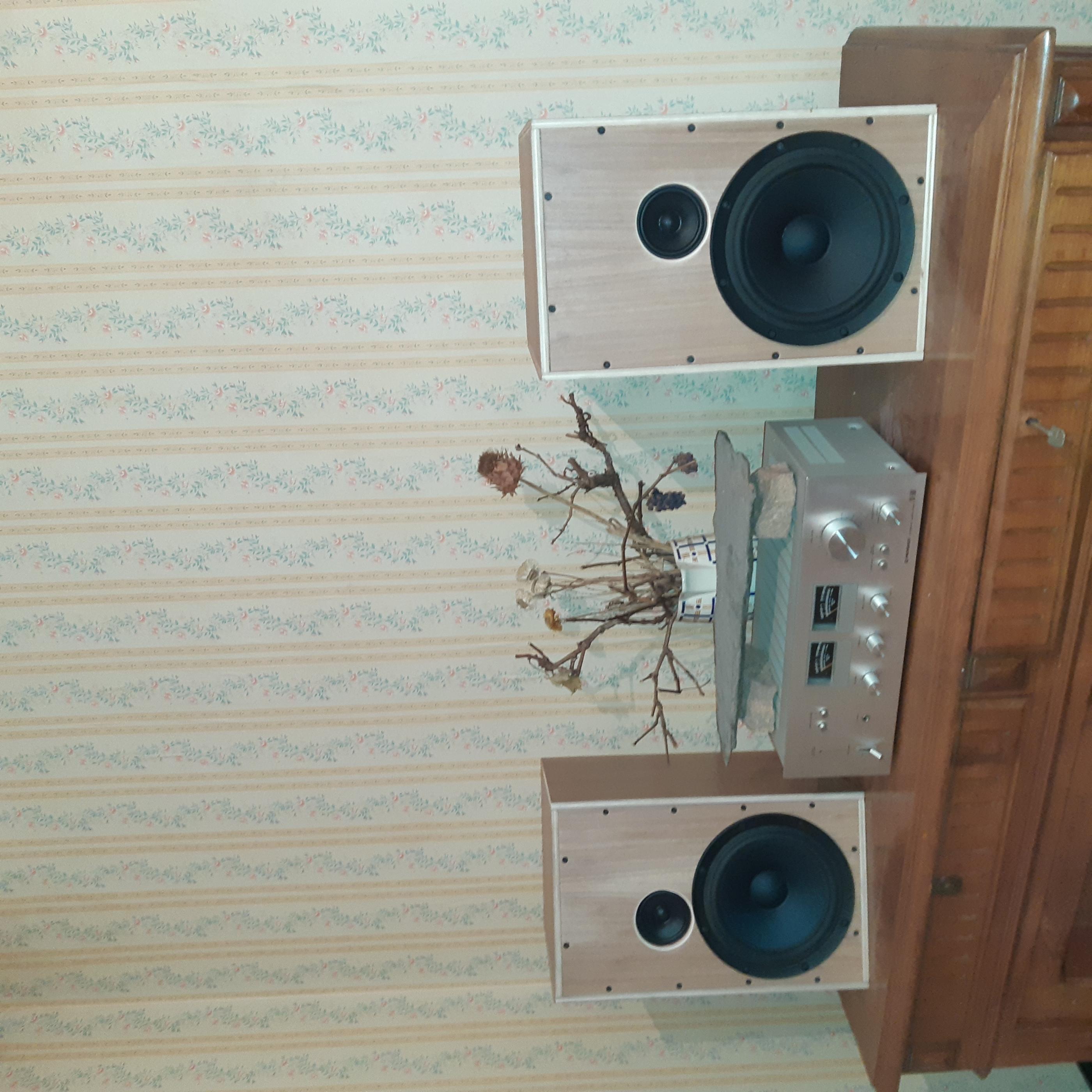

my everyday loudspeaker has a 4th order tweeter on a second order mid... and I like it very much (tweeter with reversed polarity)
But on that casual design which is a also a first for me, I don't want to spend too much money... find it already expensive and much more than a good second hand, although I am making it for fun and to learn from also a listening try & error perspective.🙄 4th order is expensive on parts with passive filters. I hesitated with the super tweeter cut-off very high, leting the 10F full range in the highs without low pass with a super tweeter. Seems it's a bad idea !
I try to stay with not very much expensive parts - I already had the SS 10F- and cabinetry -I chose already veneered ply for instance that you can see in the picture-
Yes I like Tolvan tools. Do you know please, if in the Edge when you enter the diameter of the driver if it is the full diameter size with the metal frame or the diameter of the cone with half of the surrounds, i.e. the radiating area ?
cool, that's what I enter in the Edge🙂 .... the bafle is 28 cm width and the mid is around 11 cm from the first horizontal edge...
