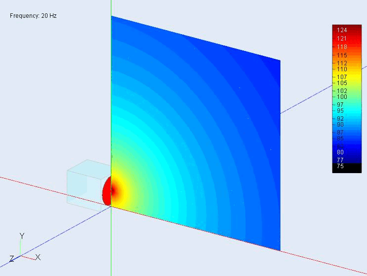

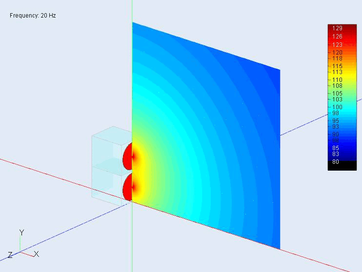

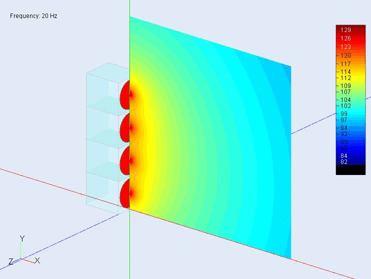

Some food for thought for @eriksquires on how the driver fields interact. These animated GIFs are BEM observation fields for 30cm piston driver(s), stacked and sitting on the floor (IB). The observation freq is indicated in the upper left of the pic.

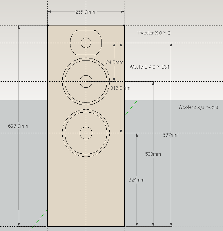

@Bmsluite Not a proposed design, but could be. 2x 6.5" and truncated dayton tweet
Just a example how I cheat make things easy for setting up your sim.
Basically all the work done, just to sim real quick from a old drawing I dug up.
I make a simple cad drawing, So I can arrange everything in the diffraction tool for drivers positions/baffle
Then know center to center distance to enter in X,Y all in a line so only Y
Tweeter is " listening position" so can start at 0, 0 for X,Y
In diffraction tool set drivers to those positions, with mic centered on each driver, export as full space vertical, horizontal off axis.
Then to get right phase, enter Y in crossover driver tap.
In crossover tap open 3 drivers, when your using diffraction tool you can also select " feed speaker"
Highlight the driver in crossover tap you want to " feed" too.
Saves time, hunting for your diffraction tool FRD exports, it just drops them right into the driver FRD
off course as you do each driver make sure you highlight the right driver in the crossover tap.
When I export in diffraction tool I give the name woofer 1 woofer 2 etc etc.
Making sure I didnt screw up the feed, since the FRD file names will a have a reference.
