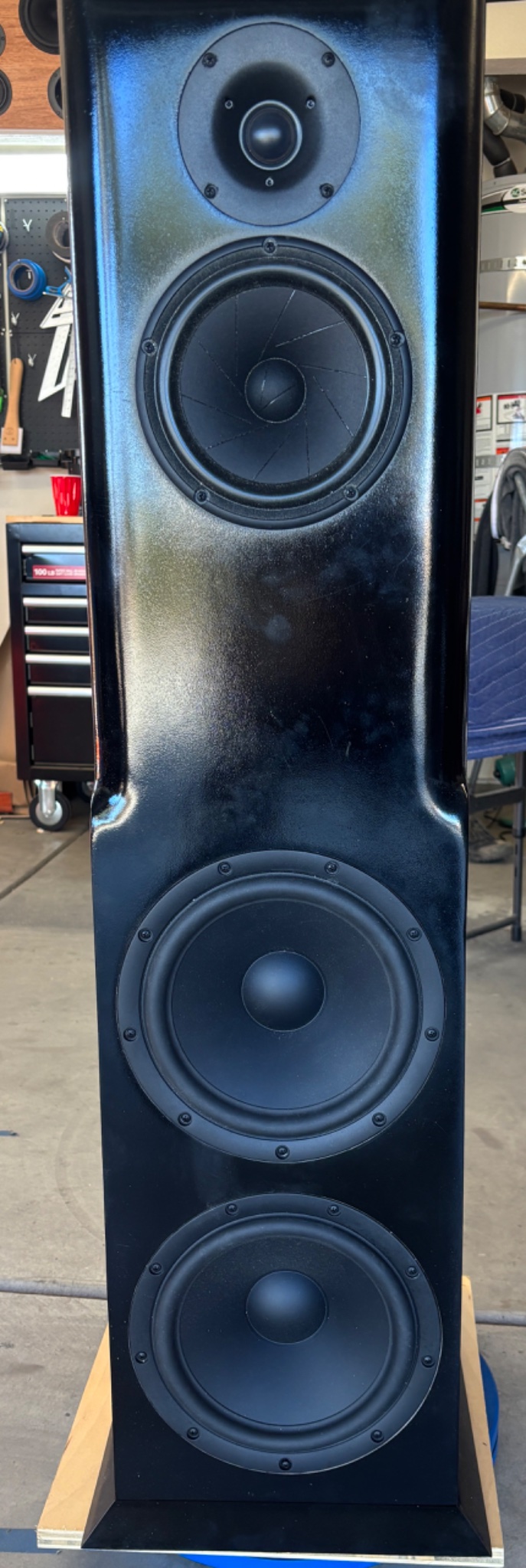

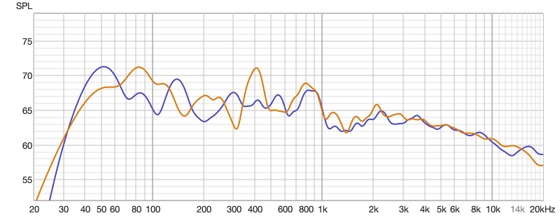

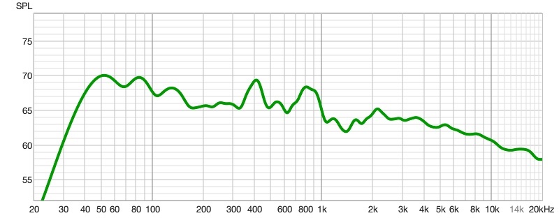

I can't answer all of your questions here but my last build was an attempt to remedy the "floor bounce" problem. The first step is to get the woofers closer to the floor. Yes, there are still problems and complications with this but it's very effective. My woofers are crossed to the mids at 200Hz. It works well. The calculations you're seeing here are useful, but remember you have to also calculate the walls behind and to the sides. It's not just the floor. So having the woofer be the same distance from the floor, the rear wall and/ or the side walls is the worst. You want them to be different distances from all of them.
The result in my highly reflective listening room was a much flatter low end with less drastic dips and problems. The two graphs here show a L and R measurement and the other graph is an average of the two all at the listening position. The average was quite smooth in the low end compared to any other speakers I've had in there.
I also think that the Mofi stuff haws the woofers strategically spaced vertically for just this reason and Andrew Jones did some "mathing" to get the best spacing.
