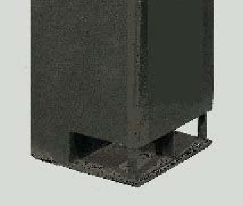

Qi, in the email you've referenced regarding tapering of the Danley sub, was it a positive (increasing CSA) or reverse taper?
Only that it was tapered, and how that contributed to its outstanding performance.
But clearly this pic shows an expanding taper, doesn't it?
It sure looks like it to me...

Qi,
2 things still leave me uncertain. First, your pick is not the terminus of the production model for the upright version. Second, if you look closely in the literature for the production model, the DTS20, the response graphs don't match the extension claims and on those graphs the name is PB12, not DTS20. This leads me to wonder about the possibility of 2 different prototypes, one tapered and one straight, and that the production model is straight. Further support is that using MJK's spreadsheets, tapering shows an earlier roll-off like pictured in the graph, and straight results in deeper extension more like what is claimed with a small sacrifice in efficiency.
Still, Danley is a horn guy, he calls it a tapped horn. and I've never heard of a straight horn.
It's important to me because extension is what I'm after, not 120+db. Modelling longer lines doesn't result in a corresponding increase in LF extension without massive changes in overall cab volume. I hope it's not something like air density that causing almost a brick wall around 18hz, because I'll really get screwed since I live at about 5000ft.
