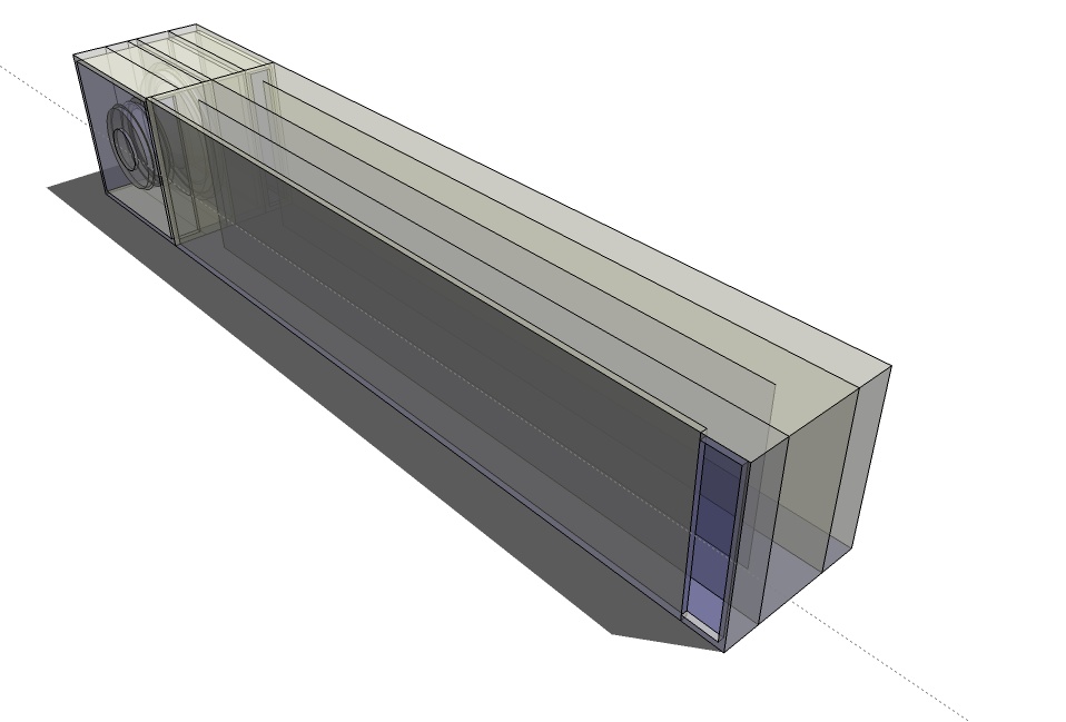

Well, over at Decware audio forums, with the help of John in CR and BassBoy, we came up with an incredibly ingenius way to fit this TL into a box with only 2 pieces of wood to form the 3 folds.
It also happens that by changing the driver's mounting position, we can change from normal end loaded design to jensen transflex loading or TOP loading at 25 and 75% line length.
Here is a picture from sketchup:
The secret is the two baffles that seperate the rectangular internal volume of the box into 4 equal area triangular colums. Then simply cut the baffles in the right spots to fold the line, and whamo bamo.

Well, It is good to see your are making progress, and that you are using Sketchup also!
A comment or two...
Triangulated tLines have been around for decades (by none other than BAILEY)
http://t-linespeakers.org/design/foldings/tttl.html
IMHO, they are not worth the additionall effort.
(the lines are VERY difficult to seal properly)
That said, I really don't see any major differences in what I proposed to you over a month ago?

I guess so now that I look back. Kinda funny. I just skipped over that because at the time the transflex and tapped line geometry weren't really interesting. Over at Decware, it just happened we could make the design so it was easily converted to either type. So why not heh?
I think this triangular line design will be much easier to construct than a multifolded line using the entire width of the box. I mean, I need to only cut 9 pieces of wood. And only 2 of those will have angles. Not to mention I will know exactly where boards are without having to draw out the design, they all meet in the corner.
Also, the line takes up less volume this way, there are only 2 pieces of wood making all the folds.
In any case, John's and your idea to easily convert between layout wills be used, I plan on testing all three geometries with the same driver amp etc.
Actually John was also aware of my renderings / posts regarding this issue.
I am glad my input was of some use here.
Properly sealing a triangulated line is a daunting task so GOOD LUCK!
(if it is not well sealed your results will be "underwhelming")
For maximum bottom-end, go with the driver on the end (no offset), and no stuffing.
(be sure to use a steep XO before the 3d harmonic)
This is what I did and I am not disappointed...

Actually, neither of those designs allows for an easy change for the driver at end of line and the Danley alignment at 25%/75% from the beginning of the line. Your options are limited to end of line or at 50%. The driver needs to be at the other end of the cab for the Danley alignment.
The way to accomplish that is with triangular pathways with panels large enough for interior mounting of the driver. Rectangular pathways to accomplish the same would result in very large CSA's.
I don't understand the point about sealing. If anything the triangular shape would be easier to get into and seal the joints. I always seal joints of any cab with caulking, just to be sure, and ensure plenty of curing time if silicon is used due to the acid released during curing.
Another concern I have with both layouts is that you will need to fill some of the void in those chambers. You don't want to end up with a BR with a very long large port.
If end of line mounting is your primary plan and cab size is important, then rectangular pathways with the driver in the front panel is the way to go. It would be the easiest to fit the basket of the driver, with a spacer on the outside or a hole for the magnet in the interior panel. If you go with the extra hole, leave the nearby endcap off so you can seal around the magnet. The terminus would be in back, but if you wanted it in front, just extent the line around the end of the cab (more efficient than a box for the driver on the end.
Why would I fill the voids? wouldn't that destroy the entire point of the cab? I mena isn't it supposed to be a quarter wave tube?
Sealing triangles will be much easier I feel also.
I plan on leaving the insert (the baffles) sealed together and very tight in the box, but not fastening it to the sides. This way, I can simply pull it out and rotate it 180 degrees to try the TOP.
After testing all three designs, I will seal up and fasten the final build.

Your drawing has a box on the end of a very long port. The excess area of that box needs to be filled or it may not be a TL and just end up a BR with a very long port.
You can turn that plate with the hole however you want, or even use one with the hole cut to flow into another pathway and it still won't be like Danley's TOP sub. Yours is an end of line driver position and to get to a 25%/75% driver position will require the driver to be at other end of the cab.

Yeah, the way it is now traditional driver mounting end loaded is really your only option. If you want to try any other options the box on the top has to go and the driver needs to be mounted in one of the triangles.
It's not entirely necessary to try anything else, as your models look really good the way they are. But John is probably right about making the box on top as small as possible to avoid BR action. Who knows, it might even be better with BR loading at the beginning of the line but it's impossible to model, so probably worth avoiding if possible.

1. Leave both end caps removeable and make different baffle boxes to install on whichever end the alignment requires.
2. Build your cab so driver can be installed on an interior panel. With that magnet size, you'd have to go with a larger CSA, at least 70sqin, and rectangular pathways with the interior panels in a "+" shape. Another problem is that if you end up going with a normal TL, driver outside, it would be off to the side on that widest panel.
3. Forget about end of line mounting (no real benefit anyway), leaving yourself with tapped at 25% or exterior at 25% from closed end. Qi design is probably best for this, but you'd have to fill that extra volume in the driver mounting box. Then just leave the box open on one side and plug the opening to the line on that side, for normal TL operation.
You have 3 options if you want the flexibility of trying the different alignments.
