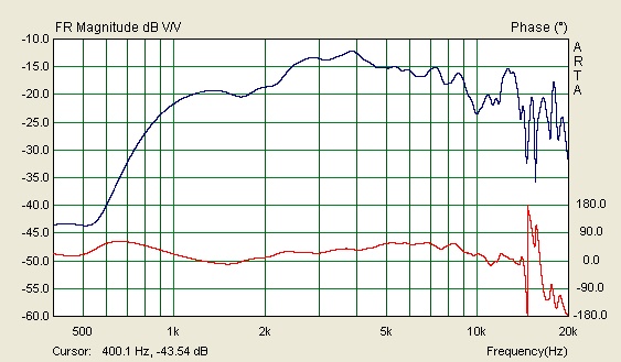

Made some experiments with my tractrix tube (changing the slot a bit, making the whole tube longer with about 4" closed tube at the driver.
This is getting interesting. The measurement is at one point this time, 2m above the tube, 25° to the axis of the tube. I would also say it's louder now...
Smoothing is 1/24oct
I can't believe the phase. If this is correct, it would be awesome. Also the group delay is within 1ms.
