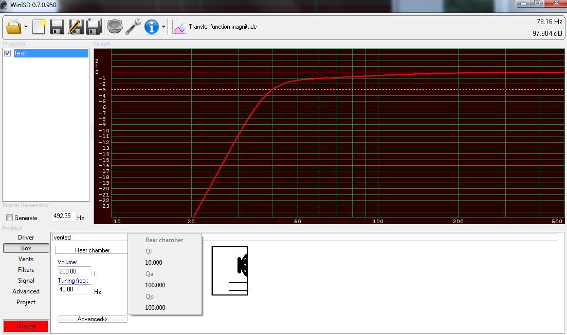

Bagby does have entry for box leakage and stuffing, the others do not.
In WinISD, click on "advanced" below the dialogue box for port tuning frequency to access Q values for overall box losses, (Ql) Absorption (Qa) and port losses (Qp).

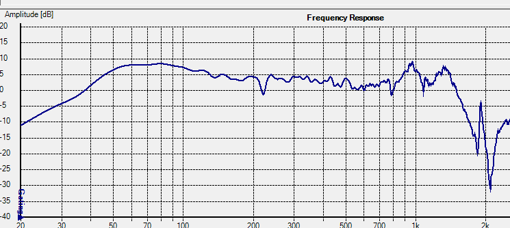

Reality Check
HR Z-Max 40.8 Ohm @ 44.89 Hz It have no Ff or Qtc I could find.
Peak of response, 66 Hz, 89.4 dB. 20 Hz, 73 dB, 200 Hz, 84.5 dB
WinISD
Z-Max 28.9 Ohms @ 45.4 Hz. Fc 47.55 Qtc .622
Peak of response 110 Hz, 89 dB, 20 Hz 72 dB, 200 Hz 87.1 dB
Bagby
Z-Max 33.12 Ohms @ 45.4 Hz Fc 45.55, Qtc .580
Peak response > 100 Hz ( shows flat line) 89 dB 20 Hz 73 dB
Measured
Z-Max 33.9 Ohms @ Fs 44.6 Hz, Qtc .705
See graph for actual acoustic response
Who is correct? None. Who is closest? Well not any of them really. HR on the "hump" center, Bagby on Z max, None of them on HF slope at all believable, though I guess the assumed flat line from Bagby to be closest. So, they are clearly making different assumptions as the T/S parameters are the same. Fc did come pout very close, so I am not going to pull out the old books and try to calculate it by hand. That Qtc was so far off is concerning, but thinking of all the boxes I have built, I cut to a simulated .6 and then try to stuff to .5. Don't always get there and have had to make a bigger box. (RSS265's won't, but my Peerless XLSS did. Little Dayton Rs150's built matched WinISD pretty well)
Fl and Fa, 10, 100. box tested with no leaks.
If anything is to be learned, it is why one must prototype and test. I see so many threads about first time builders with beautiful woodwork and no data.
