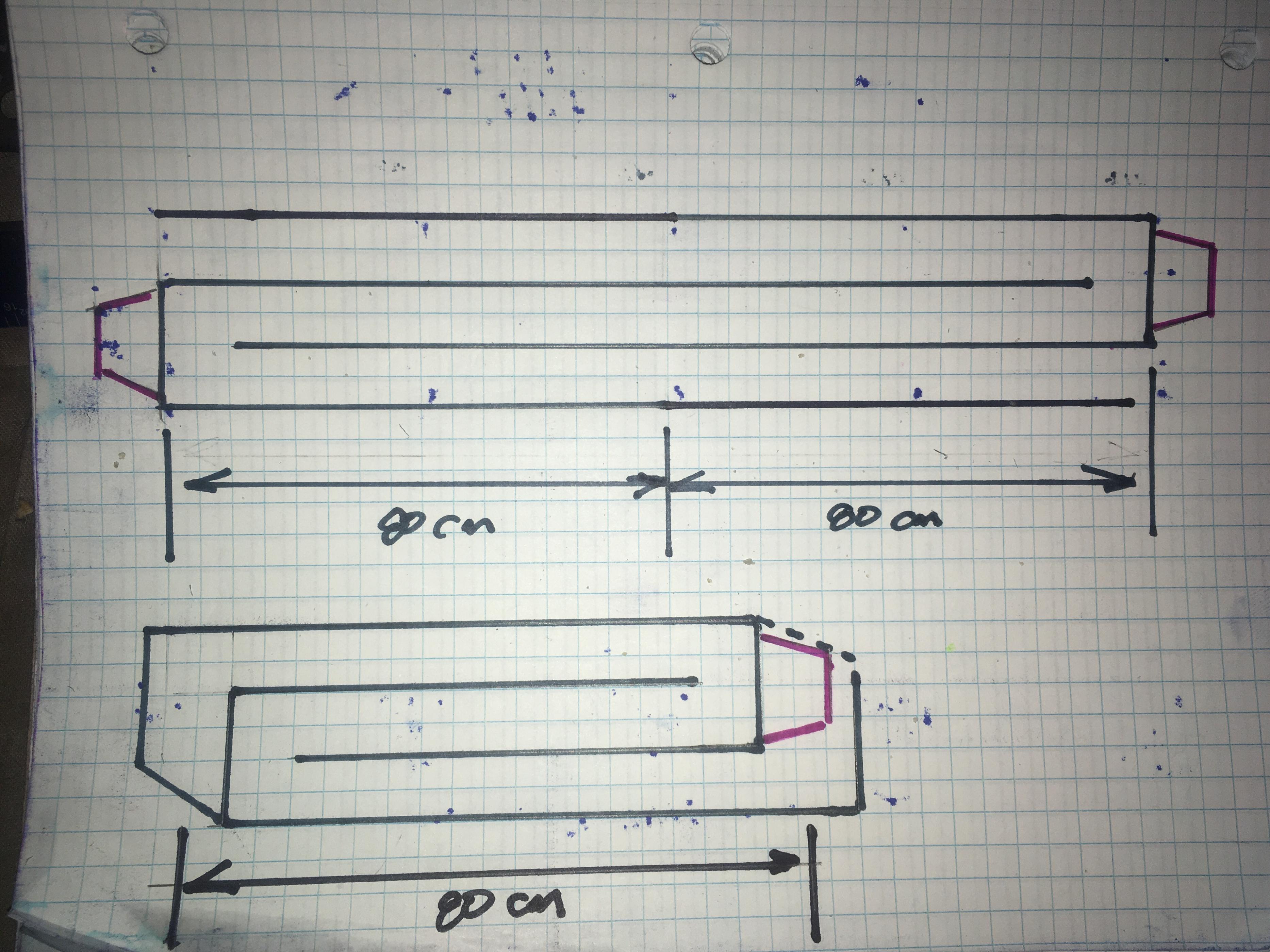

A tapped qw pipe for 960cm is folded 4 times and its 14.3, 17.9, 35.9, 71.6, .....143.2, 214.....1432... hmm this needs more better, True math but spitballing...
