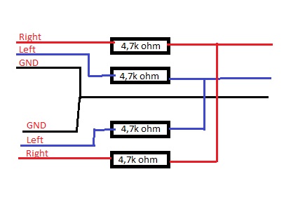

Thanks for the info. I want the switching to be automatic. no knobs to turn or switches to flip. Is this passible with the passive line selector. a how to do guide would be much appreciated. I have a soldering iron but i'm not into electronics 🙂 if I know what parts to do and how to solder them I can manage that. Thanks.
There are several ways to do it
best but most advance would be something like that
Making a passive mixer. (Page 1) - Other Hardware - Forums - ChipMusic.org
But I guess it should be also possible to bridge all GND's and add a 4.7k ohm to each L/R channel and also bridge them after the resistors... Look at attatchment if you don't understand 😉 I'm not 100% sure as I'm also an electronics newbie but I guess it should work well and cost would be <2$

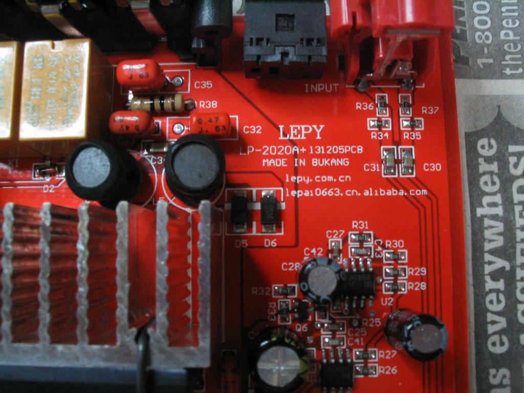

I just received my order from PE, the Lepai LP-2020A+ from ebay with free shipping. If you order direct from PE, you pay shipping. It has a black case and came with a 13.5v/3A wall wart. Leary about using it as I have a 12v/2A wall wart already. I powered it up with no input and it is very quiet. Opened it and it says Lepy on the red pcb. Photos to come tomorrow.

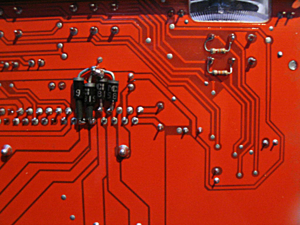

Connected the amp to an ipod and this amp sounds really good. Agree that the tone controls need reworking, but if not at full boost, they help some. I replaced the mis-matched .47uf caps in the output filter. They varied from .43uf to .49uf. I replaced them and matched up some .47uf caps. Removed the ceramic input caps, C31,C30 with 4.7uf film caps that I had on hand. Added a 4700uf to the 2200uf input DC cap. Added 1N5819 diodes on the outputs, just because I had them on hand. They fit nicely on the bottom of the pcb.

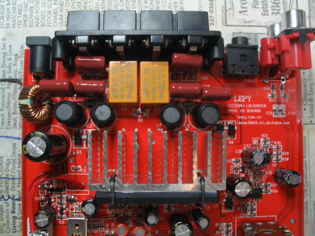

Marked up a schematic with values in RED of what is on my board.
Note that input is different and as close as I could trace, I found that the volume control is across pins 1 and 2 of the opamp, controlling its gain. That explains why people complain about a scratchy control. I did not have that effect, but sprayed it with Deoxit FaderLube as a future precaution.

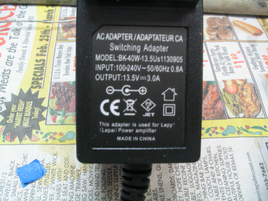

Played amp for a while on my wood cabinet Minimus 7 speakers with 12v/2A PSU and it played very loud at 12 o'clock and clean. Connected the 13.5v/3A PSU and it played clean all the way to 2 o'clock. For my purpose, I am going to stick with the 12v PSU as an extra safety precaution. They vol pot case now has a ground wire to the ground plane on the PCB.
You can play it really too loud with the 13.5v PSU.
I am hoping that someone can come up with a schematic for this LEPY version, although I am not going to mod the tone control circuitry as the small smt parts are to difficult to access. Can't trace out the function of the second opamp.

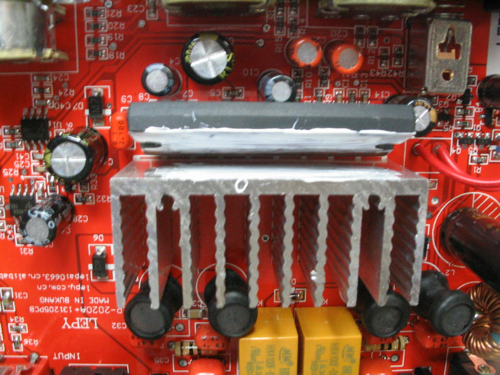

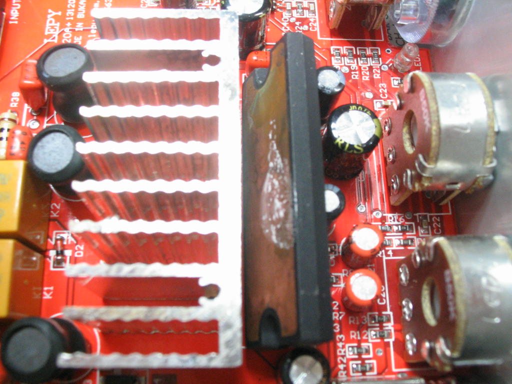

The chip in this amp is the TA-2020-020 by Tripath. Photos of chip with bad thermal past from factory. Relays are in the negative lead of the speaker terminals. They activate in about 3 seconds. The DC offset was 12mv right channel and 18mv left channel. Looks like someone has been reading this forum.
I found that all the solder joints were as good as it gets. No cold joints or bubbles. All shiny.

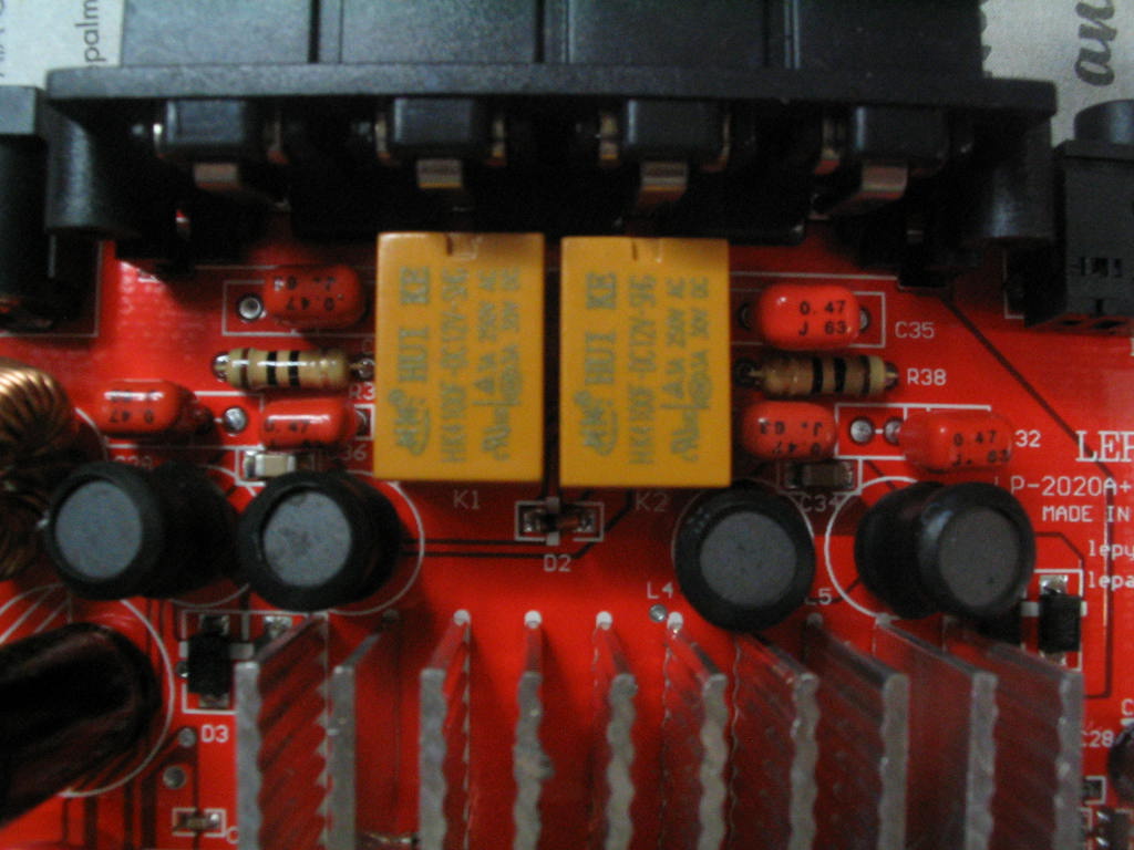

It's nuts that they control the gain with that opamp configuration. This version is nothing like the schematics I've seen posted.
I also removed the 1.5k dropping resistors in the blue LED circuit and used 4.7k in their place. Made the blue dial a little more reasonable to look at.

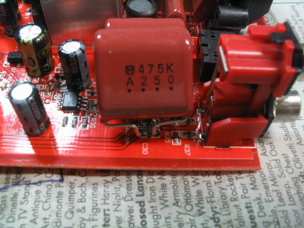

New surface mount caps on C20/C21???
Hi all. been reading...a lot...not sure if I missed my answers above.
1) I opened up my 202A+. Just above where C20 and C21 would go appear to be two surface mount caps. Nothing in the holes for C20/21. (See pic). The amp worked before I dug into it (ruined the opamp pads, will start a new project now that I've practiced on some refuse boards).
Any one else see this? They measure approx. 3uF in the board.
I assume I can remove these and put in replacement caps in the holes. Some one stop me if I'm wrong.
