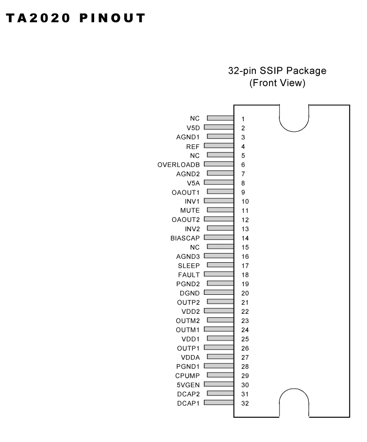

Here is the pinout

I'd say the first test is to see if there is any voltage on the speaker output pins.
You should see very little to no DC voltage between the +/- speaker pins.
Both + and - (red and black) should read about 6V DC to ground if the amp is running.
Normally you should see 1/2 the supply voltage on both speakers terminals, both neg and pos.
Check that first.
I still can't figure out the pin configuration. My board has 4 pins not connected.
Just done testing. Tried to get a reading from the terminals, nothing. So I went along all the pins with the Multi Meter. A picture is worth a thousand words so I made a crude paint document of what each pin is putting out. All the others are not reading voltage. I also tested all the caps following along from the power jack. All give a 12v Reading as does the power supply itself.
If you look at your picture then top left (n/c no connection) is pin 1, the one circled pin 2 etc. So pins 2 and 8 are joined by PCB print. I reckon the chips duff unless there is a standby mode etc. I'd have to see the full circuit to know that and I notice pin 17 is marked sleep... but instinct tells me the chips dead.
OK, from squinting at the picture pin 17 (sleep) seems to go to ground so that means its not used. That reinforces the faulty chip scenario.
If you decide to replace it then its not difficult to remove, but ask first as there are ways and means to do it without damaging the print 🙂
