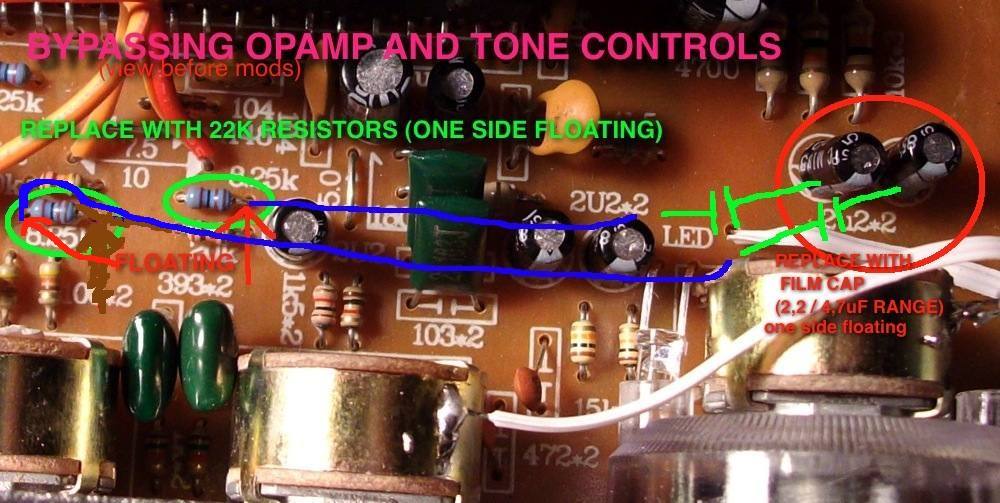

I recently bought a red PCB LP-2020A+, and have been modifying it. I've been documenting each stage, and before I started I reverse engineered the input schematic for everyone. Sometime this weekend I'll started a new thread (as the A+ seems different enough to warrant a new thread).
On the red PCB, there's a mistake in the tone control circuit, a capacitor connected in the wrong place. I'm not sure how much effect it would have (it's only wrong on one channel), and don't really care because I deleted that circuit anyway.
Mod #1: remove tone control op-amp, and resistors connecting it on the input side, leaving the rest of the circuit disconnected on both ends. Replaced volume op-amp with OPA2132.
Mod #2: remove volume control op-amp and capacitors/resistors, rewired volume pot to be just an attenuator, as I seem to never be pushing it above (or even near) a gain of 1, giving a clearer sound and more usable range on the knob.
Mod #3 (today or tomorrow when parts arrive: new caps to replace all electrolytics in the amp. The smaller value ones will be replaced with film caps. New inductors except the power input inductor, as it's already a nice toroidal type. Delete part of the output filter to create a "half filter" per TI documents SLYT198 and SLOA023.

I'm still unsure of what components to change for the tone control defeat. Can't find any info on Lepai in the Wiki and the instructions I've followed from Calamaro differ from others I think. Here's the image he posted from p27, hope he doesn't mind me reposting.

NO inept "tone' controls, Which on the Lepai Must be bypassed for it to use the Ta2020 chip to it's best sound.

When you get a chance, do try the 2.2 (?) uf caps from the inputs to a volume pot to the chip 'mod'. Only 2 caps and a decent pot required.
Deleting the tone nonsense completely, gives pretty nice (best possible imo) results.

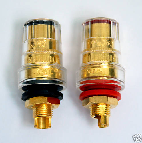

On another note, I can't find decent quality chassis mount binding posts (for use on a metal box). I thought this would be easy, but I can only find cheapo 4mm insulated sockets for chassis mounting. Any ideas (UK preferably)?
They've offered to replace it, but waiting for their return address (said it was from the UK on fleabay, but...). I will insist they pay any shipping of course.
Just search gold speaker binding posts on fleabay, hozepipe 🙂
They are a bit big, not sure they would fit on the back of an LP-2020 case. I certainly wouldn't want to use the bare wire connection to them because of how difficult it would be to turn them in such tight quarters. For banana plugs they would work fine though.
They would be ideal (and yes of course I searched on ebay🙂 ) but aren't these going to short on a metal case? I'm building a new enclosure and wanted to use steel or aluminium. Is it a case of using some insulating collars/grommets or shrinkwrap over the metal sections that pass through the metal case?
The cost starts to add up quickly when you need to buy all the extra bits and bobs (in packs of 10 or 100!) so I just wanted a set of posts that would be ready-insulated. Have I misunderstood something?
