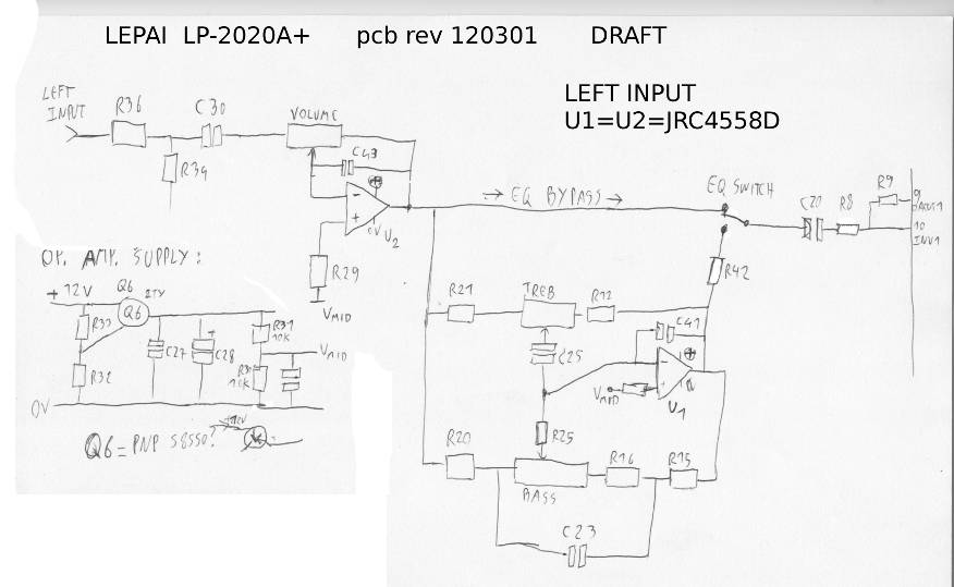

I have started the schematics based on my amp and the picture already posted by Viprz. Very helpful.
The input part, including EQ and preamp is ready. I don't have time to make it clean schematics, if someone has some schematics tool, feel free to copy.
I am not 100% sure that I have not mixed some parts... Seems that ref are matching with Viprz pcb, even if some have moved.
In fact, it is quite interesting, input has been totally redesigned on this PCB. It is clear that 2020 and 2020A+ will sound totally different.
Some comments :
1) Both JRC are powered through Q6. I am not sure of the purpose of this, I have nearly the same voltage on Ic supply and main. any idea ? (Kind of soft start)
2) There is 2 amplification stage : one for main volume, and one for EQ. U2 is for main volume, U1 is for EQ.
3) The "EQ bypass" bypass U1 and the EQ part, and shorten audio path.
4) the volume potentiometer have no pin connected to ground : potentiometer is part of the feedback loop of U2. It make a "long" feedback loop
I have not checked the other parts, but I will attach my first part of the puzzle. Hope it will help.

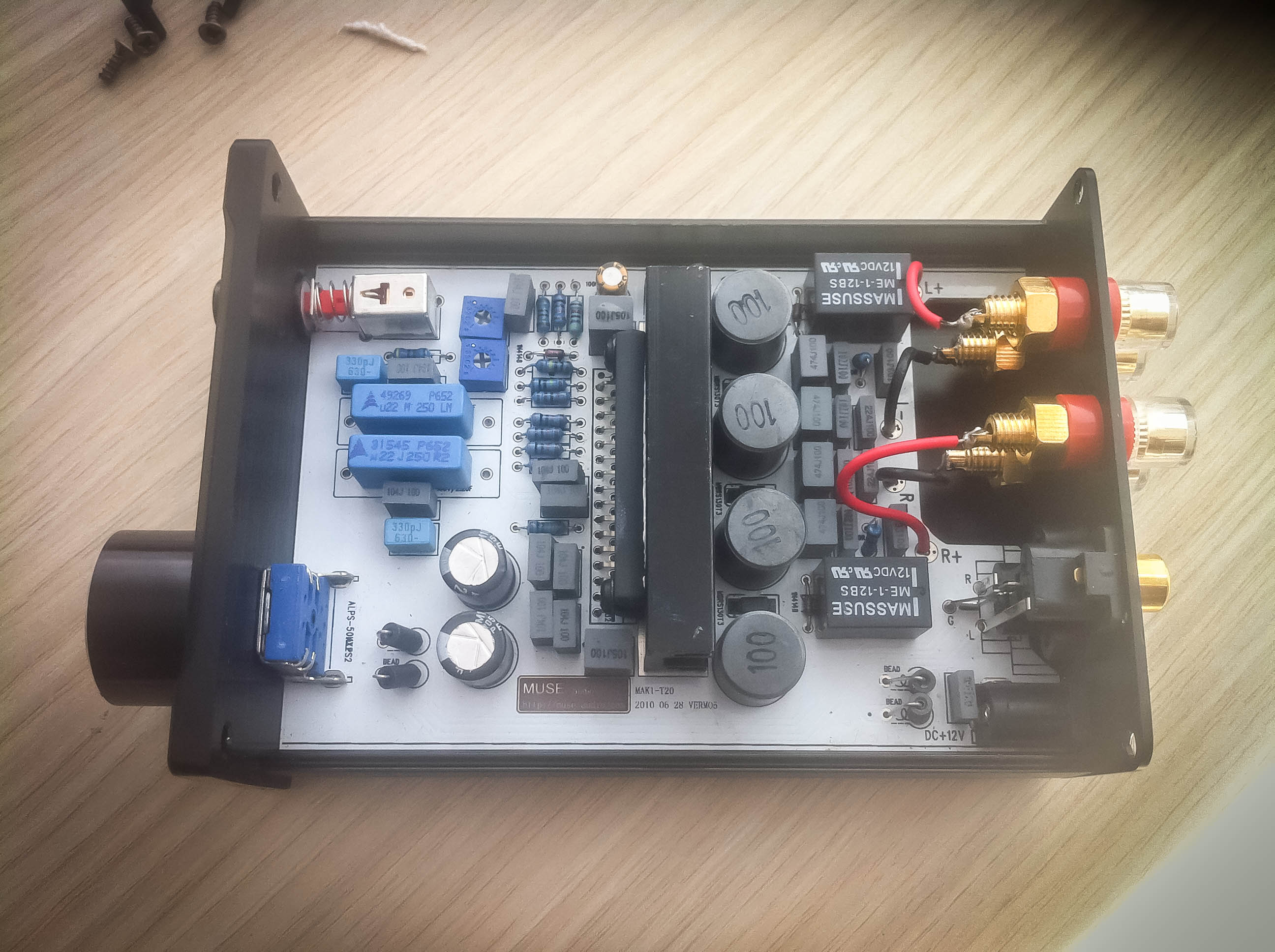

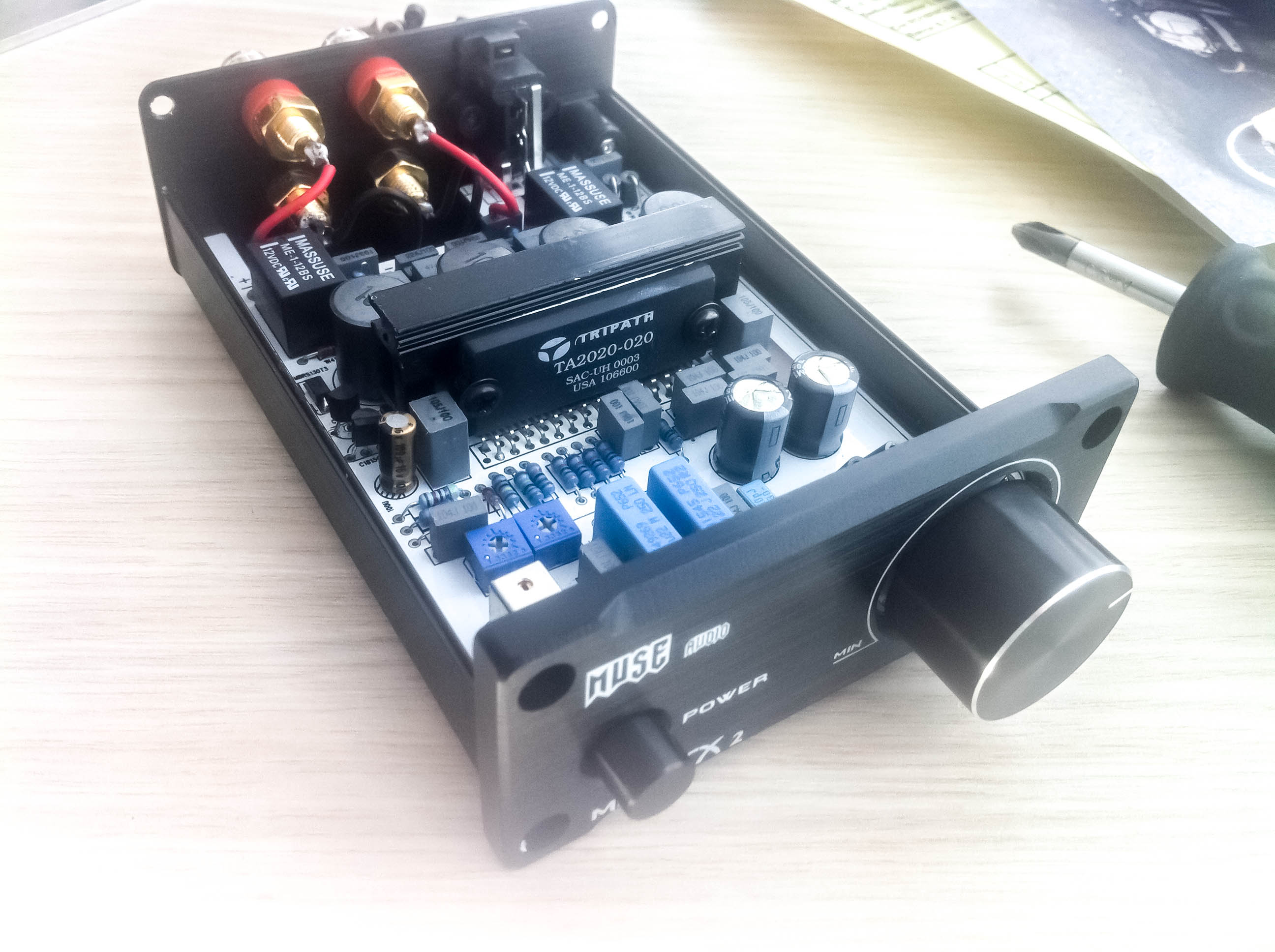

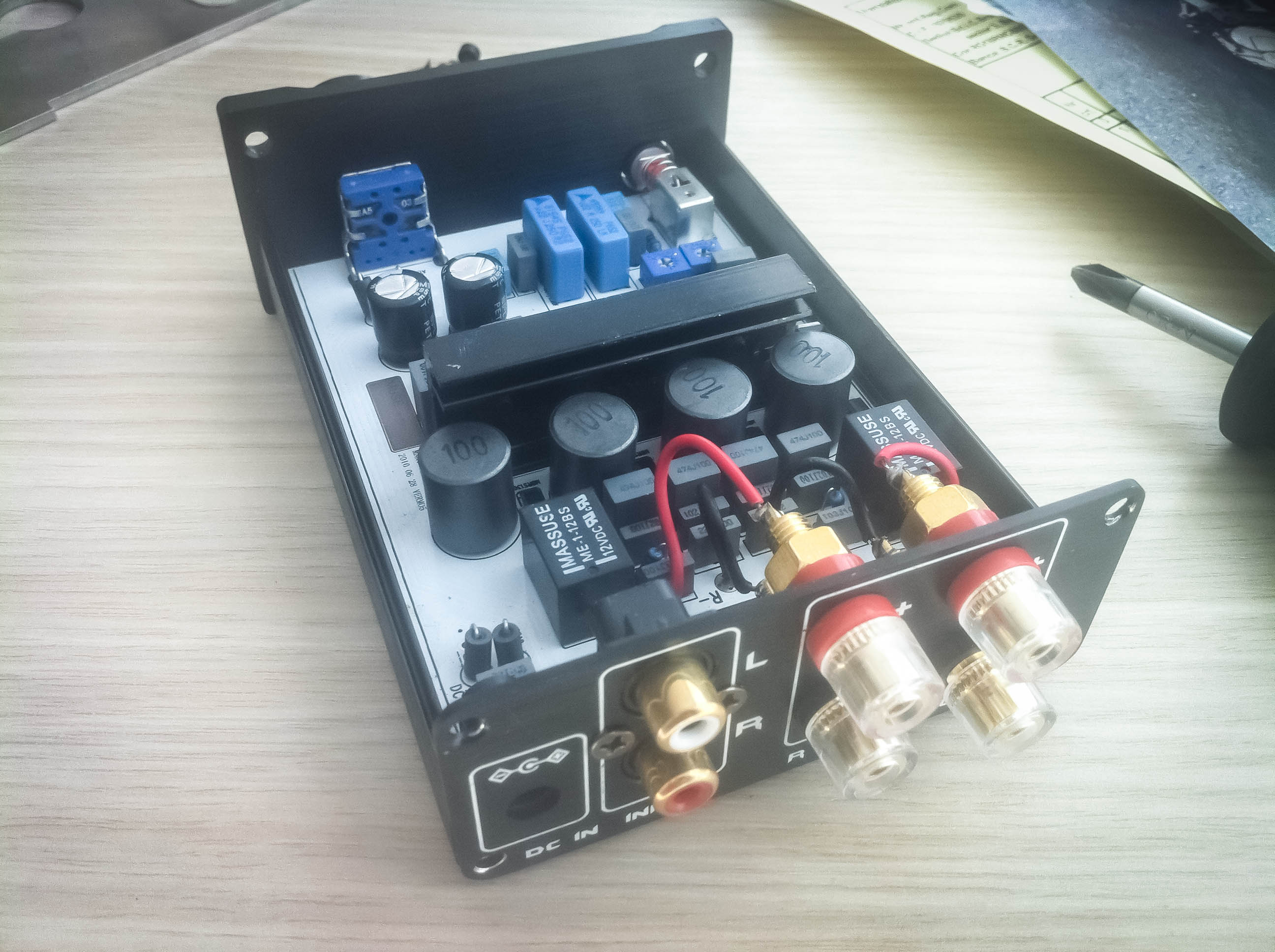

My MUSE M20 EX TA2020 amp just arrived. I opened it and looks nice and clean. I like the quality of the build. It is compact and very solid. Haven't got a chance to test it yet as I need a psu but will do in the next days. I only opened it to check the insides. My only problem is with the soldering, doesn't seem to be really good, some pins are not completely covered in solder. I will have to touch most of them when I'll be making some upgrades to it. Right now I wonder what would the PSU cap be so I can exchange for a larger one. The inductors seem sturdy but I'll replace those as well. What does the 100 on them mean?
The ebay description says that the inductors are Toko fixed inductors. the 100 mark means 10uH so I traced to this datasheet:
A7503AY-100M datasheet(1/1 Pages) TOKO | Fixed Inductors for Digital Audio Amplifier
model A7503AY-100M shielded
But not sure on that. Should I change them with toroidal type? The datasheet rates it for 4.32A.
Also which one is the power cap that is recommended to be changed to at least 4700uF/16V ? The small golden one? I'm asking here since the schematic must be real similar to the Lepai amp.

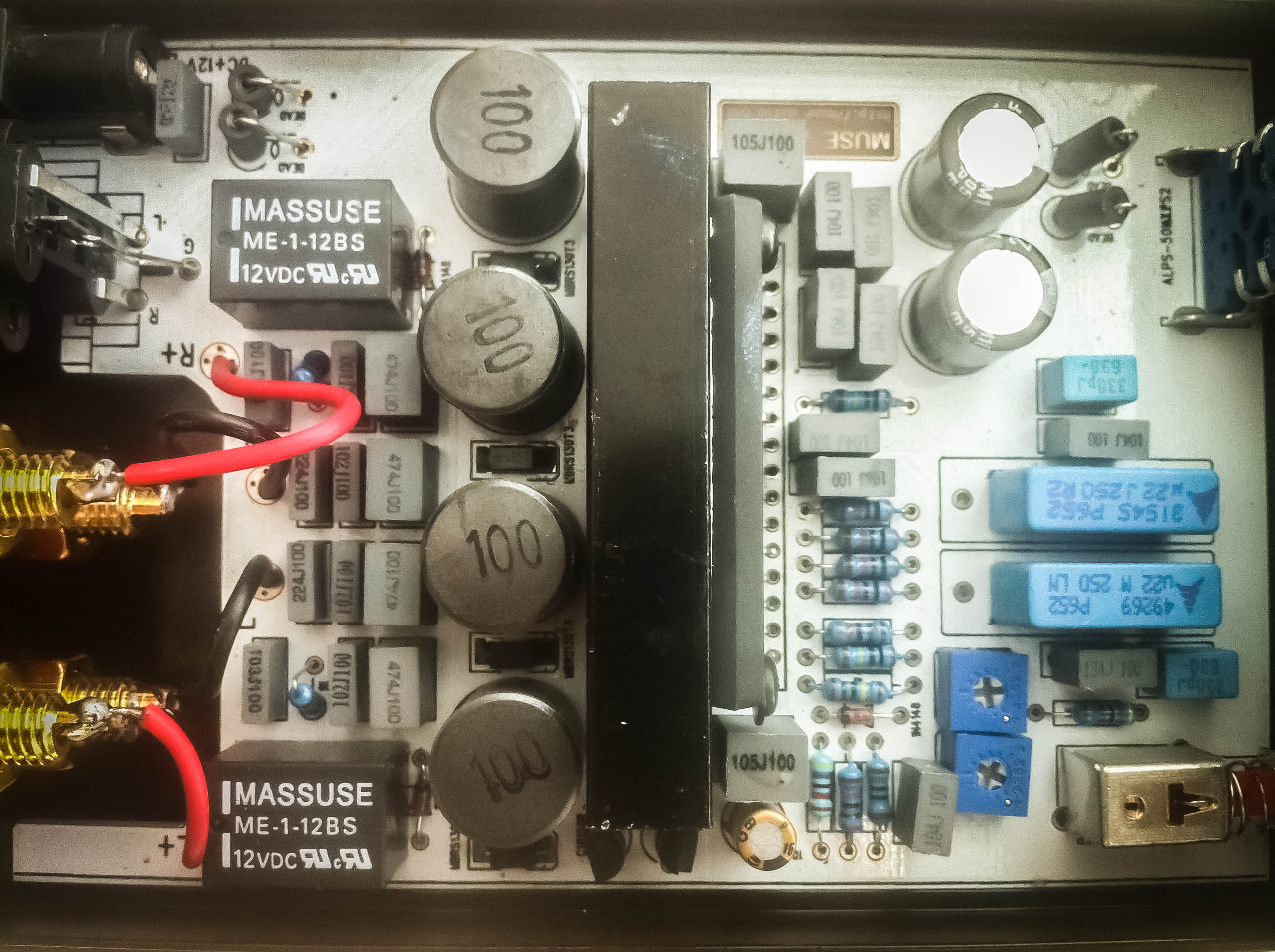

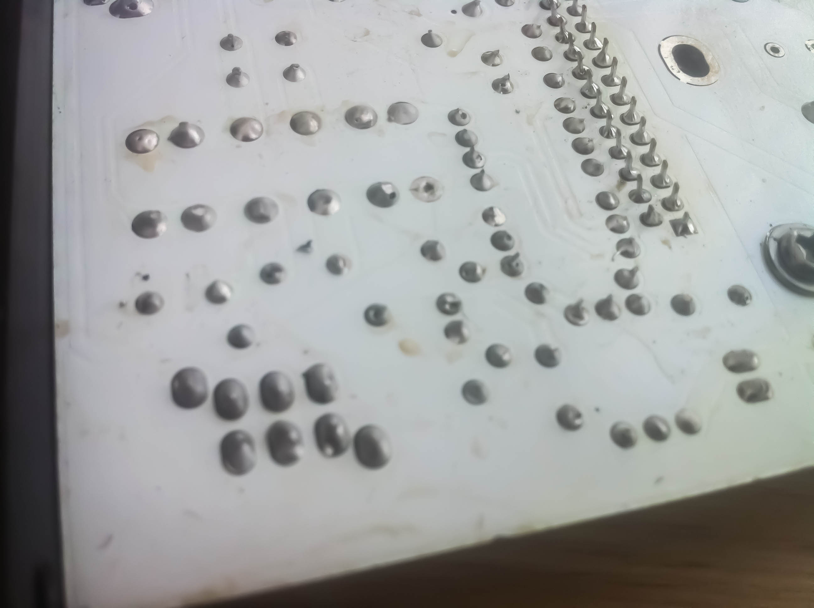

Did Several Mods today to my red PCB Lepai:
Good quality (yellow rectangle) output caps replacing the 047 blue ceramic output ones. Also a pair of 2.2 Film /foils replacing C20/21
Stock inductors .. still
ALL new better quality Caps, 4700/16v on PS as well as a bypass for it.
Have not yet touched the op amps or deleting the tone assemblies/circuits, wanting to get to know the thing modded Before deleting all that stuff.
Tone controls work, not impressively well, but they do work. Likely they will be removed.
Sound is good, Bass is decently deep and sharp when it's needs be 🙂.
No problems there.
Driving 8"full rangers . Volume is to genuine ear hurting levels and no clipping.
These are Old (early 70's) efficient and very pleasing drivers.. which is why I've hung onto to these things for 40 years 🙂.

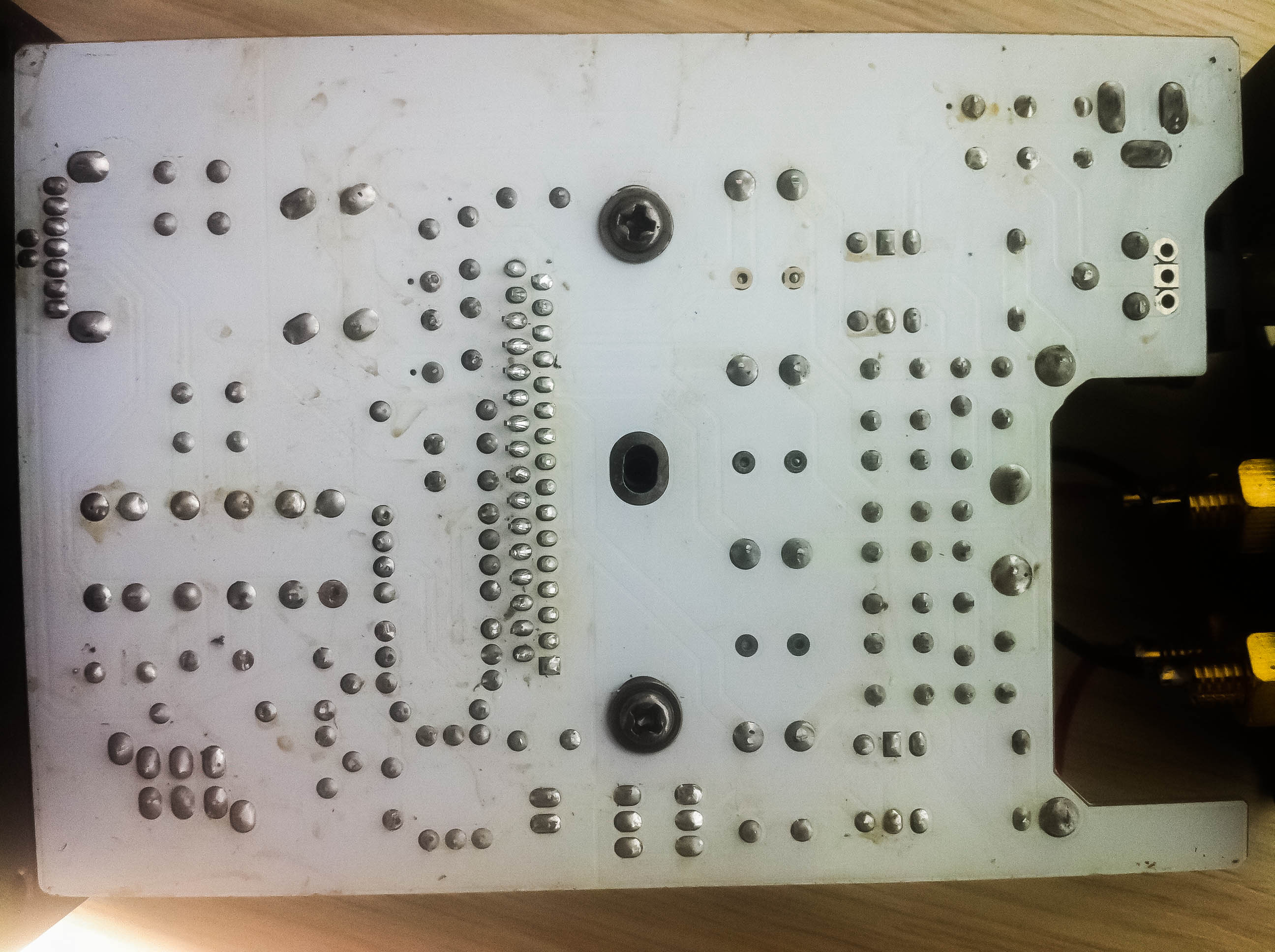

Problem though. I tripped over the left speaker wire ripping it out of the cheesy lepai speaker clips. BUT now the thing is ONLY running on right channel. Left is Dead.. period
Have pulled off and refitted ALL the plug bits on the rear of the PCB.
Reflowed ALL the solder connections.. Still on right channel only. Grrr.
Shorting (finger tip) the 2020 chips' solder blobs on the underside of the board I can produce a large hum from either channel/speaker.
So Signal is seemingly going out.. I think?
I have a spare Ta 2020 chip,
But am thinking that the problem may not be the chip itself.. Any ideas?
