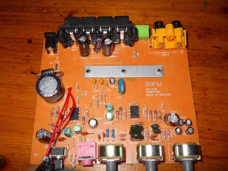

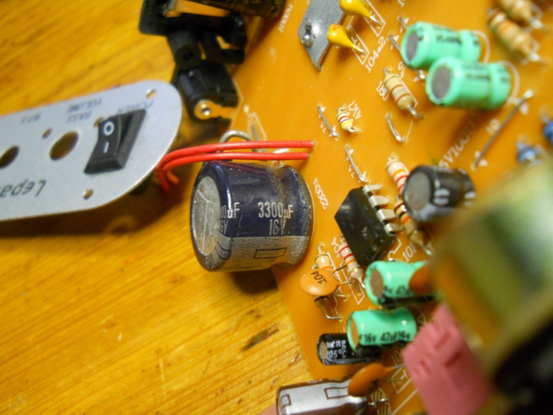

Hi guys,
I have a Lepai which doesn't make any sound :/
The blue LED goes on, but nothing other happens.
He never have made any sound. I tried a few different power supplies, but this seems to be not the problem.
Any suggestions what I can do?

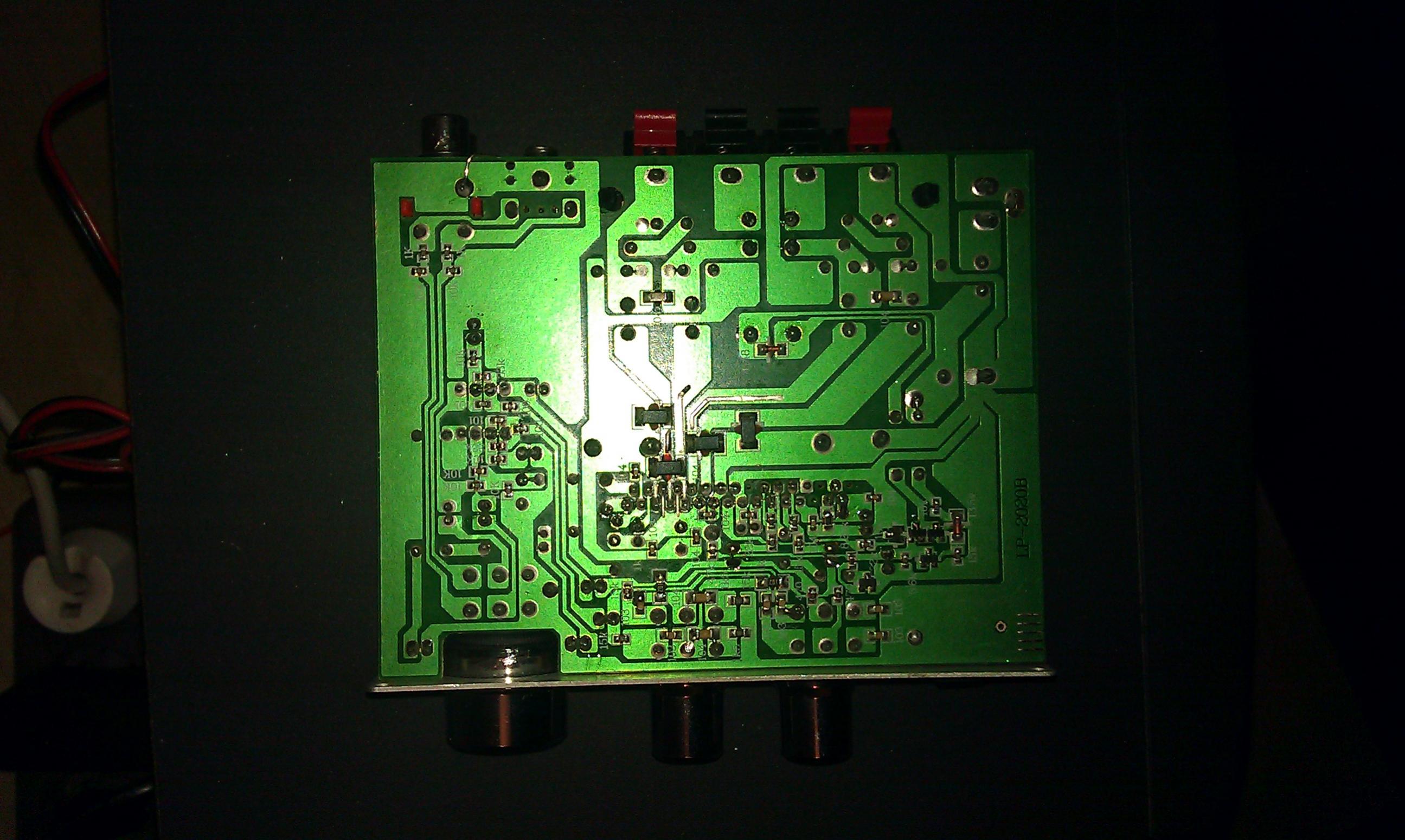

I just took two pics, to show what version I own.

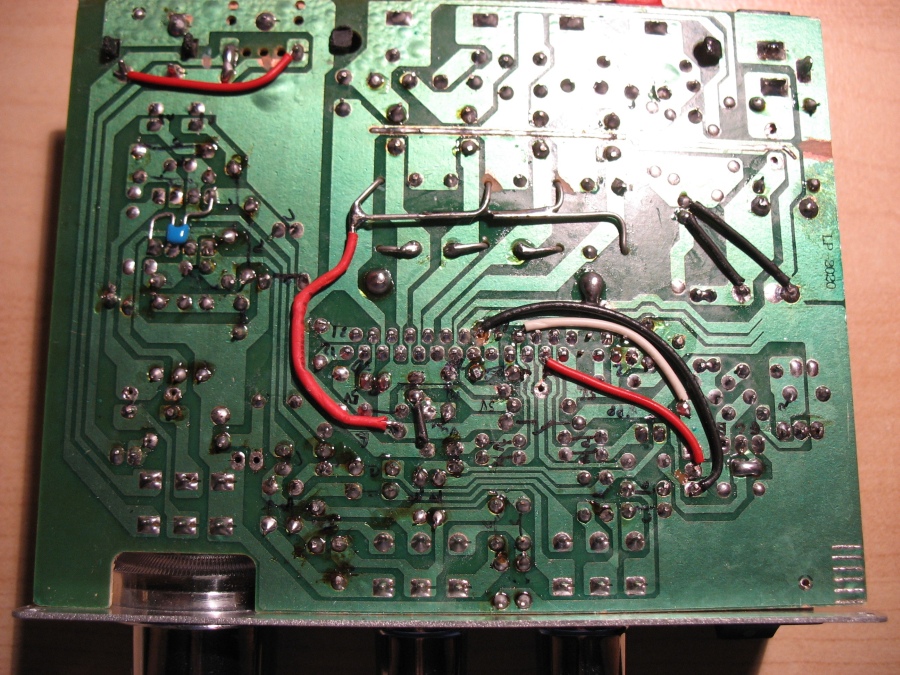

Sorry I haven't kept up with this thread for a while. I did see the requests for the eagle schematic, so here they are.
Also some post modding pics:
This is from from when I started cleaning up the output section. I drilled holes for the 4 protection diodes to fit the heatsink grills.
Almost complete. The only thing I changed after this point were the pots. Those knobs were really hard to remove.
The bottom of the board. Checkout the bubbles on top left corner. That's Lepai quality for you!
I pretty much tested the amp after every change I made. By the end I had changed a few things from my original list. I settled with the opa2134 for the opamp. I like the sound better than the ne5532. I added ferrite beads for both power lines. I swaped C1 and C13, then eventually changed C13 to spare cap I have that's closer to what's on the datasheet. I replaced all the .1uf filter caps with the nicer ceramics I have (didn't really change the sound as far as I can tell).

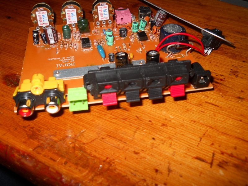

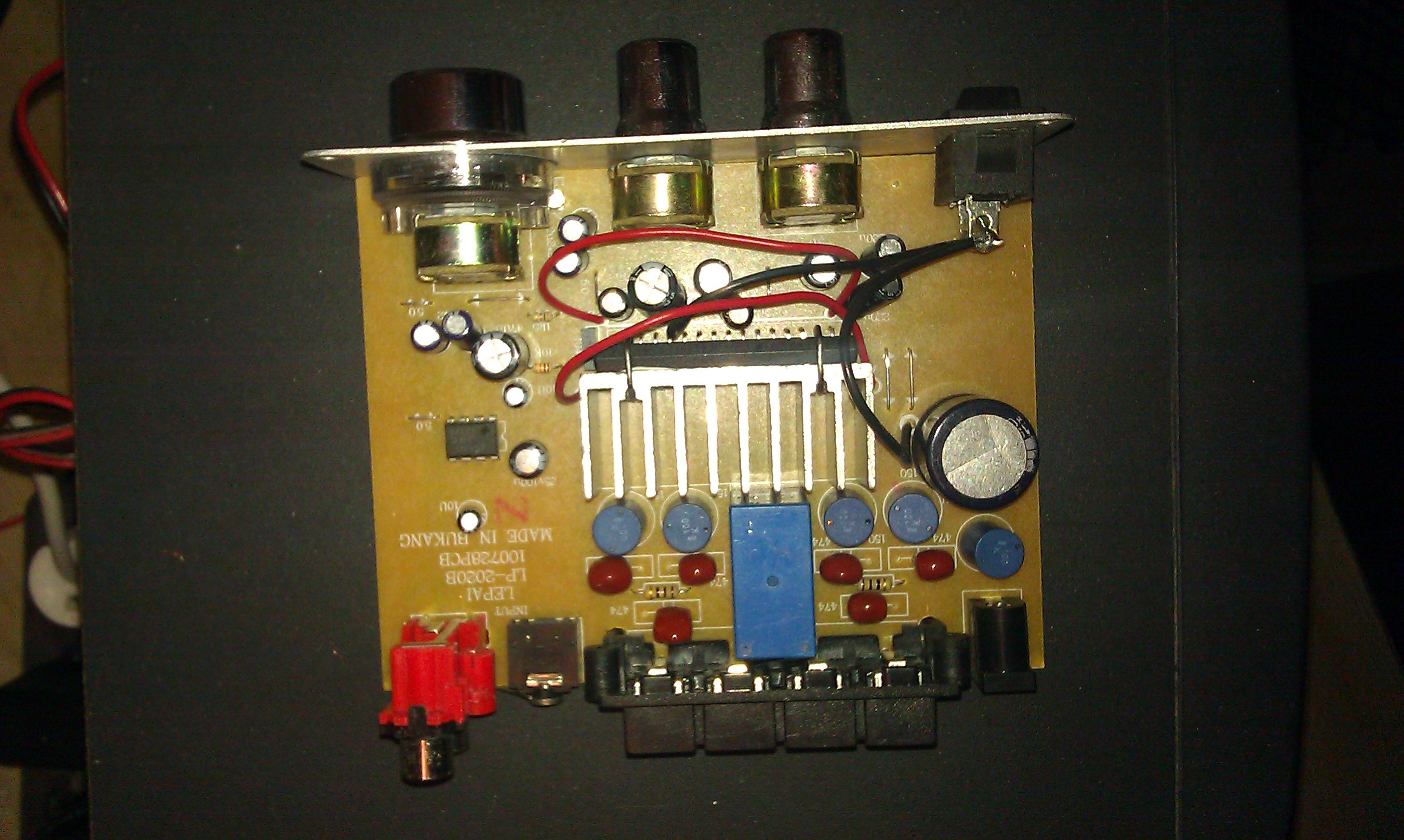

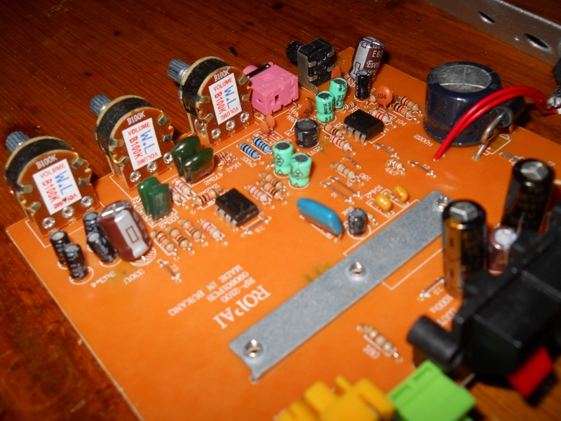

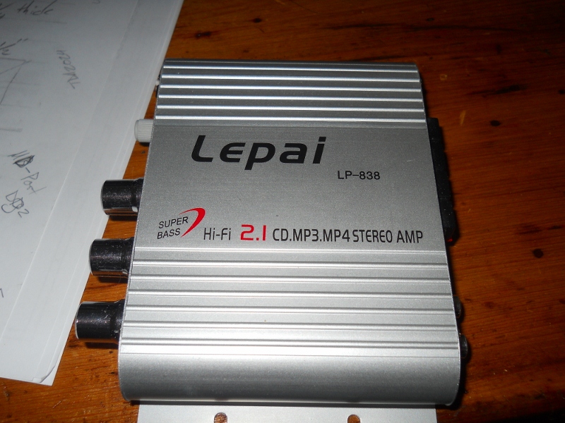

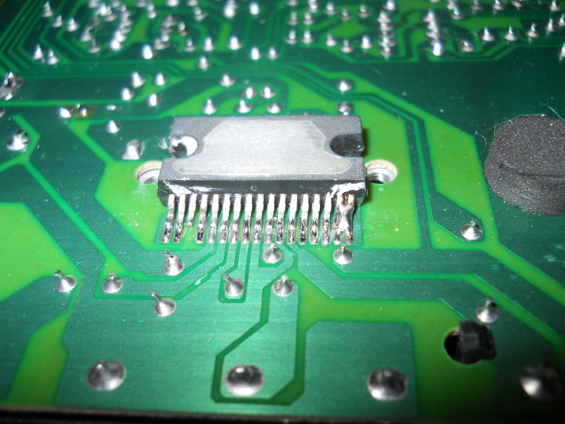

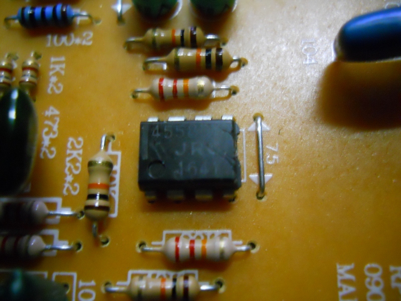

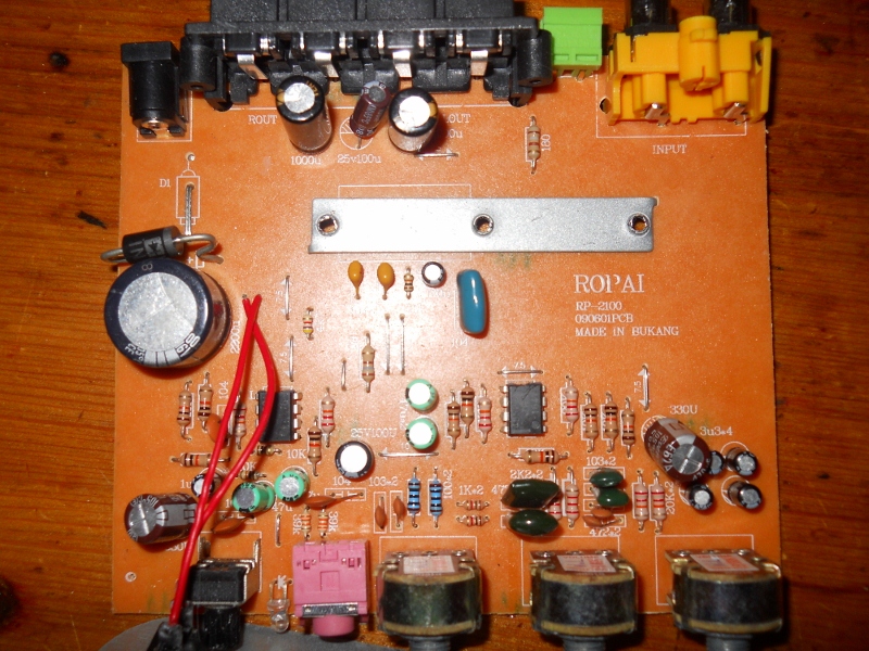

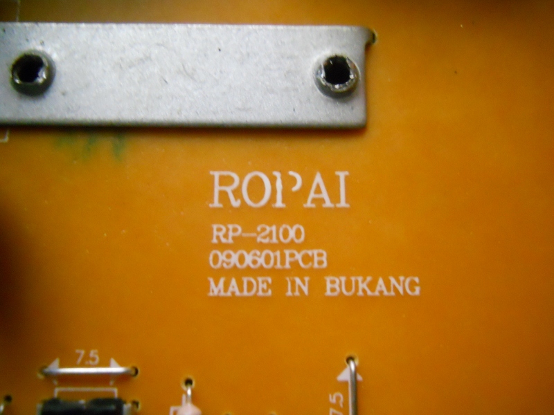

Just wanted to throw some thumbnail pics up.
These are not Lepai TA2020A+ . You model is not using Tripath TA2020
I know that. I didn't realize that this was a TA2020 only thread. If you could point me to the nearest TDA8566 thread, I'd really appreciate it.
