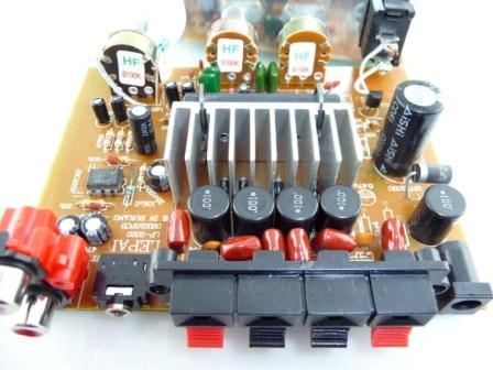

By looking at the pics it looks like (I do not have mine yet) they have put a 14V Zener at the DC inlet, this is a neet idea.
Anyhow, maybe someone can confirm this.

The little amp seems to work as it should. I still haven't had time for much listening. I did remove the op-amp and replace it with a socketed LM4562. I could only hear low-level hiss from my tweeters if I had my ear within an inch or two from them. There was also audible low-level hum (not noticable from more than a foot away) if I touched the case. DC on the output was around 55 mV. There was some turn-off thump but not too bad. The power button does not affect the blue LED....it stays on as long as the power supply is connected.
I also noticed that the two small electrolytics closest to the volume pot appear to be the input caps. Positive goes from input to the pot to the caps. These caps were labeled 2.2uF on the board but 10uF on the caps. Also, a 47uF cap between the opamp and the tripath chip (next to the heatsink) was labeled 100uF on the board.
Overall, it seems to be a great deal. And I like the metal case better than the plastic SI / Dayton amp...

55mV dc offset would be pushing it for a headphone amp but I don't think it's too bad for speakers. Dunno about the cap across the terminals...
The board seems to be attached to the case through the potentiometers only. The hum might be reduced by isolating the pots. I remember the volume pot being grounded to the board by a wire.
If the input caps are 10uF this could be the case of the turn-off thump, depending on the input resistor these could probably be reduced to 2.2uF or 3uF.
The pot could be grounded to eliminate the hum while touuching the case or change the knob for a silver plastic one.
The led is an easy fix, I rather have the led ON when the unit is actually on.
Try to add a small cap across the speaker terminal (tantalum of very small value) this should reduce the hiss from your tweeter.

Thanks for the tip Eric. I'll be interested seeing how you end up modding yours. I wasn't sure if the increased capacitance on the input was advantageous or not.
Some people earlier in the thread seemed to like the sound best after by-passing the op-amp and tone controls.
You can see the wire going from the volume pot case to the board in the attached photo.
This is the only TA2020 based amp that uses an opamp, correct? Does anyone know what purpose it serves?
I'm assuming the opamp is acting as a pre-amp stage of sorts. People have reported better results when using a pre- with their tripath amps. If you already have a nice pre, I would guess bypassing the lepai input stage would result in the best sound.
I'm going more for high-quality portable sound so will probably leave the input section in place.

Tracing the circuit it appears that the 'POWER' switch on the front is not an on/off switch but just mutes the TA2020. That is why the LED stays on when the switch is off. 😕 😕 Think I will rewire it to turn off the supply instead.
There is also a circuit that mutes the TA2020 if the input (supply) voltage is >14v. This is what the 14v Zener is for. The max voltage for this chip being 16v. This is going to make it difficult to use in a car as the battery charging voltage can reach over 14v. It confused me until I traced out the circuit
The op amp is used as a preamp after the volume control with a gain of about 5 - presumably to compensate somewhat for the loss in the tone controls - about 20dB or some 10x.

1. Get rid of build-in op-amp right away. Swap it out with something decent like LM4562. This will unleash full potential of TA2020. I guarantee you will be amazed with the result.
2. Tone controls are a bit tricky. Even a little manipulation changes sound signature completely. It takes some time to find an ideal position. I am thinking about bypassing them completely in order to improve sound even further (can't imagine how this device can sounds better).
