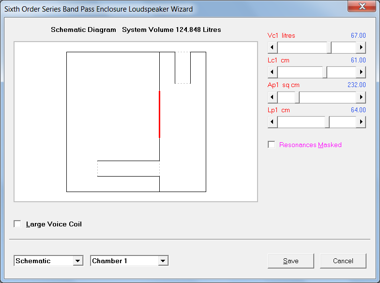

Hi. I am trying to put series 6th order bandpass in Leonard TL, and can't figure aut how to do it. I can't figure way to feed both port and driver to next chamber. Parralel bandpass is very easy, but this giving me headaches 😕

I, see that no one knows. Or maybe it is imposible. Then maybe someone knows some software that would run on Windows 7 or 10, which could be used to design series 6th bandpass? Please help I am really stuck 😕
Well first off patience would be necessary. It's 1:15am here and my son just woke me up screaming. He's settled down now, but now I'm awake. Uggg Let me see what can be done. Never tried to design a 6th order bandpass with this software, it is for Transmission Line design, but may be possible. Give me a few.
You can use Hornresp to do it. Forum thread : http://www.diyaudio.com/forums/subwoofers/119854-hornresp.html

I am assuming you wish to build :
If so it cannot be done with LATL

To do properly it must be exactly spot on and I personally would not trust LATL to model it from. These are typically used in car audio competition were only SPL matters and only work for a very narrow range of frequencies.
It took me ~10minutes to rough in the dual reflex bandpass type. Tweaked a bit and did not like what I saw. Tweaked it a bit more, but stopped there. I wouldn't build such a beast today, tho have in the past >25 years ago for another person. They do not exhibit what I would call fidelity and definitely not a box for a beginner to design.
Please read this on the subject... Subwoofer Enclosures, Sixth and Eigth Order/Bass Reflex and Bandpass
