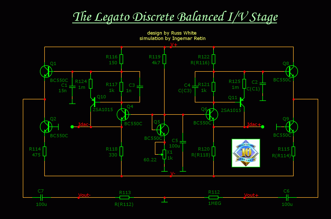

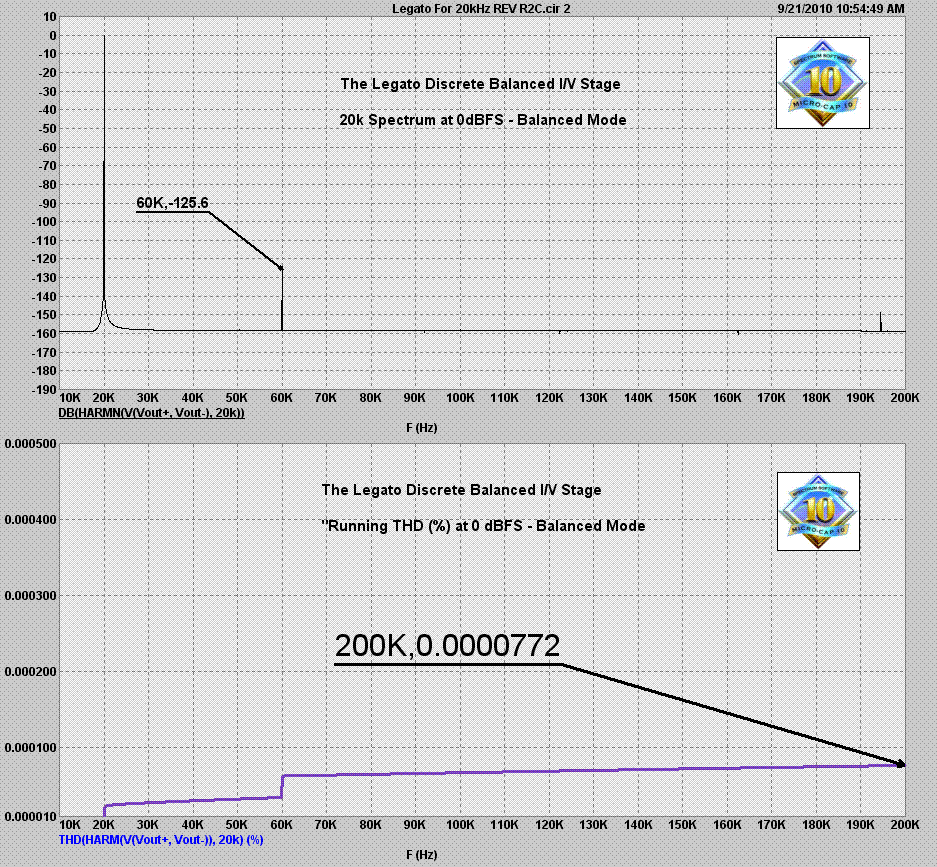

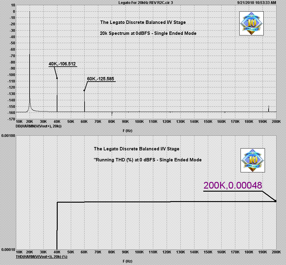

I thought I'd try how the Legato simulates with only BJT semiconductors (no MOSFET, thus), so I fired up MicroCap 10, and did some long-runtime
20 kHz spectra simulations.
THD in both SE and balanced mode is amazingly low at 20 kHz.
Attached are the schmeatics I used, and the balanced and SE mode spectra and total THD summed to the 10th harmonics.
Enjoy!
Ingemar
Hi Spartacus,
The best I can do is tell you how it simulates and sounds right now. The THD is amazingly low for having no feedback.
Here is the simulated FFT at 20khz it only gets better as the frequency gets lower.
Cheers!
Russ

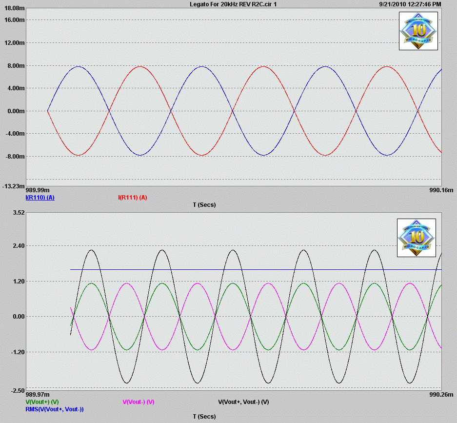

Maybe somone is interested in seeing how the input currents look like and how the output voltages look like. If so, see attachment.
/IR
