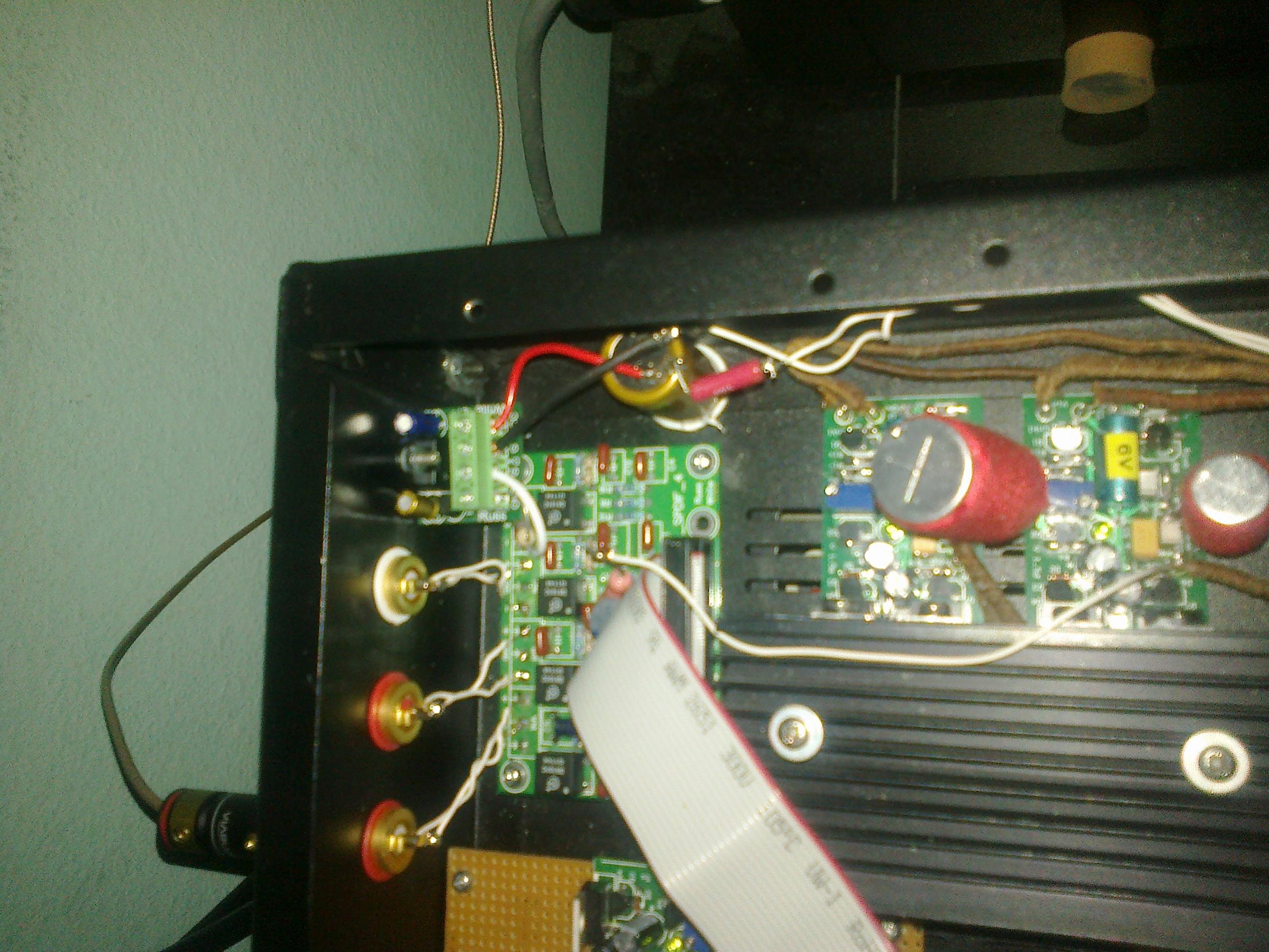

Toslink problem with Buffalo
Sorry for posting it here. I could not find the Buffalo tread. On your support side I can not post pictures like this. The toslink make the lock led flashing. I use the 270 series resistor and 100 ohm parrallel. Will it make the difference with 75 ohm ? Or do I have to change anything else ?
Reduce the size of the picture and post it on the support forum please.

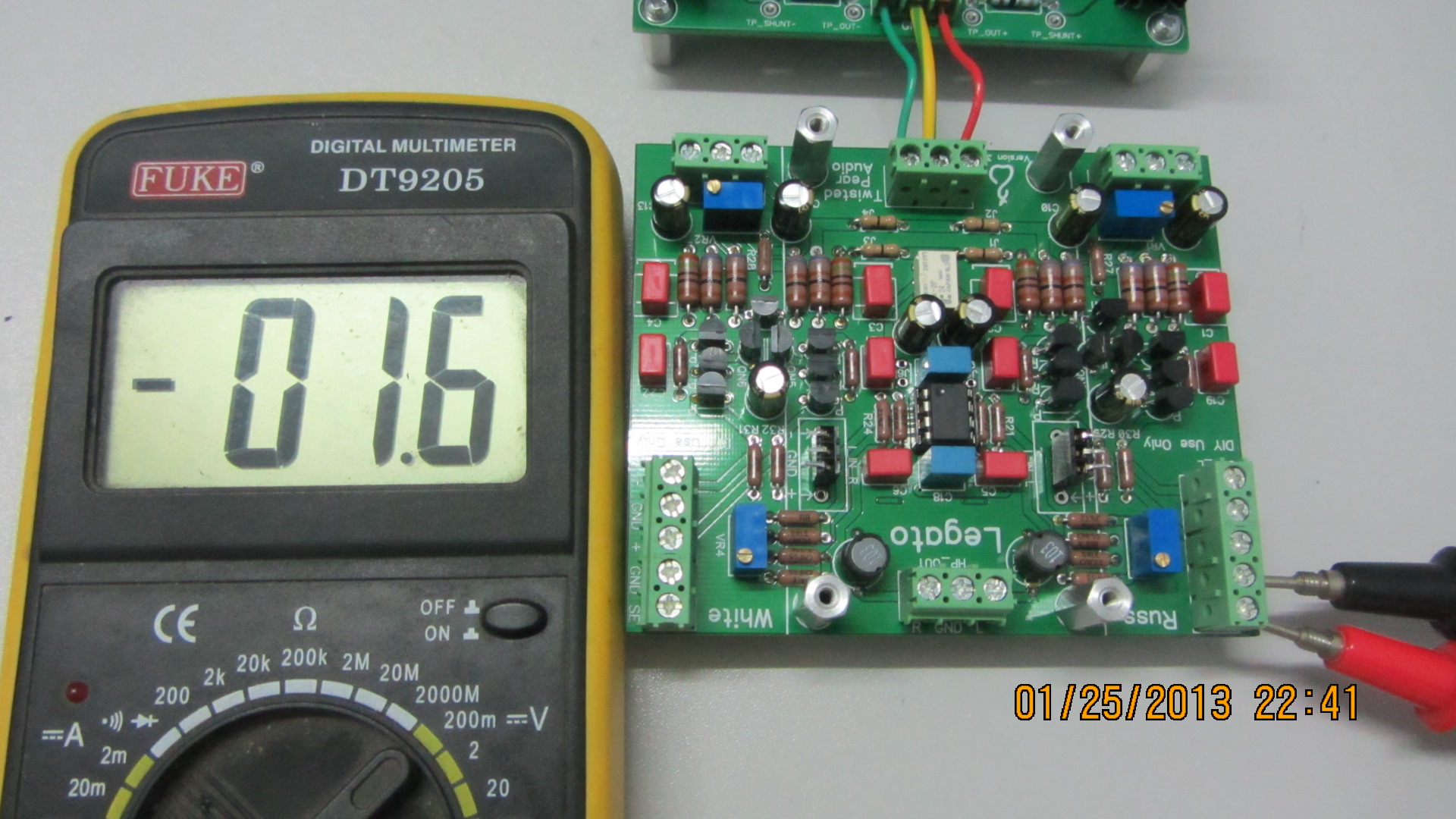

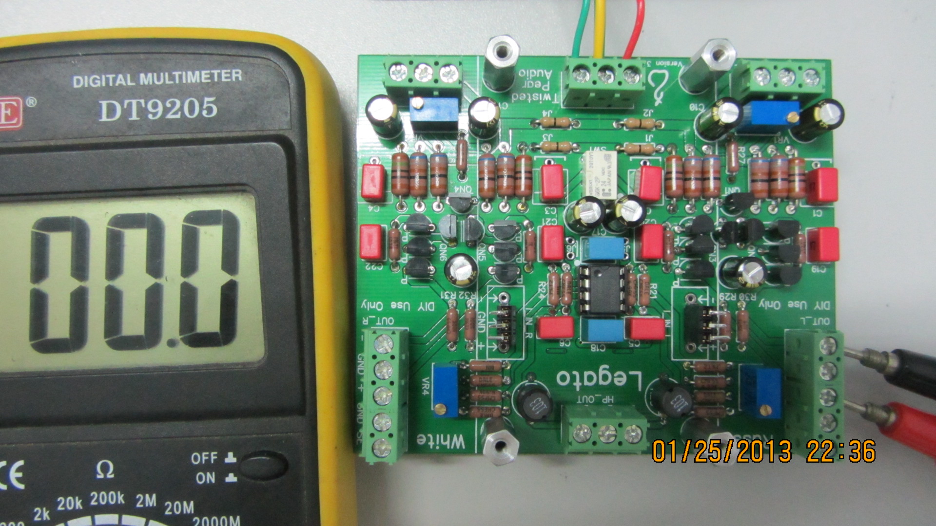

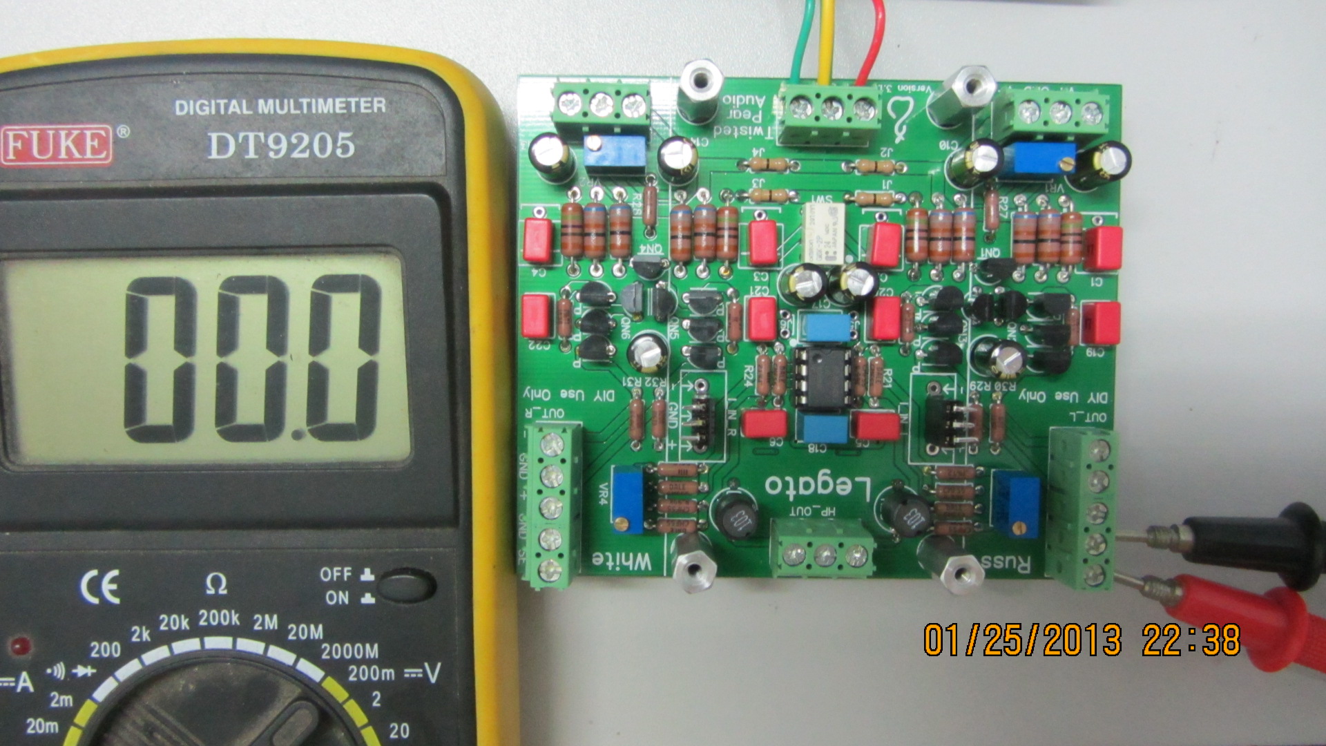

Thanks for your reply ,
I think it is time warm up of Mosfet and Transistor ?.
I measured all out put is 0V with 200mV DC meter, then I off/on power,the output about 8mV and measured -1.6mV in 5 minute later .
It is normal ? .Can I connect direct to tube pre-amplifier ? .

It really depends on the amp.
BTW when measured like that the inputs are floating. Which will effect things.
This is why you need to measure again once the DAC is conneted.
If the few mv of warm-up offset is too much your amp then use AC coupling caps.

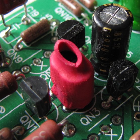

One other note - the main pair of NPN (QN5 QN6 etc) can be thermally coupled. This should significantly reduce any such drift.
I do this by gluing them together or using heat-shrink tubing etc.
One picture = 1000' of words.
This if from an earlier Legato but the picture is principal.
