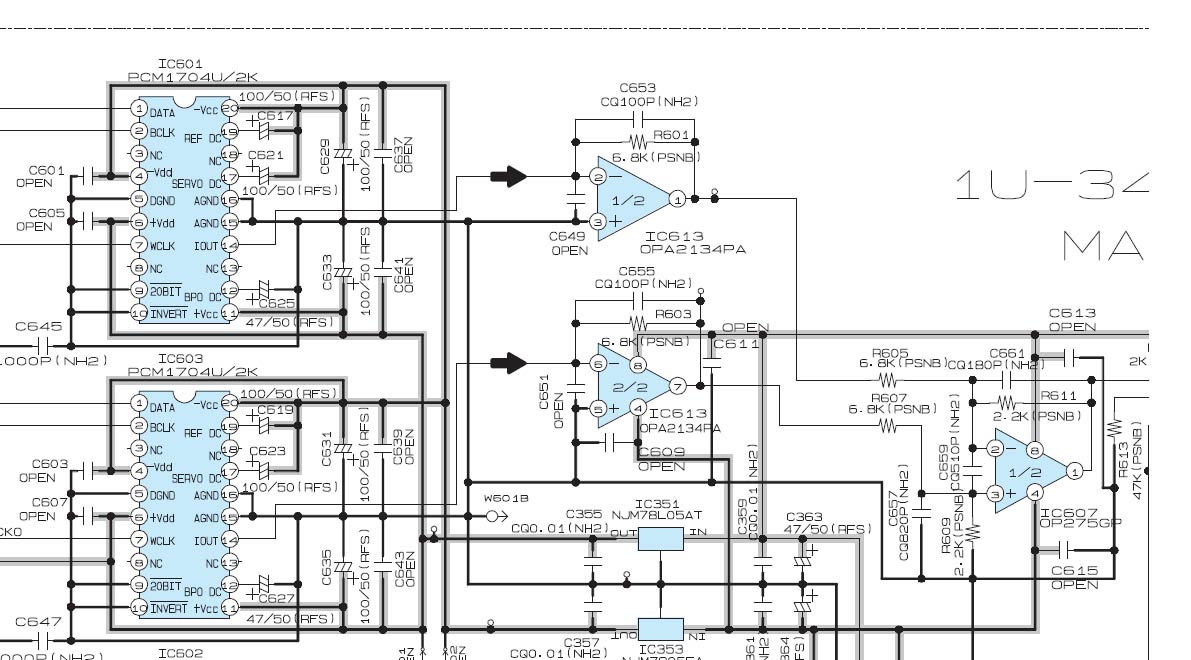

Legato 3.1 with dual differential 1704's?
Hi Russ / Brian,
1. Can I use Legato 3.1 for I/V with dual differential 1704 DAC’s (photo attached)? Single 1704 has nominal current-out swing of + and – 1.2mA. Zout of 1Kohm.
2. Will I have enough gain out of Legato 3.1 with such a low current-out level from 1704’s?
3. I am planning on using SE output on Legato 3.1 Do I have to use the outputs from IC2 and IC3 (headphones’) buffers, or can I try the output from pin 1 and pin 7 of IC1? What would be the difference?
Thank you,
Boky

I had a chance to quickly check the Legato 3.1 specs today.... I see there's "no buffer" option, where the 3.1 uses buffer in the feedback loop……. so that answers my question 3.
I use AD8066 as 1704 I/V - am trying to keep input offset voltage and input current errors as low as possible, followed with transformer for balanced to single ended conversion. Altogether an excellent result…. but one that depends too much on interconnects type / length / pre-amp impedance.
Could someone please tell me if Legato can provide low AND constant offset voltage, and low AND constant bias current to the preceding current-out DAC???
I have searched the threads on Legato and I must say that I am surprised that no one has expressed their concern about Legato [voltage offset + input bias current] errors vs. LSB values of sabre DAC….. maybe people are not interested in low level resolution anymore?

That is a completely silly thing to say for someone looking for help. I am having a hard time following you. If you claim to understand as much as you seem think you do why exactly are you asking for help? 😉
The ES9018 does not work like other current output DACs, The critical factor is bias modulation at the output. The voltage at the outputs needs to stay as constant as possible. Thus the importance of extremely low input impedance.
To answer your earlier questions. I have no interest in that DAC, so you are on your own. Give it a go. If you do you should be able to simply adjust the gain of the BAL/SE stage. Simple enough if you understand the schematic.
If you don't like the idea of the Legato then do us all a favor and by all means don't try to use it. 🙂
