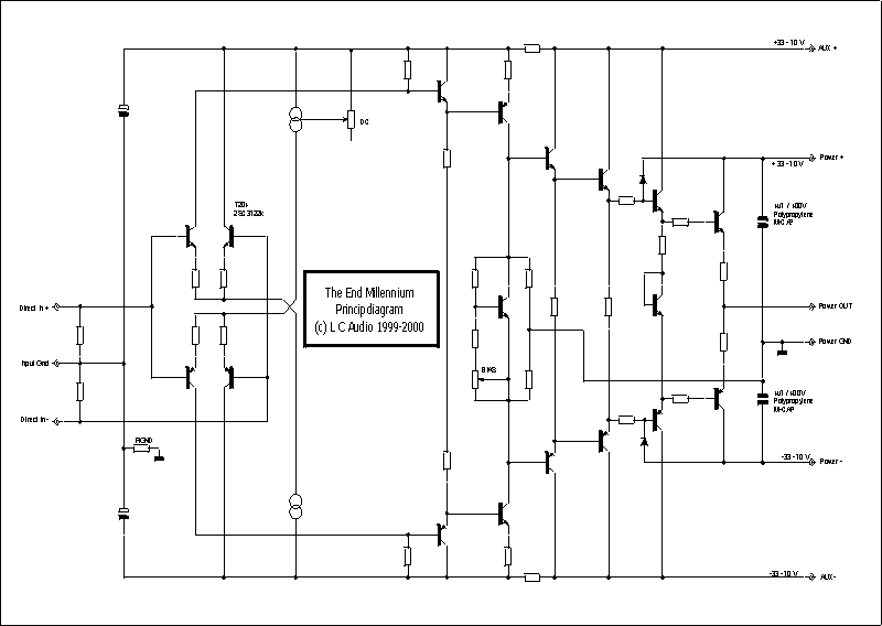

Dear Russ,
in the schematic of the type below (principle) referring to LC Audio Millennium XP (found on the net, www.lcaudio.com):
1. is it possible to link Legato 3.1 Balanced without coupling capacitor?
2. in case it is, floating (2 poles + - ) or with ground (3 poles)?
Thank you in advance!

You should have no problems using Legato w/o caps with that design. Simply connect + and -, but leave GND floating.
