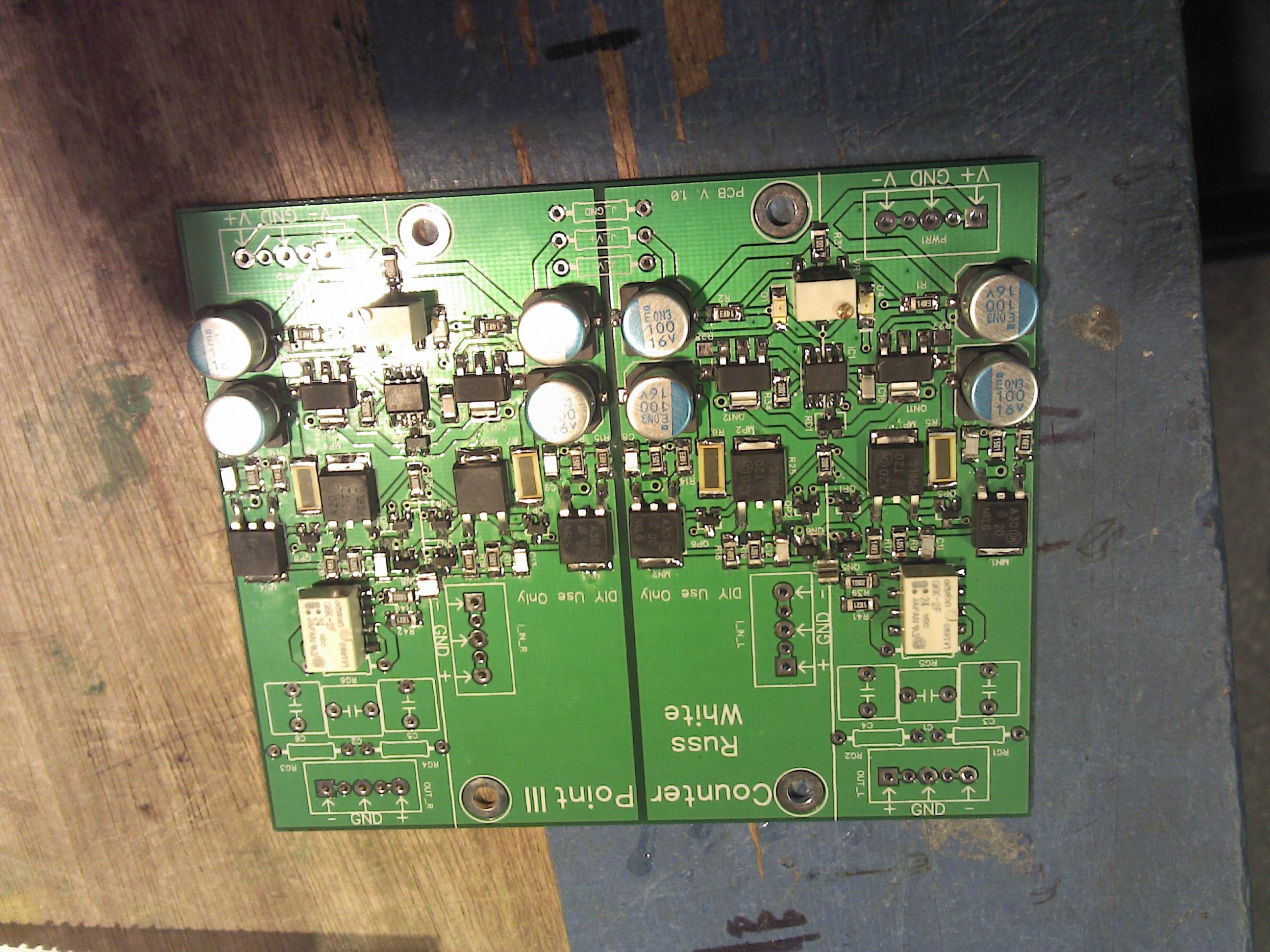

It's far more like Legato than IVY-III. In fact it has almost nothing in common with IVY-III except that it converts current to voltage. 🙂
It has no global feedback - just a servo that sets the cascode current to get the common mode voltage to 0V.
It is also right now just an experiment.
Here is a sneak peek of the last proto. Be warned though, it is going to look quite a bit different with the new parts. 🙂

Now you have my attention! Relatively simple circuit with no global feedback, but with a servo. Too bad I just purchased a L3 kit... One can never have too many output stages to try though 😀, thanks for creating another interesting option.
Oh don't worry! I don't see this as better than Legato 3 - only different.
It is not in any way ready to replace Legato 3.1 in fact there is a lot to recommend the Legato 3.1 approach - for one it is much simpler and cheaper.
I see Legato 3.1 as some of my best work. I personally have it in my current reference system. It is not going anywhere either. 😎
In any case - counterpoint III not even close to finished yet. I just wanted to give a little window into the workshop. 🙂
Yes that's a good point Brian!
it has some rather "not-cheap" (precision voltage divider - big thin film resistors - etc) parts. 🙂
In testing I found some mild - but undesirable thermal characteristics which I will resolve with sets of dual (and maybe quad - but not likely) transistors. That will also probably add a bit to the cost.

One of the really critical design elements of the Legato 3.1 is it's simplicity. That is one of the reasons why it is so special. It is very much like the D1 in that regard (with the same need to AC couple in some cases) except that instead of a FET it uses a hybrid CFP based approach with paralleled devices.
Legato 3.1 adds some nice touches like nulling both balanced and SE offset and BAL/SE conversion and buffering. I would say it is one of our most popular modules, and for very good reason. We leave it up to the builder to choose the coupling path best suited to their system. For some DC coupling is optimal (any truly fully differential amp), for others AC coupling is ideal - via caps or via transformer. This is an age old design choice - and many superb audio stages have employed both forms of AC coupling.
